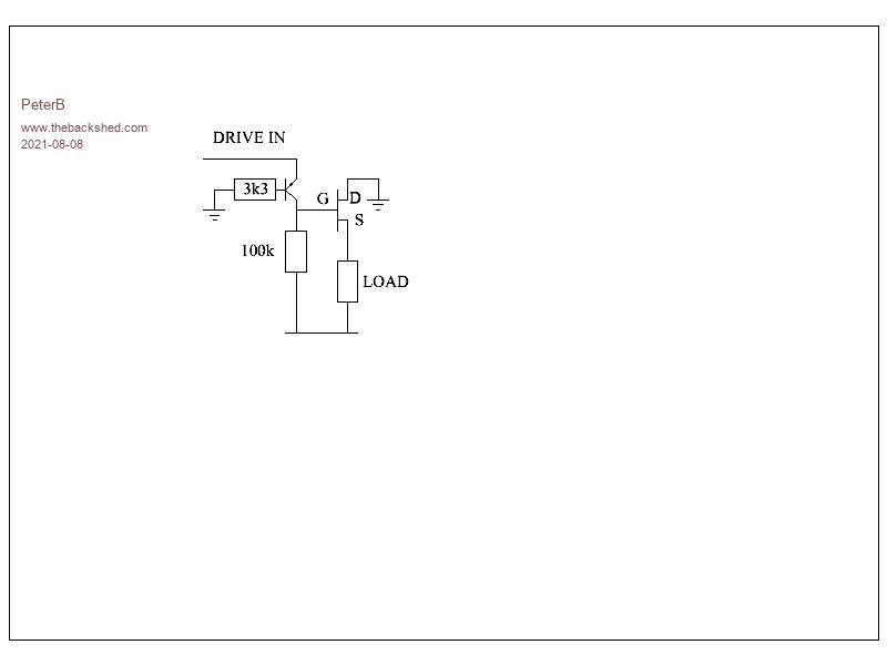

How about this? unfortunately I left -28V off the bottom rail.

That would work for an opposite FET and the ARDUINO would be connected to GND and -5V and you want the load connected to GND.
My cct will work (I hope) but it does mean having a +5V rail for the ARDUINO and a -28V rail for your LEDs. Having two rails is good for noise. Do you have a problem with using a -28V rail? No 10k needed. Would you like a run-down on how it works?
I think it should cost about 25c.
Peter
(my schematics are nicer than yours)

No good. Remember the LEDs are common cathode. That has to be grounded or at -28v. A high side driver is necessary.

The entire cct could be moved up 28V so that the ARDUINO is between +28V and +33V. You then have a high side driver.
Er, I think.
Peter

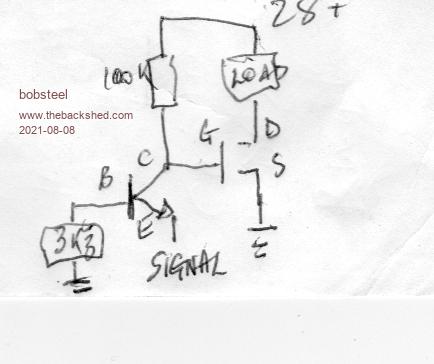

  Mixtel90 said  No good. Remember the LEDs are common cathode. That has to be grounded or at -28v. A high side driver is necessary.
No I dont agree with that either. It can be high or low as long as the current flows pos to negative through the load lights . I have found that in my trials but getting a clean off seems to be causing the problems hence the bootstrap circuit I used but which inverts the signal so its on when it should be off but its a nice clean on and off.
In light of the comments on power useage being the same on high and low I am going to try inverting the arduino code and that might be an end of it.
If I can follow PeterB's circuit Ill try that too.
Its just getting confusing here now and I need to get something operational.
Thanks to all though!
Edited 2021-08-08 19:03 by bob.steel

My latest (and greatest) can be configured for high or low input it matters not.
You do seem a bit worried about blowing up your ARDUINO so 2 questions,
which ARDUINO are you using
Are you anywhere near OZ. If you are I can send you some mini pro's which would do for testing.
I am confident that my cct. will work but I wish other people would confirm it.
Peter

Apparently the LEDs are common cathode. It doesn't matter how you label the supply voltages, the cathode of the LEDs has to be the most negative. You are feeding positive into the anodes independently in order to light them. Therefore it *has* to be a high side driver. There's no other possible arrangement.
You can feed from 0v to -28v or from +28v to 0v but it's *always* from the high side (most positive) to the low side (most negative). Either way you get the anode of the LED at 28v positive to its cathode to light it.
The sketch that you just posted, Bob, should work fine, but will only drive a single LED. It's no use for common cathode LEDs as you can only connect one. I'm not sure what you are showing with the transistor base, but it should be a resistor to +5v. With SIGNAL high the transistor is off and the mosfet is on.
Interesting arrangement, PeterB. :) The supply *has* to be -28v relative to GND and the arduino supply +5v to GND. It should work, I think... you are getting the gate 5v above the drain to switch it on. The DRIVE in input is "right way up" too. I like it. :)  You can't invert this design with the mosfets you have, Bob.

PeterB's circuit would use an *isolated* 5v dc/dc converter with it's -ve connected to the mosfet drain. The arduino would then be powered on that 5v supply. You can think of the LED cathodes being at -28v if you like, or you can think of the arduino being floated at 28v above 0v. :)

If you start by imagining a 5Volt battery connected in series with a 28Volt battery giving 33Volts end to end.
we can designate any point as ground so we can have +28V & -5V or -28V & +5V or +28V & +33V, it just depend on what we call ground. And that ground is just a local ground. If the 28V battery is a generator or a mains supply or pins in a lemon it can have its own ground. The main point is that we can have our own local ground which could be a Mega volt above some other point, so long as multiple different grounds are not connected. The idea of calling them ground is misleading but that's how it is.
So if you have 2 wires with 28V between them you have a -28V supply. It doesn't matter if that -28V wire is connected to the chassis of a generator and the other wire is red and has a +28V label, as far as our local circuit cares, we have -28V.
The problem is however, given the big range of supplies you have to use, how to generate that +5V supply without spending money. It really does look like the VOM1271 is a good idea.
To understand my circuit you have to stand on your head. PNP transistors need a -ve rail and so are drawn upside down. With the base connected via a 3k3 to GND. pulling the emitter up to +5V will turn the thing on and its collector will go to +5V. Dropping the emitter to GND turns the thing off and it collector will fall to -28V.
In the early days of transistors they were all PNP (OC71) and there were people standing on their heads all over the place.
