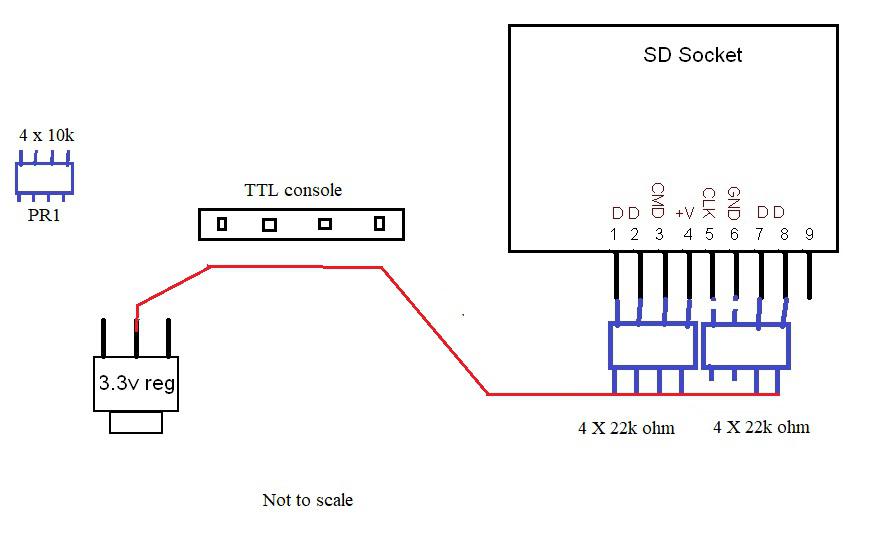

I am with TassyJim in that I do not want to spend $$ and much time trying to get to the bottom of this.
Much of the information is on the internet (al be it that not everything may be true).
But this is true:
The SD card operation (data transfer) does not require pullups. In every phase of the transfer the lines are push-pull operated. This is not like I2C, where the pullup resistor has a actual function.
The pullup resistors only have a function in transitions (while the software stack initializes IO pins), during insertion and extraction of the card, and during power up of the system. As such the values CAN (not saying MUST) relate to software (expecting logical stable levels at such and such moment).
The pullup resistors should ensure logic high level. Therefore there will be a limitation in value due to humidity, leakage (input impedance) of pins.
The boards we are refering to are probably designed by ST as demonstrator, before several chinees manufacturers made their derivatives. Designers of development boards know that these are used to develop software on. They typically do everything in their ability to make SW development smooth (i.e. they provide drivers), but also design the hardware so it is more or less monkey-proof. As such they may have decided to add a 10k pullup in the design. Even if the software activates the pullDOWN resistor, the SD card interface will still work.
Finally: about SD card itself.
On the Parallax forum someone measured several different SD cards, and found internal pullup resistors in the cards ranging from 20k ohm to 100k ohm (different brands, different memory sizes). Since the measurement method was not shown, this may not be 100% correct, but differences between cards will be possible.
In my opinion adding resistors as pullups (in parallel to matherp's activation of the internal pullups in the F407) makes only sense when the whole unit is powered up. This prevents "floating signals" until the moment software takes the reign.
Long story...
Posts: 3430
Posted: 07:47am 19 Mar 2021
To Andrew_G,
Unfortunately I didn't take a photo. When Peter released that update and Goc30 found it worked I lifted the +3.3V bridge and tried it myself. It worked so well with my SD cards I removed the resistors. Tomorrow I will draw it in Paint and post it.
Before the mods the SD card that had fewest problems was a Kingston 32GB, $11 at the local post office. (AustraliaPost - it's hard to guess where anyone lives, except TassyJim ;)

Posts: 3430
Posted: 12:01am 20 Mar 2021
To Andrew_G,
Glad that is sorted. Peters wizardry works wonders.
It's now redundant, but I thought of an easier option. On the V33 board 4 pullups for the Debug Interface are in an SMD DIL package. Two of them in a size that matches the SD socket pin spacing would have been much easier. It would just require clipping off the unneeded pins. A bit of hotmelt glue would keep it all in place.
