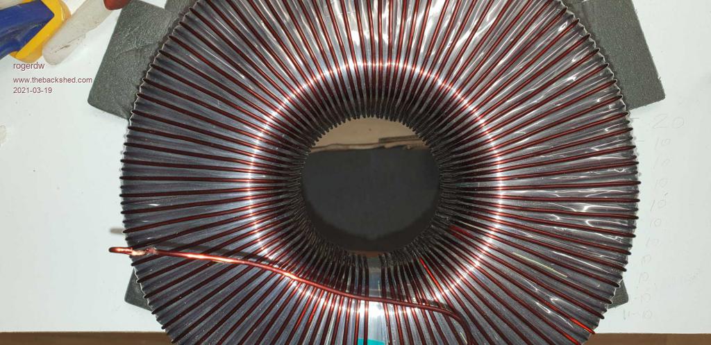

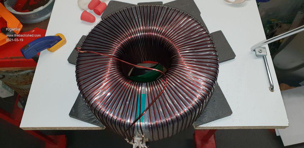

I mentioned in an earlier thread that the toroid can theoretically be wound without the wire physically touching another winding at any stage of the assembly  ...  which may sound like a pretty bold statement.
And while mine has turned out pretty neat, it would have a few adjacent wires in the centre of the hole that do touch  ...  though if I was super concerned I could spend a bit more time to space them more carefully so they do not touch.
Maybe I could wind a thick piece of fishing line between the wires to fill the gap and keep them apart.
This picture shows the spacing of the wires through the centre.

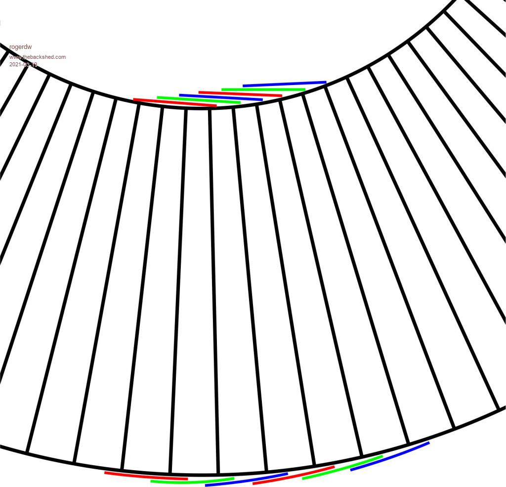

I also mentioned earlier about the mylar taking up a lot of volume, particularly inside the hole.
Just to get a half overlap around the outside, actually creates four layers around the inside  ...  see pix
Cheers,  Roger
Posted: 08:49pm 19 Mar 2021
Don't stress yourself Roger, there is only a volt or so difference between alternate turns, and the insulation on the wire is really excellent stuff.
The thick winding will go on easily.  The circles within circles software assumes rigid perfect mathematically correct circles.
The very fine multistranded wire with thermoplastic insulation is quite soft and easily deformable. If you put it in a vice, you can squash it flat fairly easily.
So where one turn touches another, the wire can deform slightly and the whole mess can be squeezed into a slightly smaller space than theoretically necessary. So if the software says it will fit, it will all fit on easily with space to spare for a big central mounting bolt.

I had noticed in looking at the display of circles inside a circle that they make no great effort to space them optimally.
They place a full circle around the outside and then another inside that  ...  but make no effort to place the second lot into the grooves between the outer windings. I'm sure that would allow another turn or two if desperate.
I just tried using a graphics program to place that second layer into the grooves  ...  but you can only get 2 or three per layer to actually go in the groove because of the smaller diameter  ...  so I only managed to fit one extra circle.

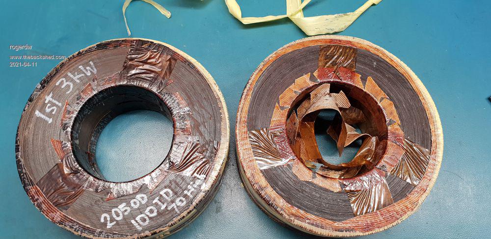

I've wound the first winding for each of the transformers #2, #3 and #4 and am starting on the big daddy #1.
I have two larger 3kW cores stripped and ready to work on. I plan remove at least 20mm from the centre  ...  from 100mm ID to 120mm to allow a 5mm spacer between the core and the secondary winding  ...  and allow my substantial secondary windings to fit.
The secondary will be six layers of 1.8mm wire and I have a large roll of new wire to use, which will make a change from all the crinkly secondhand stuff I used on all the rest.
I also plan to use material from two more toroids to add to the outside of the 3kW cores.
There's been a bit of a holdup as I built a spot welder to use to tack the core material beginning and end to keep them nice and tight.
The first one I built from a microwave oven transformer by cutting out the secondary winding and fitting a low voltage one.
It simply did not have enough power so I've bought a small arc welder, stripped the secondary off that tx and wound a new one. Looks pretty gutsy and I expect it to work ok but I haven't quite finished it yet.
In the meantime, some photos  ...

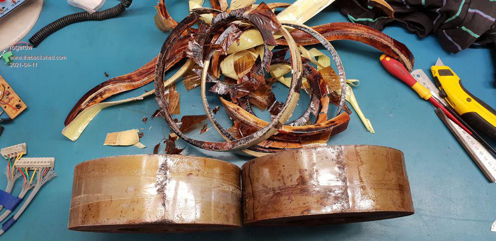

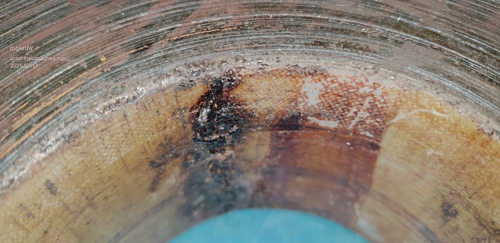

First is of the two 3kW cores  ...  and then of all the fibreglass binding material they used to insulate the corners etc.
The cores are really rough and both look like they were stored out in the weather before they were originally wound. Quite rusty and even bumps and scrapes on the edges which should have been dealt with before winding.

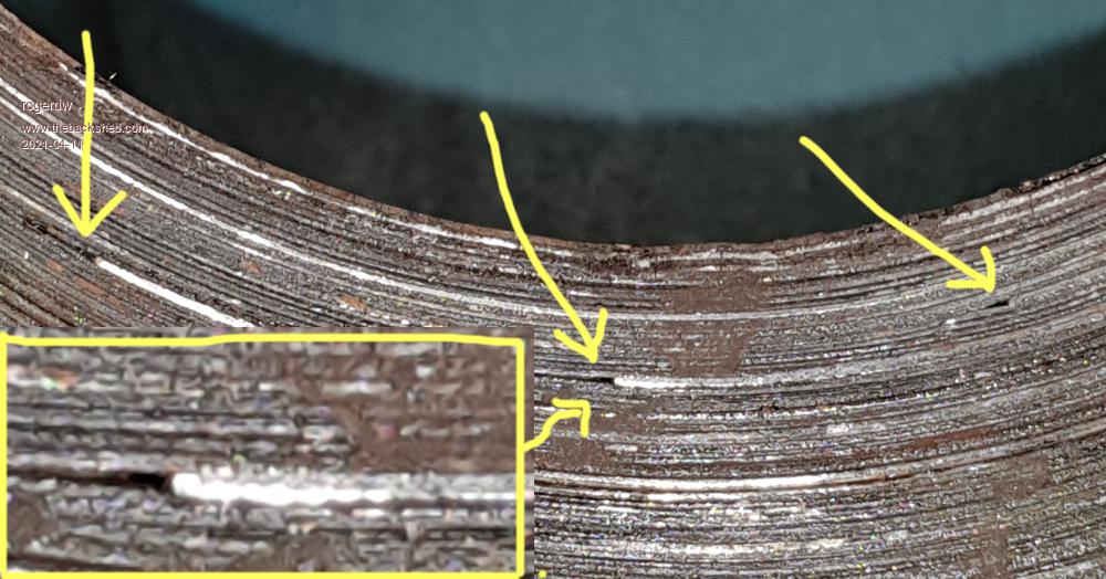

This is not very clear but it is of the welding of the inner part of the core. It actually feels worse than it looks  ...  and it looks bad enough. It's like someone dropped the handpiece in there and the thing arced and sparked around burning and melting everywhere. It's a mess.
This shot shows that the core is not continuous!!! There are dozens of joins in the whole thing. Here you can see three  ...  but there are lots more everywhere.
I recall seeing a youtube video of someone winding a core on a hand operated device and adding short lengths of core material all willy nilly  ...  somewhere in SE Asia. I think he was the guy who made these.
I'm keen to see how the other brand of transformer core is put together but haven't stripped the final layer of mylar off them yet.

You just need to energise the core with a few turns to reach the desired flux density you wish to test at, and the Va required will be the same regardless of the number of turns on the final windings.
Only difficulty is that without first stripping the transformer, there is no real way to measure the core cross sectional area, and that area is the basis of all the design equations regarding the core.
Strictly speaking, core "loss" is only the resistive in phase component of the current which generates heat directly into the core material through hysteresis and eddy current effects.
There is also an inductive component (Xl) which generates an out of phase current.  Higher inductance reduces that part of the idling current. Better steel has a higher permiability than junk steel, and more inductance per turn as a result.
Its more common to lump the whole lot together as idling Va's, its much easier to measure anyway. So the lower the idling power the more power efficient an inverter will be at low loading.
rogerdw
Joined: 22/10/2019
Posts: 957
Posted: 07:01am 12 Apr 2021
Oaky, I've done the test.
Wound both with 20 turns.
#1Tx is the rough looking Hefei ECU-Tamura
CSArea of 37.1 sq/cm
16.47V RMS gives a result of 1 Tesla on the calculator.
.8235V/Turn
Fed winding with 16.47V RMS and showed reading of .47A
Am I correct in saying that VA = 7.74 ?
#2Tx is the much better looking Eaglerise Electric toroid
CSArea of 35 sq/cm
15.54V RMS gives a result of 1 Tesla on the calculator.
.777V/Turn
Fed winding with 15.54V RMS and showed reading of .36A
VA = 5.59
Cheers,  Roger
Posted: 07:20am 12 Apr 2021
That is an excellent result Roger.
Full speed ahead on the rewind....
