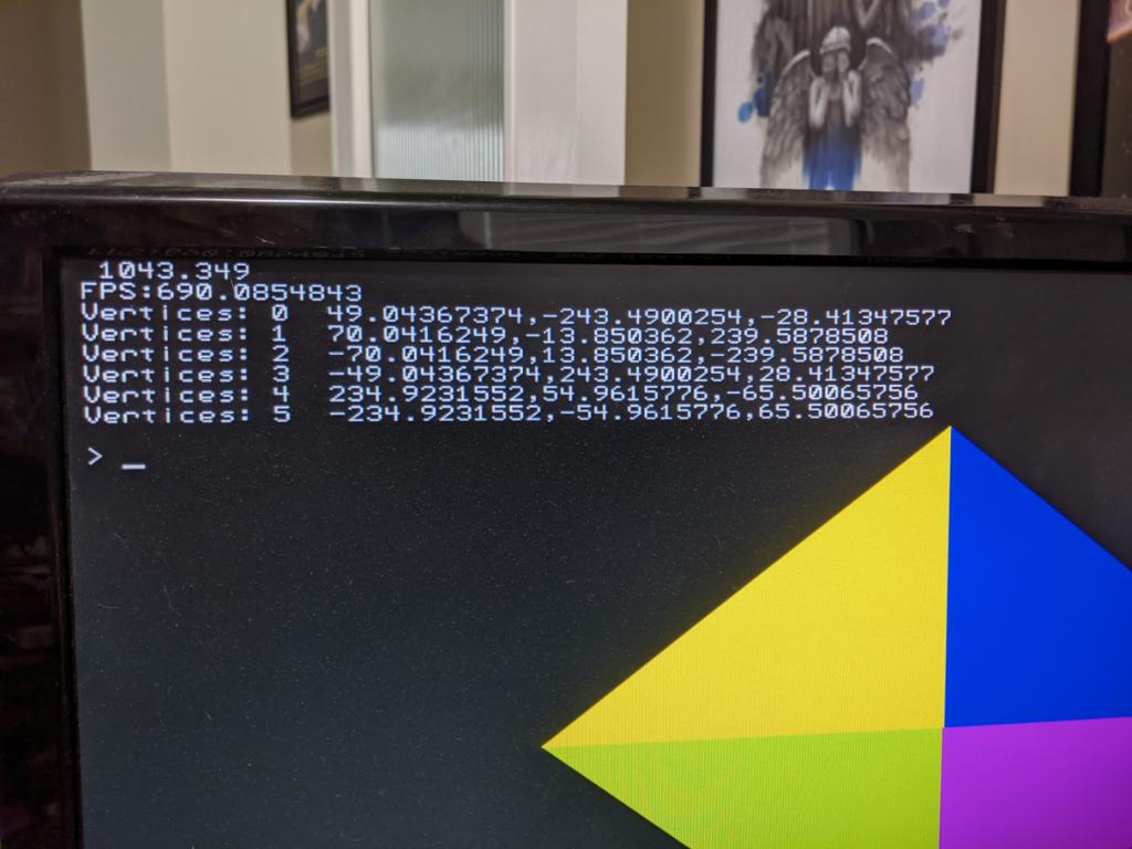

PeteCotton
Joined: 13/08/2020
Posts: 669
Posted: 09:11pm 14 Nov 2020
  vegipete said
  PeteCotton said  I'm at 1043ms (on a 480mhz), so you have well and truely trounced my time   Brilliant work.
Don't be too amazed yet. Peter might just disqualify me for 'cheating' because of some of the loop unrolling I've done. Optimizing for speed and optimizing for size are usually opposite. I've gone deep into the fast and long end of things. For example, my iteration loop contains 69 lines of code/statements.
Btw, could you check which iteration you are printing the vertex coordinates for? Are you saving them at the top of the loop or the bottom?
It's still an amazing feat. I suspect even without the loop unrolling you would still have me beat hands down.
As for the iteration for the vertex co-ordinates, I'm not sure i understand the question?
I start at 0 and run to 719. I take the vertex calcs for iterain #649 (i.e. the 650th based on the zero based loop) - after I have applied the transform. I'm not sure if that's what you are asking?

PeteCotton
Joined: 13/08/2020
Posts: 669
Posted: 09:34pm 14 Nov 2020
  vegipete said  I'm just wondering why my iteration 649 equals your iteration 650.
Ah! you are quite right. I switch so many things around when optomising my code that I often lose track of the simple stuff. When I look at my code I am indeed copying them over before I save the calculation. here's the real 650th ones.

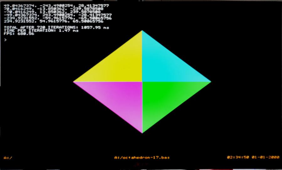

LeoNicolas
Joined: 07/10/2020
Posts: 625
Posted: 10:31pm 14 Nov 2020
The same values here.
I've fixed an issue and now my time is 1057ms. I'm using matrix multiplication, maybe using direct calculation will be fast. I'll try it.
Edited 2020-11-15 08:39 by LeoNicolas

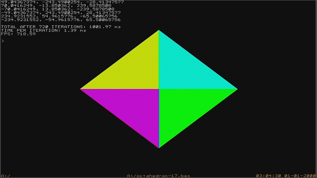

LeoNicolas
Joined: 07/10/2020
Posts: 625
Posted: 10:56pm 14 Nov 2020
vigipete, the credits for this optimization go to you. I reached 1001.97 ms
PS:
I'm not counting the time to print the 650th data.

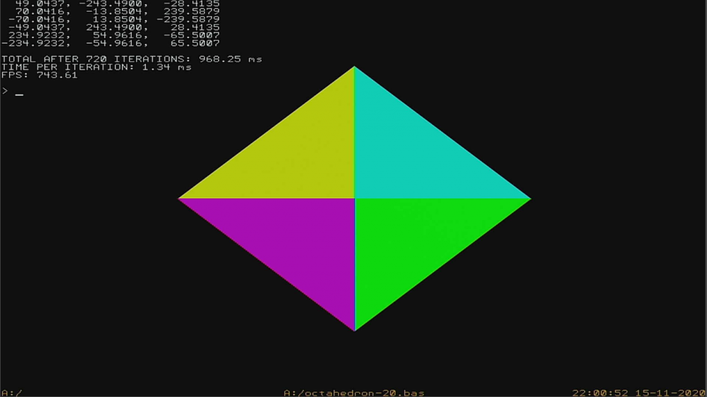

LeoNicolas
Joined: 07/10/2020
Posts: 625
Posted: 02:41am 16 Nov 2020
Finally, I've got an execution time below 1s
Total execution time: 968.25 ms
Edited 2020-11-16 16:02 by LeoNicolas

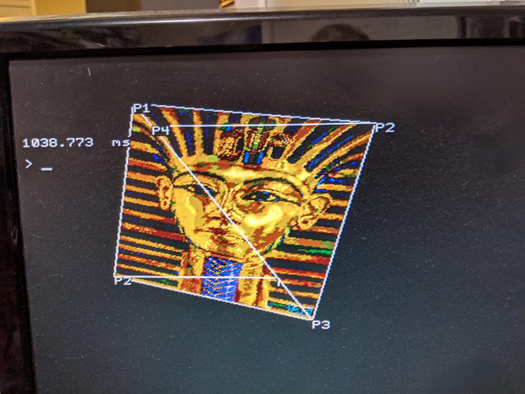

PeteCotton
Joined: 13/08/2020
Posts: 669
Posted: 12:54am 18 Nov 2020

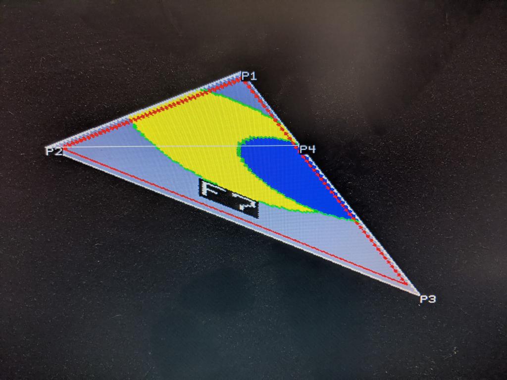

  matherp said  I need the most efficient algorithm to identify the best single pixel in a rectangle to copy.
Just a quick update on this. I've got an efficient algorithm for mapping triangles working well. It turned out to be trickier than I thought due to all of the combinations of source image points and destination points, flipped images etc. But it handles them all well now. Basically throw any 3 destination points and any 3 source points (and the source graphics page number) and it will map it correctly.
The best method I could come up with was to split the triangle in two and draw it as a flat bottomed triangle on top of a flat topped triangle. This allows me to walk down the outside edges of the top triangle, and then walk down the outside edges of the bottom triangle.
In the image below I have drawn in this extra 4th point and the split line between the two triangles. So the top triangle is P1-P4-P2 and the bottom one is P2-P4-P3.
I had hoped to be able to use this to create rectangles by splitting the rectangles in to two triangles (see below), however it distorts the mapped image. (in the picture below the right hand triangle takes up more physical on screen pixels than the left hand one - yet they are mapping the same number of pixels from the source image).
But not to worry, now that I have the triangle code working, it's a simple task to alter it to work with a four sided shape. I will get that working in the next few days.
After I have the rectangle working I will post the code for both functions here. Maybe you guys could improve upon it? Speed it up? Find bugs etc. The algorithm itself is pretty simple.

' draw iteration 0
ze=rho- v0(2) :  x0=-d* v0(0)/ze :  y0=d* v0(1)/ze ' project 12 points
ze=rho- v1(2) :  x1=-d* v1(0)/ze :  y1=d* v1(1)/ze
ze=rho- v2(2) :  x2=-d* v2(0)/ze :  y2=d* v2(1)/ze
ze=rho- v3(2) :  x3=-d* v3(0)/ze :  y3=d* v3(1)/ze
ze=rho- v4(2) :  x4=-d* v4(0)/ze :  y4=d* v4(1)/ze
ze=rho- v5(2) :  x5=-d* v5(0)/ze :  y5=d* v5(1)/ze
ze=rho- v6(2) :  x6=-d* v6(0)/ze :  y6=d* v6(1)/ze
ze=rho- v7(2) :  x7=-d* v7(0)/ze :  y7=d* v7(1)/ze
ze=rho- v8(2) :  x8=-d* v8(0)/ze :  y8=d* v8(1)/ze
ze=rho- v9(2) :  x9=-d* v9(0)/ze :  y9=d* v9(1)/ze
ze=rho-v10(2) : x10=-d*v10(0)/ze : y10=d*v10(1)/ze
ze=rho-v11(2) : x11=-d*v11(0)/ze : y11=d*v11(1)/ze
if (x1-x6)*(y1-y8)<(x1-x8)*(y1-y6) then    ' face 0: 1, 6, 8
 triangle x1+cenx,y1+ceny,x6+cenx,y6+ceny,x8+cenx,y8+ceny,&hFF0000,&hFF0000
endif
if (x1-x8)*(y1-y0)<(x1-x0)*(y1-y8) then    ' face 1: 1, 8, 0
 triangle x1+cenx,y1+ceny,x8+cenx,y8+ceny,x0+cenx,y0+ceny,&h00FF00,&h00FF00
endif
if (x1-x0)*(y1-y10)<(x1-x10)*(y1-y0) then    ' face 2: 1, 0,10
 triangle x1+cenx,y1+ceny,x0+cenx,y0+ceny,x10+cenx,y10+ceny,&h0000FF,&h0000FF
endif
if (x1-x10)*(y1-y7)<(x1-x7)*(y1-y10) then    ' face 3: 1,10, 7
 triangle x1+cenx,y1+ceny,x10+cenx,y10+ceny,x7+cenx,y7+ceny,&hFFFF00,&hFFFF00
endif
if (x1-x7)*(y1-y6)<(x1-x6)*(y1-y7) then    ' face 4: 1, 7, 6
 triangle x1+cenx,y1+ceny,x7+cenx,y7+ceny,x6+cenx,y6+ceny,&hFF00FF,&hFF00FF
endif
if (x6-x7)*(y6-y3)<(x6-x3)*(y6-y7) then    ' face 5: 6, 7, 3
 triangle x6+cenx,y6+ceny,x7+cenx,y7+ceny,x3+cenx,y3+ceny,&h00FFFF,&h00FFFF
endif
if (x6-x3)*(y6-y9)<(x6-x9)*(y6-y3) then    ' face 6: 6, 3, 9
 triangle x6+cenx,y6+ceny,x3+cenx,y3+ceny,x9+cenx,y9+ceny,&hFF0000,&hFF0000
endif
if (x6-x9)*(y6-y8)<(x6-x8)*(y6-y9) then    ' face 7: 6, 9, 8
 triangle x6+cenx,y6+ceny,x9+cenx,y9+ceny,x8+cenx,y8+ceny,&h00FF00,&h00FF00
endif
if (x8-x9)*(y8-y4)<(x8-x4)*(y8-y9) then    ' face 8: 8, 9, 4
 triangle x8+cenx,y8+ceny,x9+cenx,y9+ceny,x4+cenx,y4+ceny,&h0000FF,&h0000FF
endif
if (x8-x4)*(y8-y0)<(x8-x0)*(y8-y4) then    ' face 9: 8, 4, 0
 triangle x8+cenx,y8+ceny,x4+cenx,y4+ceny,x0+cenx,y0+ceny,&hFFFF00,&hFFFF00
endif
if (x0-x4)*(y0-y5)<(x0-x5)*(y0-y4) then    ' face 10: 0, 4, 5
 triangle x0+cenx,y0+ceny,x4+cenx,y4+ceny,x5+cenx,y5+ceny,&hFF00FF,&hFF00FF
endif
if (x0-x5)*(y0-y10)<(x0-x10)*(y0-y5) then    ' face 11: 0, 5,10
 triangle x0+cenx,y0+ceny,x5+cenx,y5+ceny,x10+cenx,y10+ceny,&h00FFFF,&h00FFFF
endif
if (x10-x5)*(y10-y11)<(x10-x11)*(y10-y5) then    ' face 12: 10, 5,11
 triangle x10+cenx,y10+ceny,x5+cenx,y5+ceny,x11+cenx,y11+ceny,&hFF0000,&hFF0000
endif
if (x10-x11)*(y10-y7)<(x10-x7)*(y10-y11) then    ' face 13: 10,11, 7
 triangle x10+cenx,y10+ceny,x11+cenx,y11+ceny,x7+cenx,y7+ceny,&h00FF00,&h00FF00
endif
if (x7-x11)*(y7-y3)<(x7-x3)*(y7-y11) then    ' face 14: 7,11, 3
 triangle x7+cenx,y7+ceny,x11+cenx,y11+ceny,x3+cenx,y3+ceny,&h0000FF,&h0000FF
endif
if (x3-x11)*(y3-y2)<(x3-x2)*(y3-y11) then    ' face 15: 3,11, 2
 triangle x3+cenx,y3+ceny,x11+cenx,y11+ceny,x2+cenx,y2+ceny,&hFFFF00,&hFFFF00
endif
if (x2-x11)*(y2-y5)<(x2-x5)*(y2-y11) then    ' face 16: 2,11, 5
 triangle x2+cenx,y2+ceny,x11+cenx,y11+ceny,x5+cenx,y5+ceny,&hFF00FF,&hFF00FF
endif
if (x2-x5)*(y2-y4)<(x2-x4)*(y2-y5) then    ' face 17: 2, 5, 4
 triangle x2+cenx,y2+ceny,x5+cenx,y5+ceny,x4+cenx,y4+ceny,&h00FFFF,&h00FFFF
endif
if (x2-x4)*(y2-y9)<(x2-x9)*(y2-y4) then    ' face 18: 2, 4, 9
 triangle x2+cenx,y2+ceny,x4+cenx,y4+ceny,x9+cenx,y9+ceny,&hFFFFFF,&hFFFFFF
endif
if (x2-x9)*(y2-y3)<(x2-x3)*(y2-y9) then    ' face 19: 2, 9, 3
 triangle x2+cenx,y2+ceny,x3+cenx,y3+ceny,x9+cenx,y9+ceny,&h404040,&h404040
endif
for iter = 1 to 720
 cx = cos(2*iter) : sx = sin(2*iter)   ' GRRR - rule change
 cy = cos(1*iter) : sy = sin(1*iter)   ' must recalc rotation matrix
 cz = cos(.5*iter) : sz = sin(.5*iter) ' each iteration
 trot(0,0) = cz * cy
 trot(1,0) = sz * cy
 trot(2,0) = sy
 trot(0,1) = cz * sx * sy - sz * cx
 trot(1,1) = cz * cx + sz * sx * sy
 trot(2,1) = - sx * cy
 trot(0,2) = - cz * cx * sy - sz * sx
 trot(1,2) = cz * sx - sz * cx * sy
 trot(2,2) = cx * cy
 math v_mult trot(), v0(), vt0()  ' rotate
 math v_mult trot(), v1(), vt1()  ' 6 points
 math v_mult trot(), v2(), vt2()  ' in
 math v_mult trot(), v3(), vt3()  ' three
 math v_mult trot(), v4(), vt4()  ' dimensions
 math v_mult trot(), v5(), vt5()
 math v_mult trot(), v6(), vt6()
 math v_mult trot(), v7(), vt7()
 math v_mult trot(), v8(), vt8()
 math v_mult trot(), v9(), vt9()
 math v_mult trot(),v10(),vt10()
 math v_mult trot(),v11(),vt11()
 bx = min(x0,x1,x2,x3,x4,x5,x6,x7,x8,x9,x10,x11)+cenx
 bh = max(x0,x1,x2,x3,x4,x5,x6,x7,x8,x9,x10,x11)+cenx+&h2 ' calculate
 by = min(y0,y1,y2,y3,y4,y5,y6,y7,y8,y9,y10,y11)+ceny
 bv = max(y0,y1,y2,y3,y4,y5,y6,y7,y8,y9,y10,y11)+ceny+&h2 ' erasing box
 box bx,by,bh-bx,bv-by,,&h0,&h0   ' erase previous image - dynamic size calc
'  box 193,92,416,420,0,0,0 ' slightly faster than calculated box
 ze=rho- vt0(2) :  x0=-d* vt0(0)/ze :  y0=d* vt0(1)/ze ' project 12 points
 ze=rho- vt1(2) :  x1=-d* vt1(0)/ze :  y1=d* vt1(1)/ze
 ze=rho- vt2(2) :  x2=-d* vt2(0)/ze :  y2=d* vt2(1)/ze
 ze=rho- vt3(2) :  x3=-d* vt3(0)/ze :  y3=d* vt3(1)/ze
 ze=rho- vt4(2) :  x4=-d* vt4(0)/ze :  y4=d* vt4(1)/ze
 ze=rho- vt5(2) :  x5=-d* vt5(0)/ze :  y5=d* vt5(1)/ze
 ze=rho- vt6(2) :  x6=-d* vt6(0)/ze :  y6=d* vt6(1)/ze
 ze=rho- vt7(2) :  x7=-d* vt7(0)/ze :  y7=d* vt7(1)/ze
 ze=rho- vt8(2) :  x8=-d* vt8(0)/ze :  y8=d* vt8(1)/ze
 ze=rho- vt9(2) :  x9=-d* vt9(0)/ze :  y9=d* vt9(1)/ze
 ze=rho-vt10(2) : x10=-d*vt10(0)/ze : y10=d*vt10(1)/ze
 ze=rho-vt11(2) : x11=-d*vt11(0)/ze : y11=d*vt11(1)/ze
 endif
 endif
 endif
 endif
 endif
 endif
 endif
 endif
 endif
 endif
 endif
 endif
 endif
 endif
 endif
 endif
 endif
 endif
 endif
 endif
 if iter = 650 then SaveVerts
'  print @(700,0) iter : do : loop until inkey$ <> ""  ' uncomment for step by step
next iter
