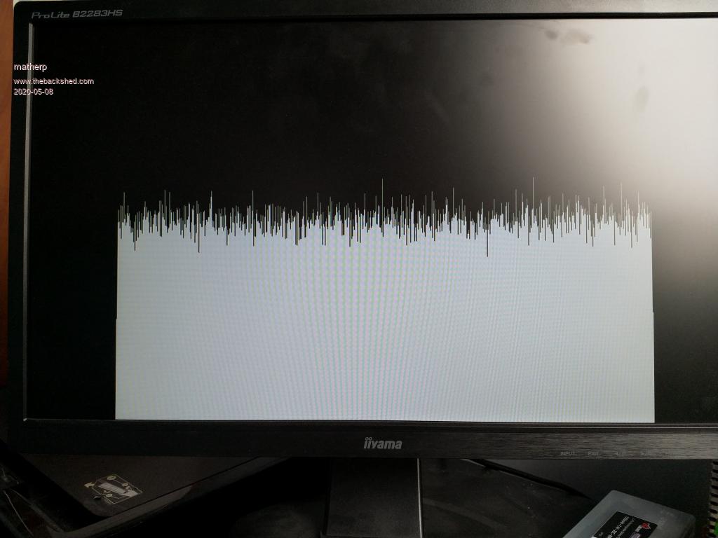

Try the attached - takes 75 microseconds to run on the CMM2, x is the seed
function pseudo() as float
 static integer x=7
 static integer a=1103515245
 static integer c=12345
 static integer m=2^31
 x=(a * x + c) mod m
 pseudo = x/m
end function
and here is the distribution analysis
Edited 2020-05-08 20:52 by matherp

  Quote   have no idea how or how to use it to generate a series of pseudo random numbers.
Just use it like RND() returns a number between 0 and 1. The sequence is determinate. If you need a different sequence then change the initialisation of X in the function - same as using randomize.
The code is exactly what the C call to rand used in the Micromite firmware is doing. Found it on google and easy to program in Basic
It should run on any Micromite - try it.
My code for the distribution
cls
dim a%(799)
for i%=1 to 800*300
j%=pseudo()*800-0.5 'exactly equivalent to using RND()
a%(j%)=a%(j%)+1
next i%
for i%=0 to 799
line i%,599-a%(i%),i%,599
next i%
do
loop
 static integer x=7
 x=(a * x + c) mod m
 pseudo = x/m
end function

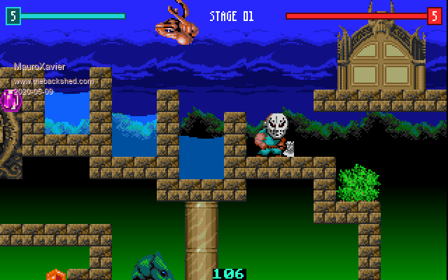

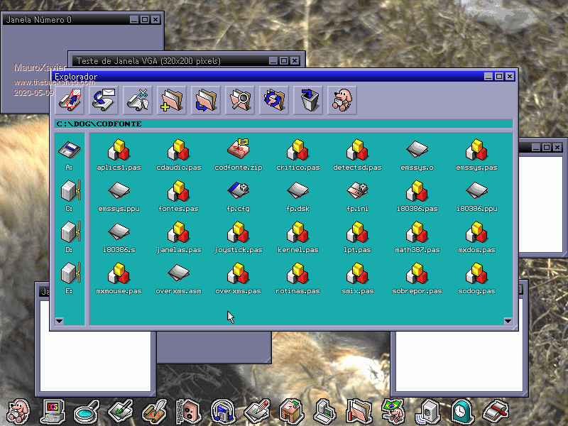

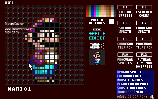

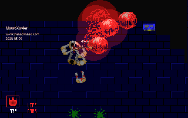

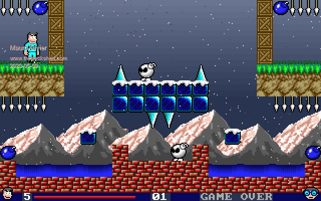

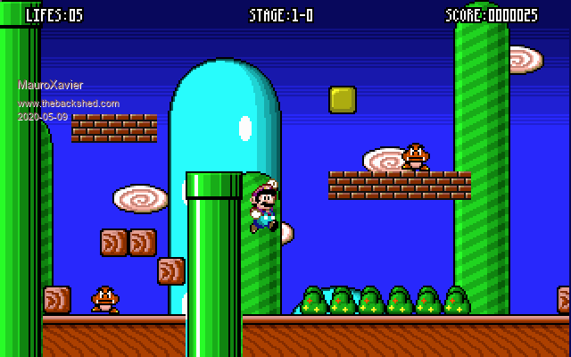

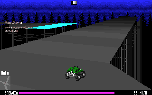

Here are some images of my DOS Games using my "MXMisc" library made in assembly, when I was around 14 years old:
Zombie Arena
Crack Zone
Mario DOS
MXEdit - Sprite editor for MXMisc
MX Racer
Adventures of Mauro & Nohama
And this is a SO developed in Turbo Pascal with inline Assembly. When I developed this I had around 18 years and was my final work for the college.
Some of these I intend to port for Colour Maximite 2, including the OS.
After I jumped to Linux, using C, C++, Python, PHP, Java, Lazarus, and others. Actually, when I develop games in Linux I use Python with PyOpenGL or PyGame and Panda3D. Maybe I upload some videos with the source codes, but one of them I can put a link here only because is a Paper Mario HD and with Nintendo no one joke. I'm started a Pacman Championship clone using Dijkstra's algorithm for ghost 5 years ago, but in the end, I turned it only in a demo for the PyOpenGL and PyGame courses that I taught to underprivileged minors.
Today retro games are only a hobby to calm my nerves, and both Colour Maximites helped me with this!
