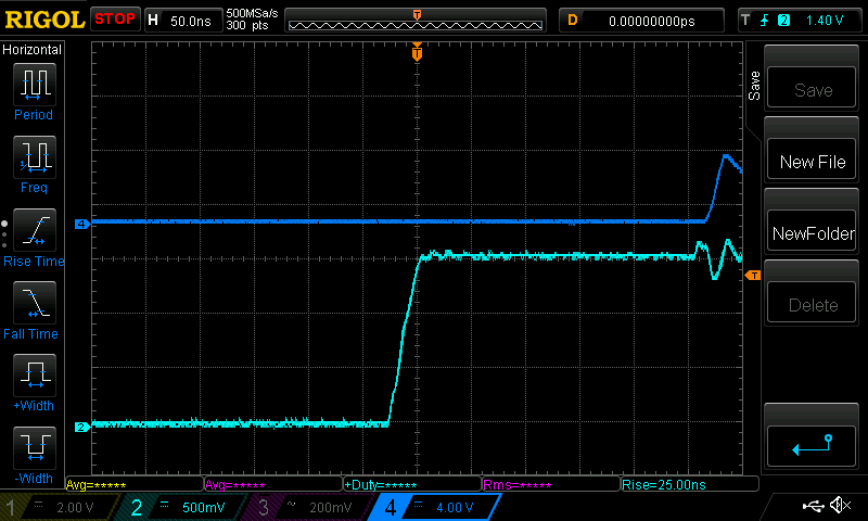

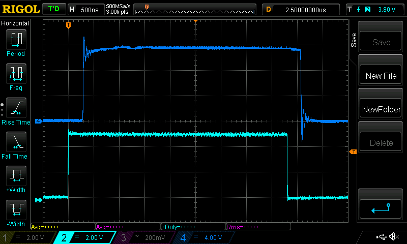

Here is the output of the Nano, as measured across the 5K pulldown resistor I have on Pin D9. This is light Blue trace.
I have a 1K resistor in series with this output, which leads into the LED of the TLP-250. So the forward current is 5mA.
Dark Blue is the output of TLP-250, when driven with a 12V supply, with bypass caps of 0.1uF ceramic and 10uF Tantalum, both located less than 3mm from the ground and 12V supply.
The TLV-250 specs say there will be a propagation delay of 0.15uS typical, and 0.5uS maximum delay. It appears we are seeing a delay of about 0.3uS for both turn on and turn off.
No biggie.
Here is the voltage at one of the two MOSFET's gate pins, after the signal passes through the 10 Ohm gate drive resistor.
What a clear illustration of charging a capacitor. We could work out the capacitance of this maybe, if the current was constant. Which it probably is not.
The MOSFETs are NOT driving any loads. The input voltage for the converter is zero.
This is what we see when the MOSFETs are switching nothing at all.
It's a capacitive load.
I notice the ringing on the output of the TLP-250 and wonder if that can be reduced with some better bypassing cap choices. This will effect the quality of the MOSFET turn ON and OFF when switching proper loads. Something for the weekend I think.
I can not accept that 5V from the Nano, via a 1K resisitor is insufficient to drive the TLP-250.
The specs say best is to drive it with 8mA, I am driving it with 5mA.
Notice the light Blue trace? 5V with a rise time of 4.6ns
Here is the voltage on pin 2 of the TLP-250.
Light Blue trace.
This is the forward voltage of the LED inside the chip.
The rise time is 25ns.
The forward voltage is 1.5V and it gets there quickly and stays there.
For sure, the Nano is not putting out the full 5V, I would estimate it to be 4.9V
Close enough for government work.
The worry that the Nano can not drive the TLP-250, using a 1K series resistor is to be discarded. The Nano drives it well and with no effort at all.

Mike,
top and bottom.

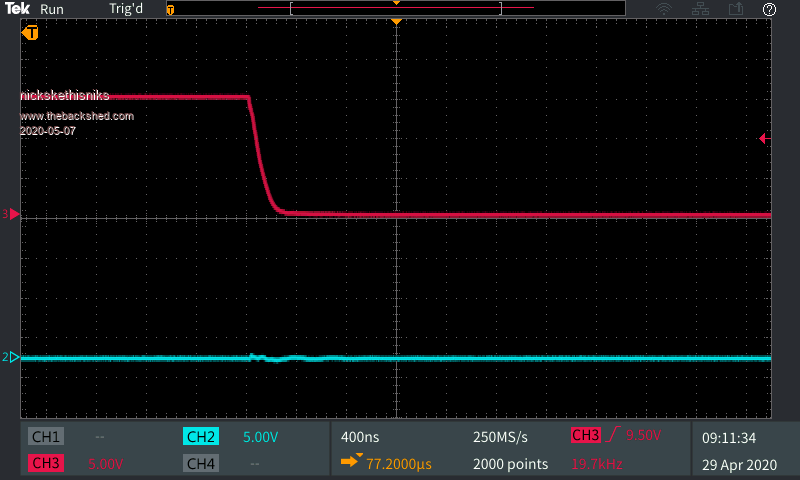

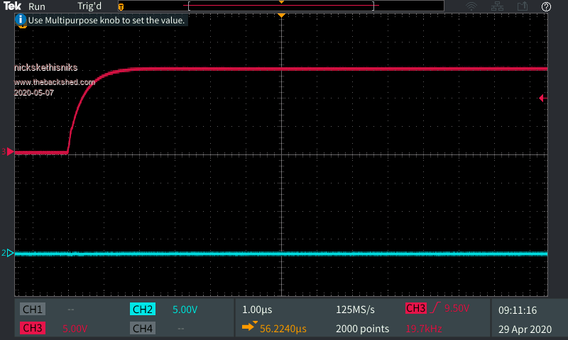

What is the mosfet you are using? Try switching your mosfet slower, it's possible you get a nice ramping up without shoot thrue arround the miller plateau. Try 20-30R, I've got nice curves with 25R and IRFP4110 on 15V, I switch off with 5R though.
Pictures without load, (Ok, timebase is a bit wider with me)

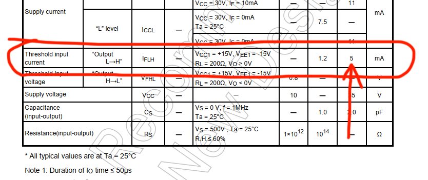

Peter, the reason the manufacturers give recommended operating conditions and produce data sheets is so their parts can be used for best performance reliability and life.
Their parts with the same part number they produce are all slightly different but they produce the data sheet and all those figures and graphs and guarantee that they comply with all the min typ and max values and graphs when they are run within their recommended operating conditions.  This is not my interpretation it is fact.
Whilst the opto parts you and Nick are using may be working with less drive current  they are more susceptible to noise degradation, operating life and unknown performance for other specs such as temperature behaviour.
It does not mean that the parts wont work when being used outside of their recommended parameters but that begs the question how close to poorer performance am I actually operating at.

Mike,
thanks for returning it with topspin for a win.
Even though I read and re-read the TLP-250 specs I still did not see
5mA possible threshold input current to turn on the LED!
I am driving it 5mA by design via the 1K series resistor.
So it's marginal already.
You were right to persevere in trying to make me see the bleeding obvious.
So the 1K resistor is OUT and the 620R is IN, to take the optocoupler input drive
current to the recommended 8mA.
Reading a few articles, Agago's Optocoupler Design guide and Broadcom's "Calculate Reliable LED Lifetime Performance in Optocouplers" white paper I see that the LED output does degrade over time. The rate of reduction in light output increases as the driving current increases. This degradation is of the order of 10% loss over 5 to 10 years for GaAlAS type LEDs so yes, there is some but to my mind there is not a lot.
I did a quick test to see how marginal this particular TLP-250 IC is running.
I put a pot in series with the Nano PWM output and the 1K current limit resistor.
Glitchy switching appears with about 1,900 Ohms on the pot.
Adding this to the 1K we get 5V / (1000 + 1900) = 1.7mA as the threshold
for this board on the bench here at work.
There are temperature effects on this no doubt.

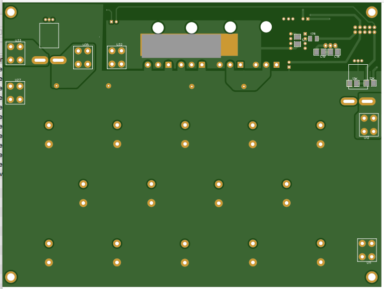

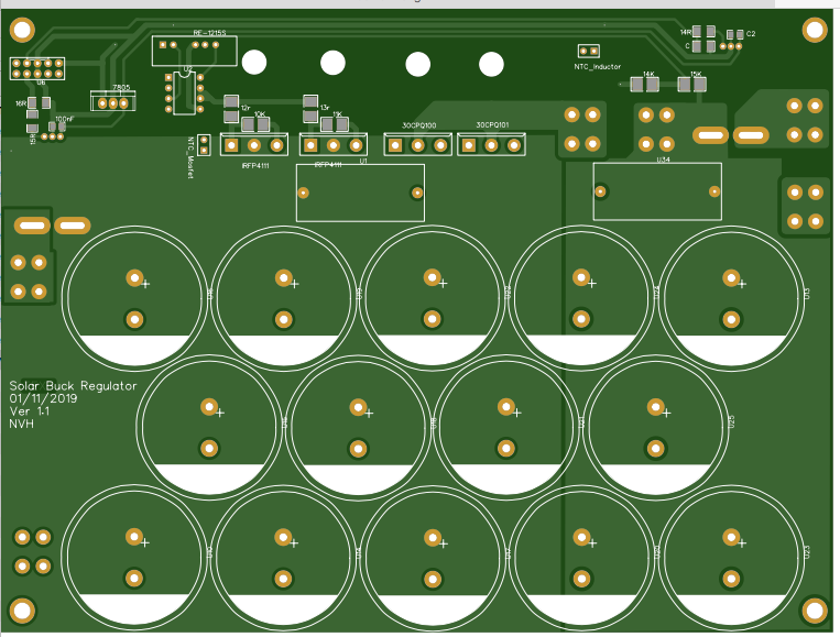

With regard to the PCB, from inspection it appears that the 10 pin connector to the nano is maybe not on the best end of the board, leading to longish tracks carrying analog signals.
Move the output neg connection to in line with the middle row of capacitors.
Move the output positive down to where the neg terminal currently is.
Introduce a clearance between the choke output screw connector and the + output forcing the choke noise to go to the capacitors & get filtered more first before feeding the current sensor.
Return the lower divider resistor (solar vin) to the gnd of the 10 pin connector instead of the ground plane - electrically the same potential but we are trying to minimise noise.
Return the mosfet thermistor to same point as above - not to the ground plane.
It might be better if I sketch the rest of my suggestions & maybe Nicks and I could talk sometime as writing & explaining so much stuff takes a lot of time, and there will be questions.
Please NB after my own designs are finished I always try to review them with new eyes and often find improvements.  After you have been designing PCBs for many years your designs have greater chances of working first time with less issues because you avoid and do things by intuition & past experiences without even realising it.
Please consider any suggestions I make as refinements and not as outright errors - this design is already 98% of the way already.
Edited 2020-05-08 12:11 by wiseguy

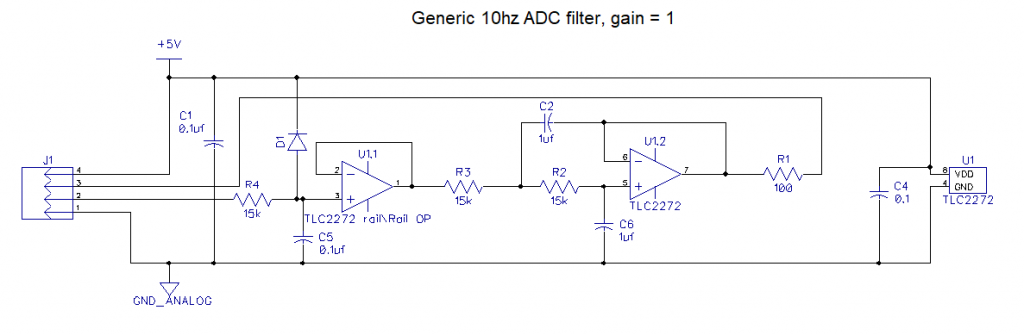

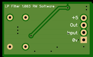

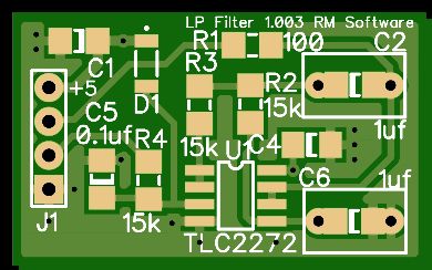

Poida, regarding the low pass noise filter for your A-D inputs, here is a circuit that I use a lot (10 Hz LP); uses a low noise rail to rail op amp. I make them on a tiny pcb 18 x 30mm fitted with a 4 pin pcb connector. Just place them on your CPU board close to the CPU inputs.Being an active filter it has a much sharper response than a simple RC combination.
Here are the gerbers for a panel of them (9), using 1mm thick pcb, just cut out with tin snips.
Gerbers_Filter_1003.zip
Sorry all smd to get the size down.

Wiseguy I was hoping you would join the conversation, much appreciated!
I will work on a list with things to be improved, don't know to which level we will get.
