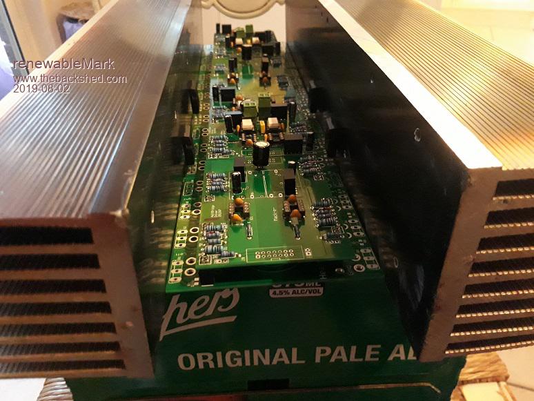

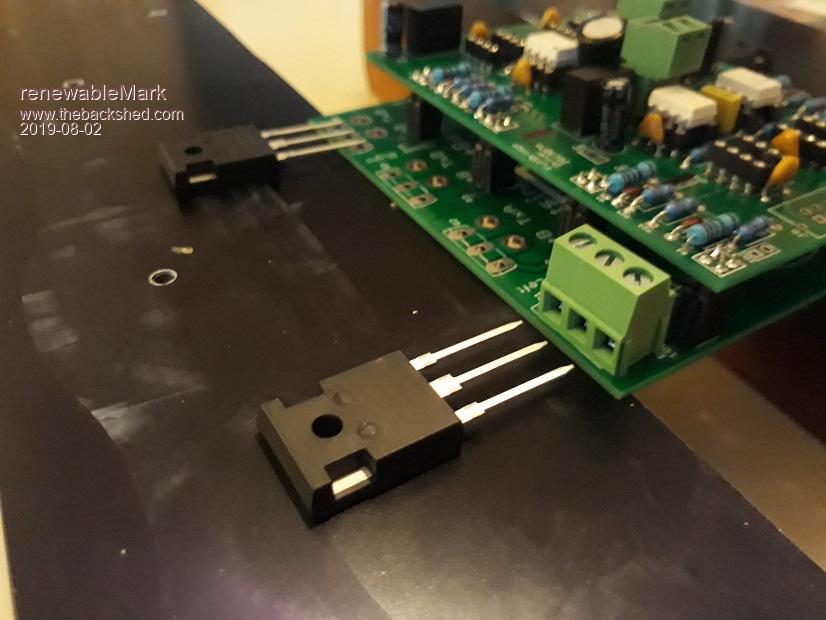

Not sure which way to jump here.
I could align the heatsinks this way, but getting at the fixing bolts will be a bit fiddly.
Or it could be done this way.
The fets could either be soldered in and the legs bent around (being careful not to stress the leg where it goes into the black body of the fet)
Or the 20A plugs could get used.
Cheers Caveman Mark
Off grid eastern Melb
Posted: 05:56am 02 Aug 2019
As you say, the top picture is going to be difficult to access the screws.
Soldering in is not a good idea IMHO, and if you use screw terminal blocks in the top picture the screws on those will be even more difficult to reach.
I much prefer the lower picture. The screws are all facing straight up and you can see what you are doing with excellent access and visibility.

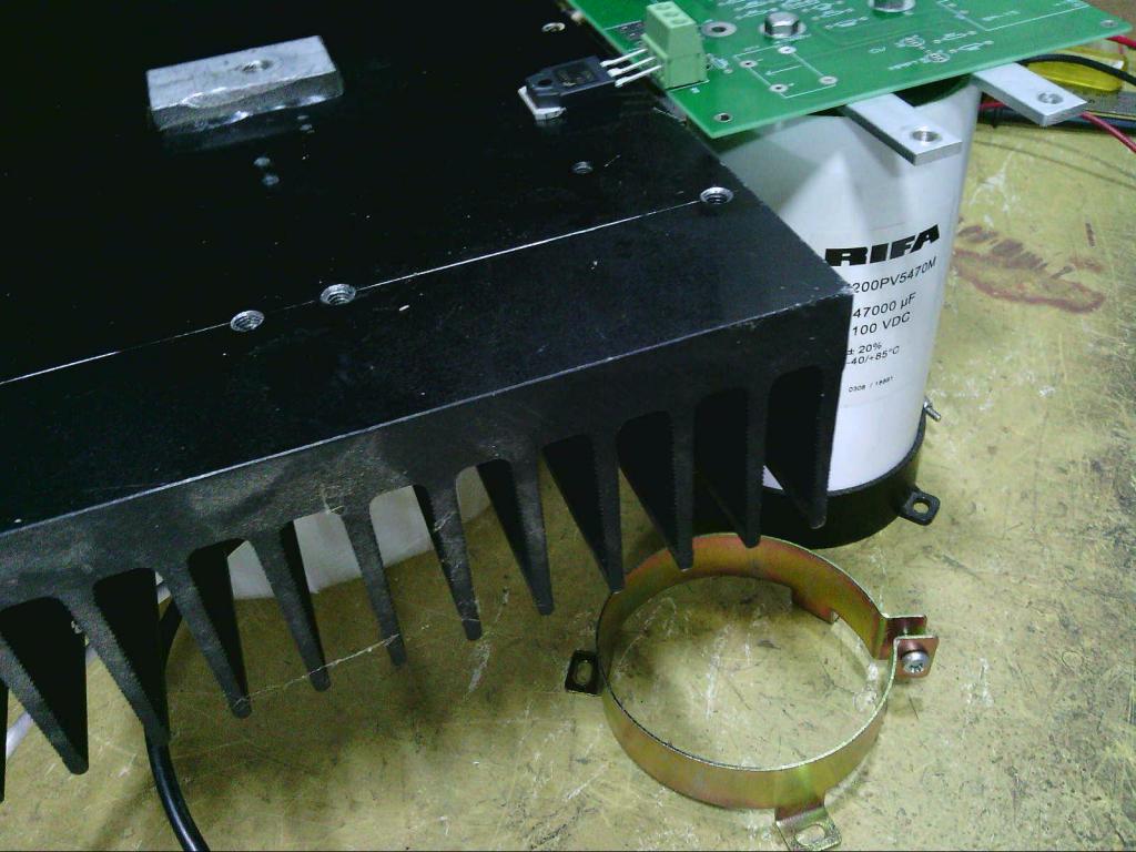

You could use conventional capacitor clamps to support the capacitors, then use the capacitor terminals to support the busbars and circuit boards.
The mosfet legs can then bridge between the circuit board and heatsink, like this:
I was always worried about bending the legs of the bigger devices. But, I do like the idea of the Mosfet being horizontal like in photo two.

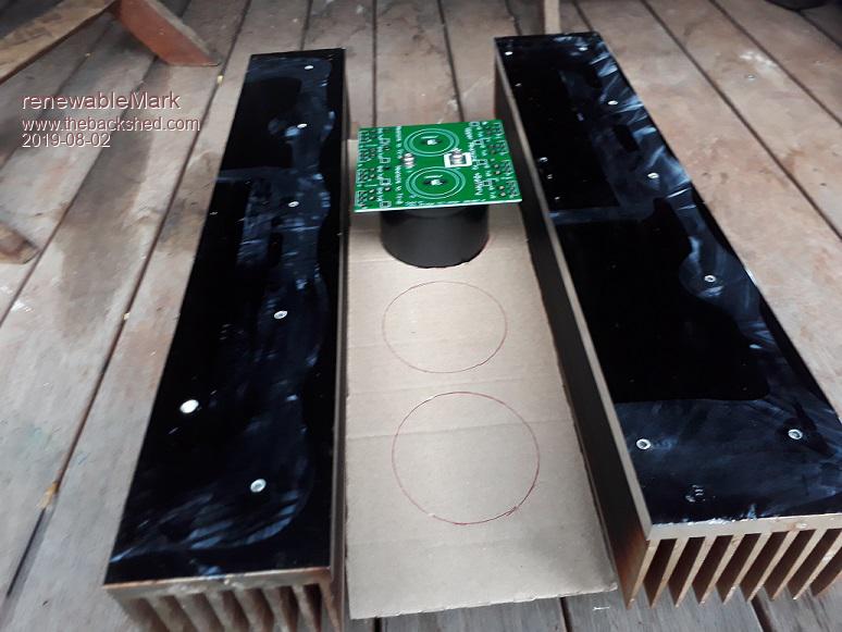

Thinking about this a bit more................
How about a big flat sheet of 3mm aluminium with a row of 75mm holes for the capacitors.
The capacitor clamps can clamp around near the middle of the capacitors, and the height of the circuit board can be adjusted to perfection.
The finned heatsinks bolt to the aluminium plate forming an air tunnel.
It would make a very rigid easy to fabricate structure, that ties everything together with everything very easy to work on.

Posted: 07:07am 02 Aug 2019

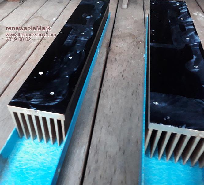

Like this?
I was thinking perspex, that way I won't need to worry about insulating the connections to heatsinks.
The caps aren't actually that heavy and the boards seem to support them just fine.
Anyway the initial idea was to use the fibreglass channel to tie it all in together.
Cheers Caveman Mark

Posted: 07:19am 02 Aug 2019
Turns out that fibreglass channel fits like a glove.
I have 2 bits each a bit over 2 metres, so plenty to make up a solid frame.
Cheers Caveman Mark
Yes exactly Mark.
The capacitor clamps may need to be located underneath the plate so you can get to the screws with the circuit board and busbars fitted.
I bolted (and epoxied) some aluminium angle to my heatsink, which then bolted down onto a big flat plate.

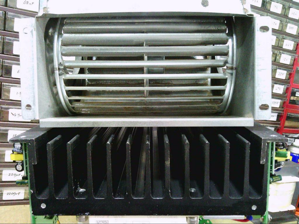

Posted: 07:42am 02 Aug 2019
A computer fan is not going to be up to the job, the pressure drop along that long heat sink is going to be quite high at sufficient air volume.
One or two centrifugal air blowers wold be more suitable. I used a 230v blower from a Rinnai gas room heater, but a 12v car heater blower might have more suitable dimensions.
Posted: 08:08am 02 Aug 2019
It will be more efficient, with a lower pressure drop if you feed the air blower into the middle of the heatsink, so that half the air goes up, and half the air goes down (onto the transformers). That is how I did mine.

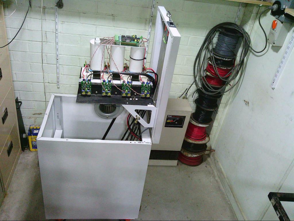

A good mechanical layout that is simple, neat, has very easy access, really good cooling, and is really pleasant to work on, is just as important as the detailed electronic design.

Posted: 10:07am 02 Aug 2019
That busbar will be 61 mm squared, in free air good for 300 amps + continuous.
Even 12mm x 3.2mm would be more than enough if its copper.
My blower has seen some 42C+ days and has never come on, not even once. The vertical tunnel heatsink works pretty well without any forced air help.
Ran the inverter with about 3Kw load which included a 1.6Kw hot air gun that was aimed right through the heat sink. It took about 25 minutes for the heatsink to hit 45C.
Its a massive chunk of aluminium.
When the blower started up, it pulled it back to 40C in about two minutes.
Its huge overkill, but I wanted something that I can definitely rely on.
Computer fans will probably be o/k, but if you really plan on 7.5Kw continuous for air conditioning, then it may need some help. Anyhow some real world testing will soon tell you.

Mark, something to think about is how to fix the Fets to the heatsink. If you fix the Fets directly to the large heatsink you have an awful lot of 3mm taps to do, I know you've done this before. If you use an aluminium bar, say 6mm x 50mm, you can nut and bolt the mosfets to that and fix the bar to the heatsink using a couple of either 6mm or 8mm bolts going into tapped holes of the heatsink. The 8mm bolts double as the connection points for the battery lug etc. 8mm taps into aluminium are much easier than 3mm taps.
