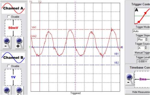

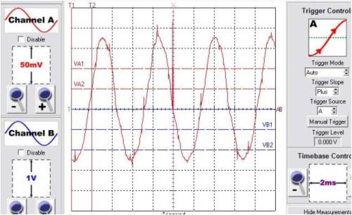

I have had the opportunity to measure and record the AC current in the stator. The current does flow during the whole cycle, not just when the voltage is above the battery threshold.
I present 2 storage oscilloscope[DSO] pics of measured AC current during similar wind/rpm with and without series caps.
This is with caps
7393
this screen is the mV across the current shunt. the AC period was 4.7mS.
This is without caps
this screen is the mV across the current shunt. the period was 4.4mS, so it was a slightly higher rpm.
This is the same current shunt with very similar wind conditions. There is a marked difference in the measured outputs.
The capacitors appear to provide a lot more than just power factor correction or reducing leakage inductance. The current waveform to the battery was pure DC and I had trouble locking the DSO to any signals.
The caps seem to work in conjunction with the rectifiers to provide current gain. The exact mechanism I hope will be debated and a better understanding gained.
An interesting observation is the variation in the shape of the current output between positive and negative transitions with or without capacitors. The reference of the DSO was connected to the rectifier side of the current shunt. This is a delta wiring of the stator.

Am I seeing a dc shift in the waveforms ? I take it you used dc coupling on the scope.
I do not subscribe that the main effect of caps is to counter leakage , its tied up with advancing the rotor and making better use of the rotor mmf IMHO.
It is very complex but for all practical purposes can be thought of as a means of increasing rotor mmf hence generating more emf at lower rpm this of course translates into current as we feed a fixed voltage.
I believe the Dc shift is the battery effect if you could repeat with a resistor load it would be interesting.

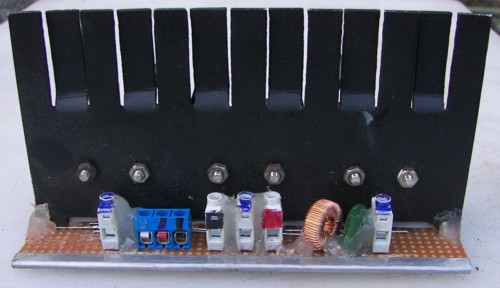

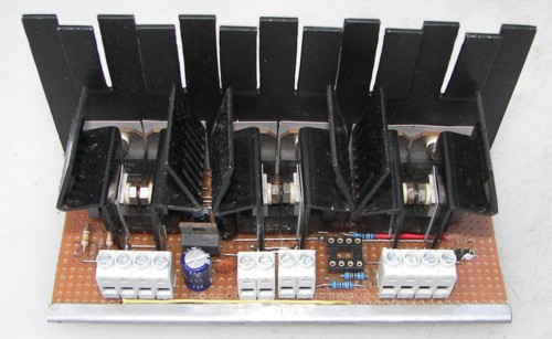

You read my mind. I thought the same thing a month or so ago. So I designed a circuit and built it. Testing and evaluation is currently under way. Back into it again this weekend. Herb will be pleased to hear I'm using fixed powers instead of fixed speeds for the tests.
