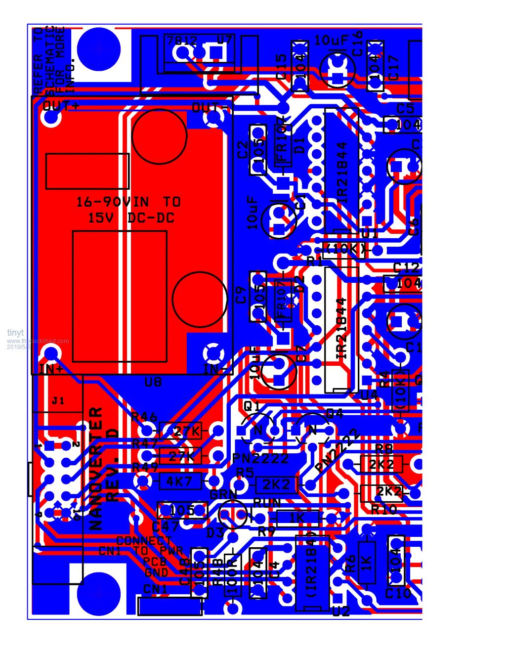

Here is rev. C 2019-05-03_072632_Nanoverter_C_Gerbers_Others.zip
The gerber files are zipped inside this zip file.
The following are the changes.
1. J4 for a normally closed switch is now in series with the anode of the scr Q6.
2. Connector J1 for ribbon harness is moved away from the DC-DC converter U8 to allow use of un-modified latching type header connector for J1.
I hope I did not make any other un-intentional changes.

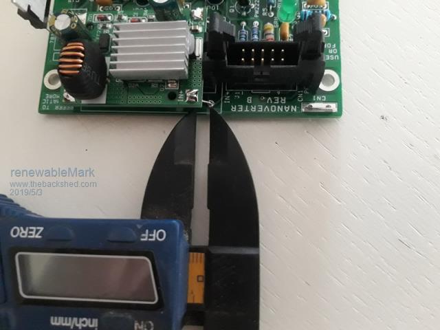

Thanks for reminding me. If you have a J1 latching type connector, can you measure and post the long dimension of its footprint? I want to make sure I have moved it sufficiently away from the DC-DC converter. After I get it, I will revise the gerbers for the silkscreen correction.
renewableMark
Joined: 09/12/2017
Posts: 1679
Posted: 04:49am 03 May 2019
Hi Tinyt,
no big deal with the power supply as it can be mounted high and bent across.
I used the thicker legs from some fr107's so it can carry the current nicely.
But if you wanted to it could be moved 4mm away from the ribbon connector.
You cant move the ribbon connector as it would block the mount hole.
It's no big deal if it's not moved though.
Cheers Caveman Mark

OK here is the updated file. 2019-05-04_025342_Nanoverter_C_Gerbers_Others.zip.
The change in distance between J1 and U8 is 4.57 mm. Had to move J1 closer to the edge to clear the mounting hole. I also had to move up U8 and U7. I hope it is enough for a latching type connector.
Silkscreen for D17 and D18 are also changed and also the scr reset.Edited by tinyt 2019-05-05

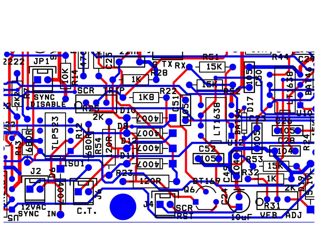

WHOOPS!

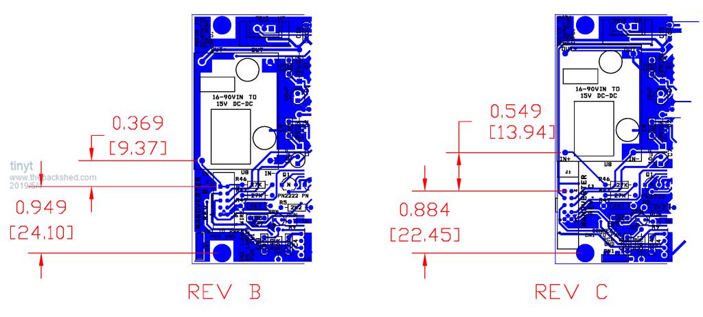

Don't use the rev C gerbers. Big mistake. When I moved J1, and routed manually, the 2HO trace shorts to gnd.
Will re-check carefully and upload rev D.
Sorry, I really am too old for this.

I still want to do this. It is up to you if you want to use the rev B files. It is only the J1, U8 and U7 connections that I need to check carefully, I will also go over the scr connection to make sure.
In that picture with dimensions I uploaded, you can see the mistake, it was the untouched trace that gets shorted to the IN- pin of the DC-DC (U8) when I moved U8. And it just so happened that the IN- pin pad landed at the corner of the trace. So visually it looks like the connection is intentional.

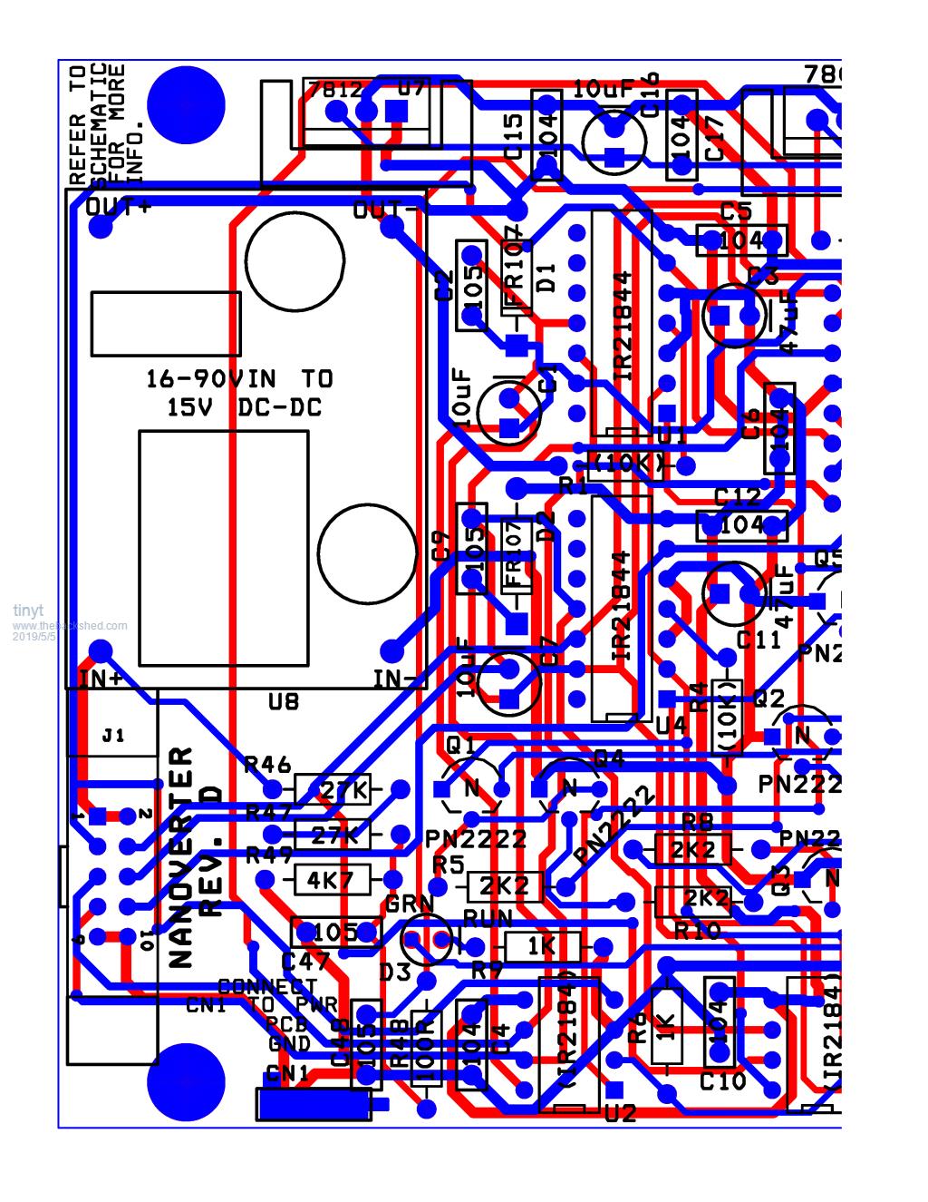

Here is rev D. 2019-05-05_081432_Nanoverter_D_Gerbers_Others.zip I checked it several times, hopefully I did not miss anything. I have also include the orcad layout .max file in case some of you can import it to your pcb software and will spend the time to check it.
Shown below is the area of the pcb with the major changes. It does not have yet the copper pour so that the copper traces can be seen easily. In case you want to check it this way.
And here is the same area with the copper pour applied.
I have added the scr area (no copper pour yet) below.
Edited by tinyt 2019-05-06
