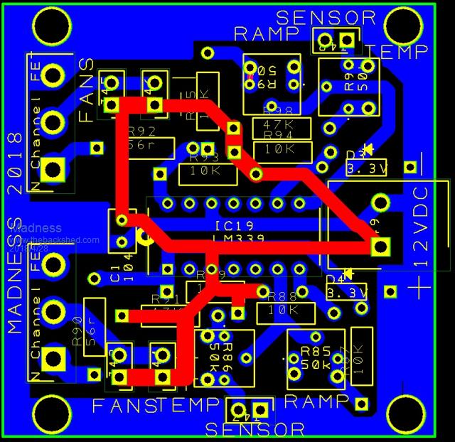

I have built the fan controller on to the control board so you do not need the separate fan board now. To build one inverter you just need 1 X Power Board and 1 X Control Board.

Fan board if anyone is interested it is 50 X 50mm.
