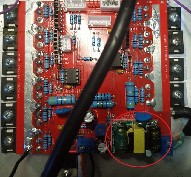

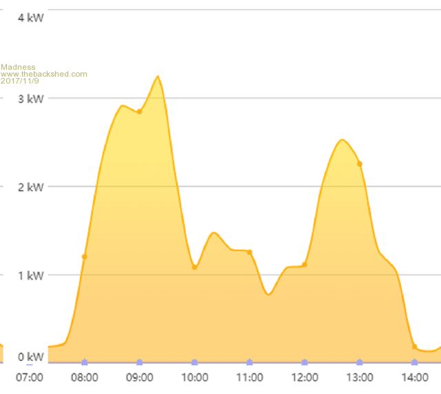

The Zeversolar GTI has been working perfectly for a week now since I discovered the arcing issue. I have not quite got the new boards in operation, few bits wiring to tidy up, will be done in the next few days.
Even though it has been a showery day we had a couple hours of sun this morning and the batteries where back up to 100% charge by 10:30 so the regulator cut back the GTI's output till later in the day when my wife did some baking.

Looks like the idea is sound... well done up there.

Just to recap, that Zeversolar GTI your using is a HF type, ie, no substantial heavy toroid inside. ?
Posted: 10:37pm 09 Nov 2017
Yes the Zeversolar is HF and also requires isolation from ground. So I have had to use the isolated power supply to supply 18V to the 3120 gate driver IC and insulate MOSFETs.
Apart from that failure I had which appears to have been caused by the arcing to ground the HF GTI has worked perfectly. I have found it to be much better than the Aero-sharps, the off grid inverter likes it better also. When the GTI is running the OGI is quieter and the waveform is very smooth which I did not get with the A-S GTI.

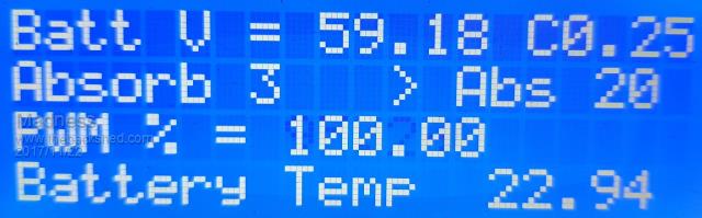

There has been some progress with the software for the controller however I am having hardware issues with FET's shorting out. This does not stop it charging but does prevent any regulation. I think it may have been due to the voltage for the Arduino dropping too low. I have modified the power supply to see if this cures it.
I have made a lot of changes to Oztules original code, it now includes actual voltage (with battery temperature compensation) and time settings in minutes. The original code timing varies greatly when you make changes to it, this code now uses the millis() function for much more accurate timing. This version also is made to work with a 4 line X 20 Character serial display. A future addition will be the abilty to turn on as required 2 solid state relays for things like diverting power to hot water systems/ pumps etc, I will be using one of these to turn on the AC in my equipment room when temperature rises and there is suffcient power available. Also an Ethernet card to allow networking and data logging (this will have Oztules shaking his head ). To do this I will need to rearrange some of the pins on the PCB, plus I need to resolve the power supply issue before ordering any more PCBs.
I have tested this code by simulating battery volts and temperature, I have not used it in real life yet. However I am confident it is fine,

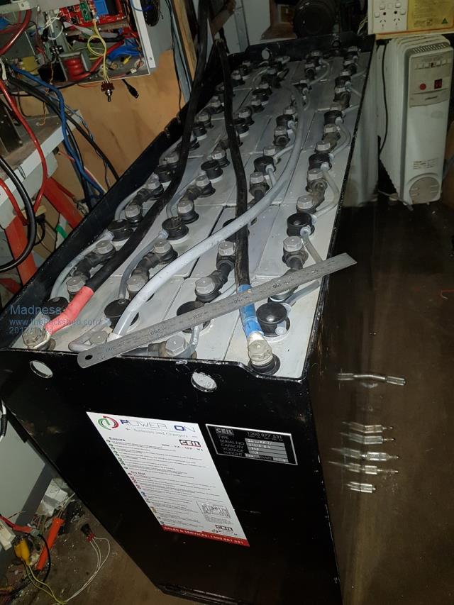

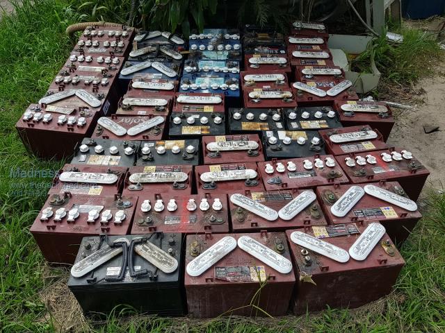

Posted: 10:53am 24 Nov 2017
Hi Mulver,
I have got to where I am gradual, started off with a few secondhand solar panels, some cheap batteries, second-hand charge controller and an Ebay HF inverter from Taiwan. Made the usual mistake of starting out with 24V. Biggest amount I have spent at any one time was $700. That is until my latest purchase which just arrived today.
Took a bit of brain power to work out how to get it unloaded and to where it sits now.Edited by Madness 2017-11-25
Posted: 11:40am 24 Nov 2017
Mad, you are game placing a metal ruler across that box
So, details please, capacity? weight?

Hi Klause,
I am MAD, normally I would agree with you about the ruler but the only part that is not insulated is the actual lugs for the leads leaving the battery bank. Each bolt head is insulated and sealed with o-rings to stop corrosion. But I did place the ruler very carefully just to give some scale for the photo. A rep from Trojan told me their batteries are designed to take a 5000A short without failing, that is something I would not like to try.
Details, 48V FLA 775AH @ 5 hour rate and weighs 1100KG and it was moved as one unit. Each cell is 100 X 200 X 742mm. It is a forklift battery if you had not guessed already, I have seen lots of reports that they are good for 20 years on solar. Wasn't too bad to move once I got it off the trailer, that took a hoist and lifting one end to drag it out, then hooked on to the other end and lifted a little and gradually it moved off. I used about 15 F&P washing machine shafts as rollers.
It is not quite in its final resting place, I have to get the old batteries out first. The scrap price of them is paying 1/3 of the price of the not quite new set. They are secondhand but have been refurbished and come with a 2 year replacement warranty.
All cells measure between 2.13 and 2.16 volts, the insulated bolts have a small hole in the centre for meter probe. Just quickly took one hydrometer reading and it was right to the bottom of the green. Tomorrow I will check and log where they all are after charging.
I expect to average 15% drawdown each night and should be able to keep it above 50% after 3 days of really bad weather.Edited by Madness 2017-11-25

Posted: 02:14pm 24 Nov 2017
Well done, they look pretty good, you can move some heavy gear using steal rollers.
Should keep you going.

Awsome. I had no idea that forklift batteries were that heavy. Come to think of it one really wants a forklift to move them .
Not being familiar with these batteries, the clear tubes on top are for recycling water vapor? Do you need to top the cells individually or is there a central filling place, that thicker clear tube in the middle?
I suppose your battery charging inverter will have its work cut out from now on.
Posted: 11:40am 25 Nov 2017
Yes they are really heavy and there are ones at least twice as big as the one I got. Moved it to its final position today after getting all the old batteries out, needed the steel shafts, hoist, crowbar and a few four-letter words but got it there. Not real easy to get it turn a tight corner, but I won in the end. I lifted it up on to 6 50mm square pieces of timber to allow air to flow under it to help keep it cool.
The tubes are the watering system, there is a float in each cell which controls the level, it also pops up into the clear circle on each cap to indicate it is full or low. The photo shows how they look when water is down, I topped it up this morning with a 20 litre container 2.5 metres above the battery top it filled in about 5 minutes using about 15 litres, they were just above the plates prior to that. Those caps have a top that flips open with a hole under it just big enough for a hydrometer to fit in.
The battery was fully charged when I got it, last night it was drawn down to 90% and had no trouble charging it today with almost complete cloud cover and a few showers. It went into float before 11 AM, plus my wife did ironing, washing and used the clothes dryer all powered by solar panels. The hot water system was running for about 4 hours as well which turns on automatically when the voltage is at the set point. So the AC power to the house was over 5KW for quite a few hours.
This the daily report from my GTI.
Date: 2017-11-25
E-Today: 15.0kWh
P-Peak: 3.01kW
Yield: 4.95$
CO2 Avoided: 12.0kg
There would have been similar amount from other anels as well.

The new battery is going really well after an initial problem with power dropouts. Turned out someone (not me) had not tightened one of the interconnectors properly, it was about 3/4 of a turn short of being tight. Only showed up when drawing over 100A, since tightening it the battery has been running perfectly. The new battery can complete the absorb cycle @ 59.2 volts and holding that voltage with just 15 amps.
I did not realise just how much power my old crap batteries were losing due to inefficiency, self-discharge etc. They cost me scrap price of $0.40 per KG now I am going to get $0.60 per KG. Here is what $1,200 worth of junk looks like.
Still unable to work out why the newer version of the Charge controller PCB is blowing MOSFET's.
Been working on software for the simpler version. It now includes time delay for resting the charge cycle, equalization cycle and manually being able to put it into Float or Absorb. Holding both Float and Absorb will initiate Equalization. I have also connected the Float button via a voltage divider to the AUX output of one of my Midnite charge controllers. So when the Midnite CC enters float and the AUX outputs 12V this supplies 5V to the pin on the Nano forcing it to enter float at the same time.
Here is the code which may be of help to someone.

That pile of batteries, They served you well for a bit. looks just like my backyard I have probably twice that many.
The new batteries will charge better on the cloudy days as they are more efficient.
I can't see why the mosfet's should fail, they are only on/off switching?.
Aaron
Cheers Aaron
Off The Grid
Posted: 12:02pm 03 Dec 2017
Price of lead is up so might be a good time to cash in those old batteries in Aaron. The old batteries did the job but they were a pita to top up the water and check specific gravity with so many individual cells.
Yes definitely a big difference on cloudy days, this morning we had partial cloud till around 10 and then it started raining on and off with no breaks in the clouds. We were able to do a load of washing, dry it in the dryer, run a wash in the dishwasher and still got to float by 1 PM. Not long after that, it got really dark and all my panels were making < 50W most of the afternoon.
Posted: 03:31am 16 Dec 2017
Finally solved the MOSFETs shorting issue, I had to separate the Drains of the MOSFETs from each other as per the diagram. It has been running well with this modification, I am not sure what difference it makes but this how my original design was made and it has not failed.
Edited by Madness 2017-12-17
Posted: 08:49am 16 Dec 2017
Hi mad, trying to understand what you are doing and knowing not much about GTI's...
Must one connect two strings of panels to this GTI or will it work if one has just one string of panels?
Posted: 09:31am 16 Dec 2017
Hi Tinker,
The GTI has 2 inputs each with its own MPPT circuitry, the maximum power either side can handle is 3500W. I have 2 strings of 2500W each giving a total of 5KW which is the maximum total output for the GTI.
It will work with one string but it is limited to the 3500W, the idea of being split into 2 is you can have each array in different conditions and it will get the most power from each string.
It has me baffled as to why the separation of the drains makes a difference but until I did this it would blow MOSFETs as soon as it starts regulating. At 100% on there was no issue, with only one string of panels connected it was fine, but with both connected it shorted out at least 1 MOSFET instantly when the PWM started.
