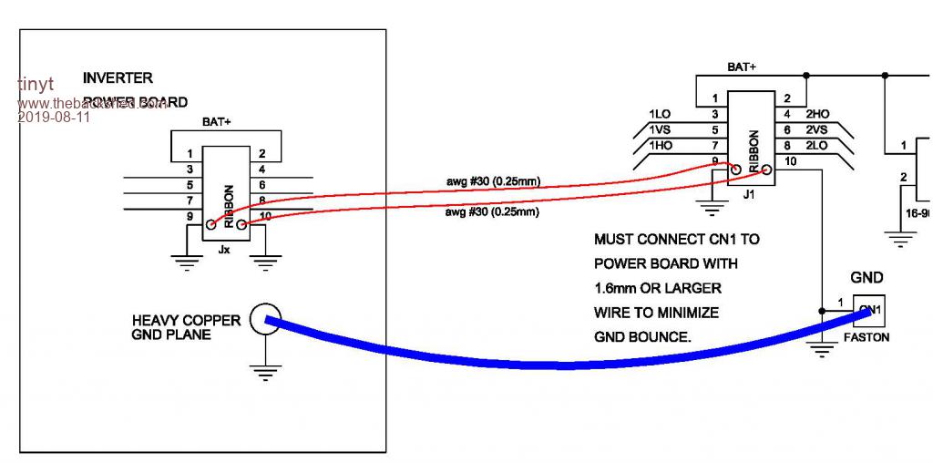

I don't know if excessive ground bounce is happening in your setup. The idea of CN1 connection is to minimize it.
My theory is any switching current drawn from the Jx pins 1 and 2 by the nanoverter will raise J1 pins 9 and 10 from Jx pins 9 and 10. The effect is 0 volt signal from the IR21844 will not be exactly 0 with respect to the power board ground. CN1 connection will minimize it, I think.

TinyT I will do this in the next attempt.
The changes made for the next attempt:
no ferrite beads on Drains
Add the thick ground lead

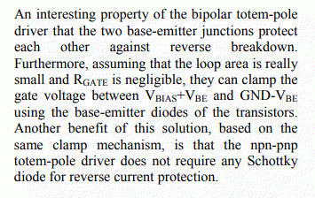

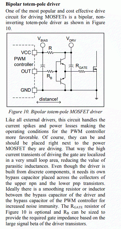

Here is a good explanation why this driver is good to use:
Good value for "R" is 10 ohms to isolate the driver chip supply from the output pulses, with the LHS cap 100uf and the RHS cap 1 to 10uf depending on the number of mosfets being driven, ideally one totem pole driver per mosfet.
