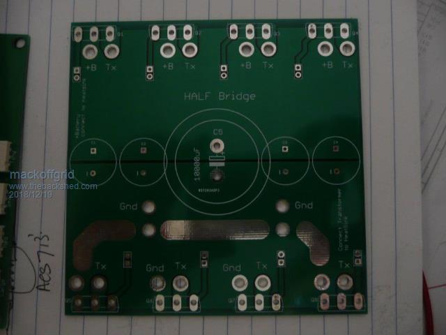

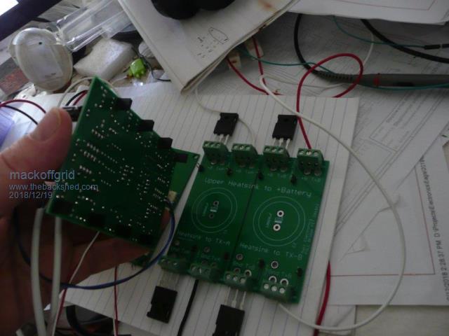

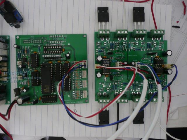

Hi Tony
I have got my new PCB's. I got them through JLCPCB and they were great. At $27 AUD inc DHL, paid for them on a Tuesday morning and DHL delivered them Friday that week !
Its all looking good so far, just waiting to clear some room to do a real test with 3 transformers.
Clock Board and a Fullbridge Board. (2 Fets per quadrant)
I have Half Bridge Boards also (4 Fets per quadrant )

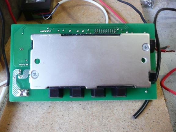

The Driver board plugs into the relevant FET Bridge board. Removing all components from the Bridge boards allows for full planes of copper for +Batt, GND, and Transformer Legs. I have done the calculations and believe the PCB should be good for a RMS current of 20 to 30 Amps per FET.

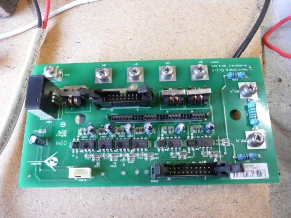

Driver Board and Full Bridge pcb.
I have done the driver boards so that a driver board can drive additional driver boards. In this way my large transformer can be driven from 2 half-bridge boards and a full-bridge board to provide 6 fets per quadrant. All subsequent transformer should be able to be driven off just one full bridge board each (over kill for the 2 smallest).
The Full-Bridge drivers drive the FETS from the HP3120 but will be buffered on the Half-Bridge boards with TC4452.
I updated the Clock Board to take the 2 Meg eprom. Instead of using an ADC like you have, and you're implementation was very appealing, I'm still going for a processor approach, so far it'll be a nano but that could change. The main reason is flexibility.
When I re-did my software for the eprom maps, I was amazed at the level of regulation this afforded me. My nom. 24V lithium bank does not vary very much, I take it up to 28v and it lives around 26.5 to 27v during the day and low 26's overnight. Given this I decided to split the eprom into 2, so 128 maps of 1k maps for increments of 25mv of battery volts. Far more than I need.
The other half of eprom is dedicated to Hot water Service. My idea is that I can take information from my solar charge controller containing estimated available un-used solar power and for the inverter to deliver that available power to the Hot Water Service. As this is in an off-grid situation, this will be a big bonus to soak up all the lost energy. I used 127 maps from 100% power down to 10% power. My plan was to make this dual purpose - I could have a contactor change the output to a dedicated output just for HWS and go into HWS mode. This suits me well because I have intermittent use for the inverter to run various water pumps that I control manually (hour long runs) and can easily manage usage between HWS and proper inverter function. BTW I have a Latronics 3kW to run the cabin - and yes when we eventually build the house it will be 48 volt. (its attractive to go high voltage but for safety I'll sit with nom 48v)
Anyhow, thats all for now
Posted: 09:20am 19 Dec 2018
Coming along really well, not long now !
Yes the regulation is so fine its truly seamless. If you can correct each mains cycle for incoming voltage there will be no change in output at all for incoming dc changes.
No requirement at all for PID feedback.
My inverter output drops about 2v per Kw of load increase.
I did not use high power gate drivers, fast gate switching is just not necessary, and slower gate drive should give better dynamic balance during switching.
As a matter of interest I measured some distortion figures with an HP333A distortion analyser.
One inverter 20%
Two inverters 6.3%
Three inverters 2.2%
Four inverters 0.85%
Pretty pleased with that.

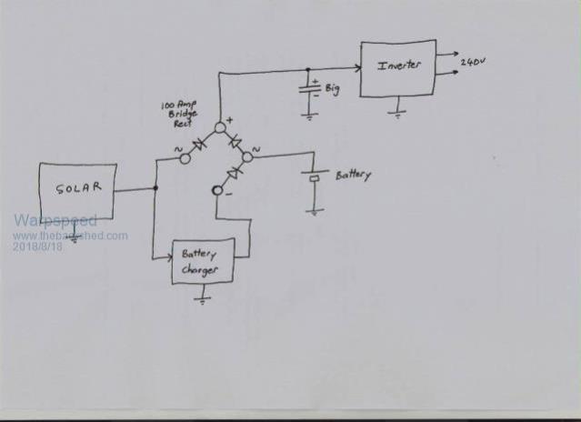

Tony, I was going through Mikes MPPT topic and saw your post
For 48V systems and above
This setup allows for Larger solar Array - smaller battery installation. Given that I use 10kW solar arrays, on a sunny day, this setup will more than double the inverters source current. So when I want to start a compressor, the inverter can source current from the solar array first, then the battery.
The inverter will just have to handle a more dynamic input voltage.
The power loss from the rectifiers during the day is inconsequential.
Obviously this won't suit those who are using GTIs to charge their batteries.
There is a great allure to go for a higher voltage but 48v is benign, its been over 30 years since I've been zapped and I don't fancy a fresh experience - maybe 72 volt wont be too bad.
see crazy youtube on effects of AC and DC Edited by mackoffgrid 2018-12-22
Posted: 07:17am 21 Dec 2018
I still have memories of helping to launch an aluminium power boat in Port Philip Bay. Up to my knees in salt water gripping the hull with one wet had and touching a +12v dc battery terminal with another wet hand. It was a pretty nasty bite !!
So I do have a LOT of respect for dc voltages, but extreme care, awareness, old age, and faith in God, have so far saved me from being fried.
My system operates in a fairly unique mode, and as you say it favors a big solar small battery installation.
As soon as the sun begins to have sufficient strength at dawn, battery discharge falls to zero and it begins to charge the battery, but at a low set limited current. Its set so low, that grey dismal awful days make very little difference.
During the day, the inverter runs straight off the solar panels at voltages up to around 140v. Nothing at all is drawn from the battery during the day.
When any one individual cell of my battery reaches 3.45v the charger shuts off, and stays shut off. My battery sees only a long slow continuous charge during the day, and one long slow continuous discharge at night.
Software detects the 0v from solar at night and resets the charger for another go at dawn.
Minimal battery charging current, and one continuous charge/discharge cycle every 24 hours.
From what I have read, this is the very best way to get maximum battery life from Lithiums by reducing the number of charge/discharge cycles.
Having the more usual tightly coupled solar controller/battery/inverter combination means that some very high currents can be shuffling in and out of the battery during the day. Charging at 80 amps one moment, and discharging at 80 amps a few minutes later cannot be good for the battery.
I hope this very gentle treatment of the battery will result in extended battery life. Its going to take quite a few years to test this theory.Edited by Warpspeed 2018-12-22

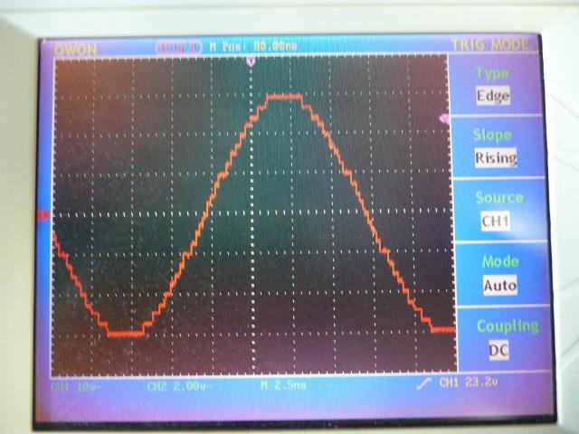

I got the inverter all wired minus the tiny transformer. No smoke escaped, no FETs were harmed :-)
I did find out what the output looks like when the Medium Transform is the wrong polarity - you know I checked all the polarities twice - sheesh.

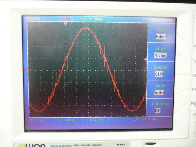

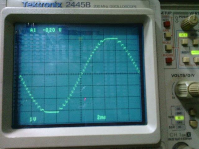

Here's the output of the 3 transformer inverter (I'll now wind the 4th transformer)
The Cro is connected to the output 1Meg / 100k divider.
When the Inverter is running it's load increases by only 10 Watts.
Posted: 09:17am 26 Dec 2018
Yes, Merry Christmas to everyone.
Your idling current is pretty low too, quite comparable to a good PWM inverter.
So a few minutes ago, just for fun, I disconnected my fourth smallest inverter, and shorted out the primary.
This is with a x100 probe poked into the active of the nearest power point.
The rest of the house is still running off this too, including some fairly reactive loads which can introduce extra distortion onto the step edges.
A fairly drastic two stage EMC filter I have on the output also adds a few reactive effects of its own, and visibly slows down the edges.
What you are seeing on yours looks to be just about right. An EMC filter on the output might reduce some of that high frequency fuzz. Not sure what that is, but it could possibly have something to do with oscilloscope grounding, it might not really be there...

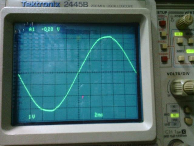

Here it is with the fourth inverter connected back up again, with the same EMC filter on the output. Rather a big difference as you can see. I fully expect that yours should look about the same once you have the little #4 guy running as well, its well worth the extra few parts.
This is what the grid is doing here right now.
Edited by Warpspeed 2018-12-27

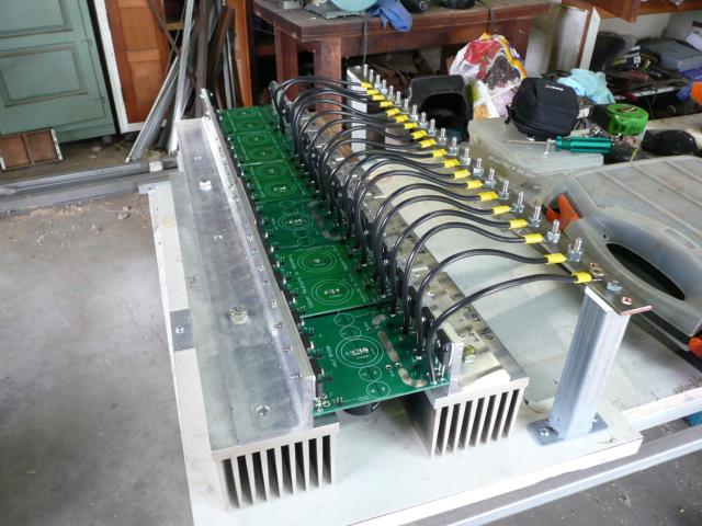

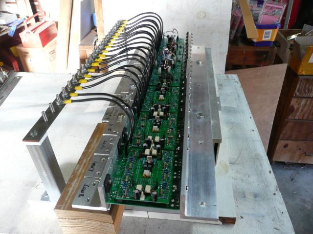

This is my FET_Bridge board setup on it's heat sink. The first transformer is driven by the first 3 boards, which are half bridge + full bridge + half bridge. The rest of the transformers are driven by one full bridge board each.
10,000uF caps (x4, one each on the first 4 boards) are mounted underneath the boards.
The FET boards with their driver boards plugged in.
The Fets driving the 2 smaller transformers shouldn't need big heatsinks so I'm just using the heavy AL angle.

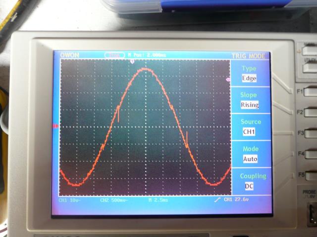

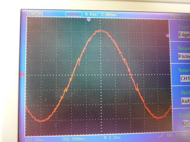

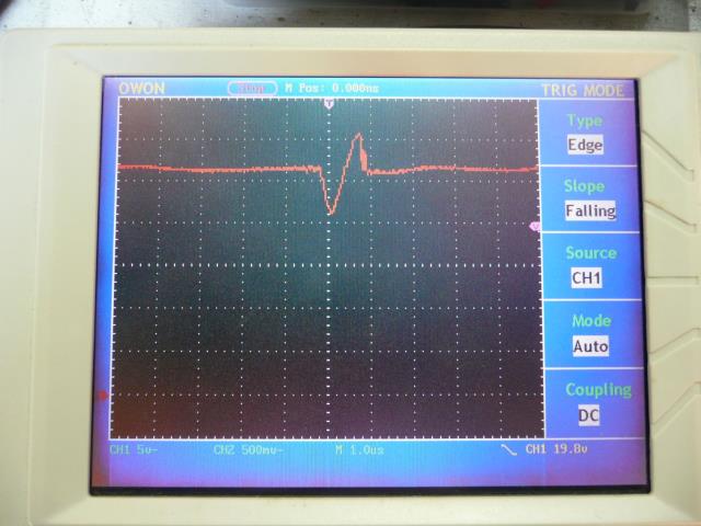

The results was a bit surprising. I'm getting a High Freq ringing that wasn't present in the last test, the main difference are the 10000uF caps on each of the boards, of the 2 bigger transformers.
The following scope shots are using a 10:1 divider.
Previous 3 Tx test - No Caps
4Tx tests - with Caps
No Load
150 Watt Load
550 Watt load
It looks like the switch on of the big transformer is the culprit, I lowered Rg from 100R to 50R - maybe I should put it back.
Tests went well otherwise, the batteries dropped into the 23 volt region but the inverter had no issues.
No Load power of the transformers was only 10 Watts. Nice.
Andrew
Posted: 05:39am 21 Feb 2019
The more I think about this, the more it looks like a power supply impedance problem. What does the +dc power rail look like with that ringing ?
Apart from the spikes (which we will fix) that is a nice smooth sine wave underneath.
That no load power is INCREDIBLE, well done !

Hi Tony, you may well be right.
This is no load.
Rg is now 100R. No difference to the output, maybe worse.
I should do this again with ch2 on the drive signal but this was quite repetitive and I think obviously related to that spike.
I'm amazed at the tidyness of it. One 5v pulse down and one up.
I've had the caps for a couple of years, Rubycon brand, but got them through AliExpress.

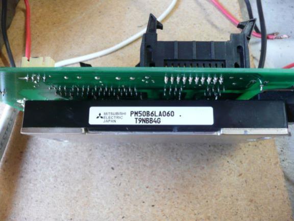

I was going to gun for 6kw-ish (cont) for the 96v beast so I thought I could use 3 modules for the main Tx and one for the 2nd Tx. Plenty of headroom for starting compressors and other workshop equipment (like a car hoist).
The Heatsink is electrically isolated so I could mount all the modules on one heatsink - if they fit.
2019-02-22_161002_pm50b4la060_e___Power_IGBT_module_from_AeroSharp_GTI.pdf
App Note
The reality is that the inverter will run at around 300 to 600 watts most of the time and a couple of hours at 3.6kw for hot water, and summer may go to 1.5kw during the day for Air-cond.
What has your experience been with the extra heat generated by the IGBT's?

Andrew, that is pretty much exactly what I have done. One electrically isolated heatsink for everything.
My experience is that at low power the conduction losses will be just about zero with either mosfets or IGBTs. But it gets a lot more interesting at higher power.
The voltage drop across IGBTs will not typically go much over about 2v no matter how much current there is. So heat dissipation becomes roughly directly proportional to current.
The (I squared R) voltage drop across mosfets will be current squared, so the heat dissipated rises square law with current. If you are pushing really high power that can get pretty high rather quickly.
And it can become fatal for any really high surges or fault currents.
The big old and slow 200 amp half bridge IGBT power blocks I am using are rated for a full 1,000 amps half sinusoid 10mS of fault current. Way beyond anything mosfets could survive. Just about impossible to pull them out of saturation.
Not suitable for PWM though, as they are just not fast enough. But for switching at a few hundred Hz or less they are ideal for an application like ours.

Average power long term probably not much over 200 watts here, but it will run a 2.5Hp air conditioner continuously at 4.8Kw very easily. I really do not have enough solar or battery to run the inverter at that kind of power level for any length of time.
More solar in the future should fix that, but the inverter handles it easily.
If you are going to wind another set of transformers, an electrostatic screen might be worthwhile to block any spikes caused by primary/secondary capacitive coupling.
Pretty sure that is not your problem now, those spikes look a lot higher than the 24v you have on your primary. But screens are some extra insurance when you go to a higher dc input voltage.Edited by Warpspeed 2019-02-23

I have 48v leaf module setup (aiming to operate between 57.5 to 55 volts )
what kink of circuitry should involve the battery charger in Tony's configuration
  mackoffgrid said   Tony, I was going through Mikes MPPT topic and saw your post
Regards kanchana
