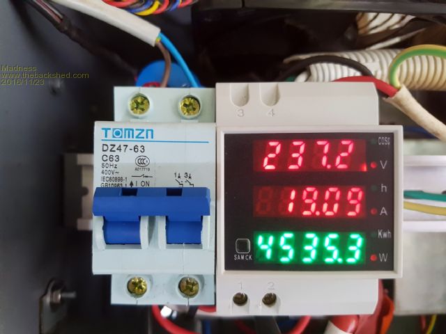

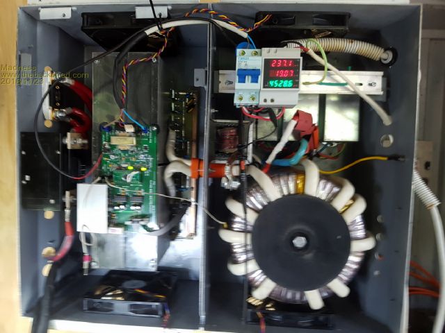

Finally, some success to report, been chasing why the waveform was distorted. I found 1 pad on a MOSFET gate had a partial solder bridge leaving a gap of about 0.5mm. Still not as good as I would like as you will see below but it is running.
Here is how it looks now
As you will see I have changed the primary to 70mm square welding wire which made no difference, I was chasing the cause of bad waveform which is why it was changed.
Here it is under load

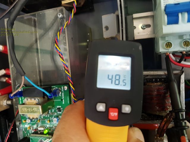

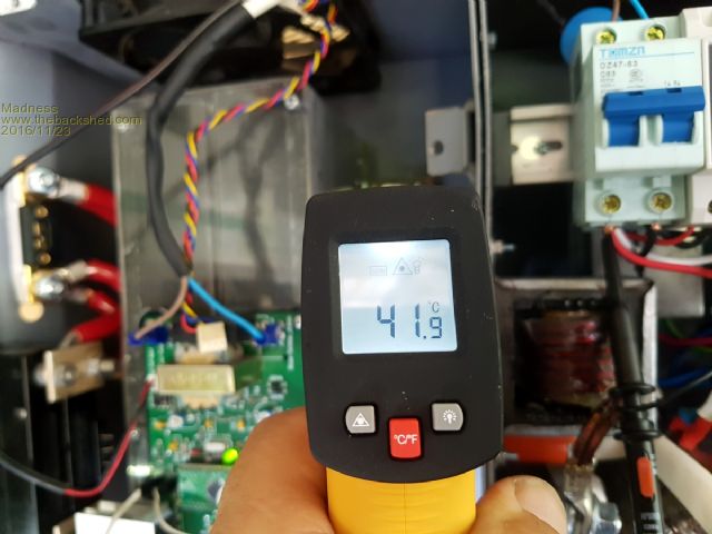

Started out with no fans and ran for over 20 minutes before I temporarily got the 2 fans in the bottom of the case running. Here is temperatures of the FETs and Toroid before I started the fans.

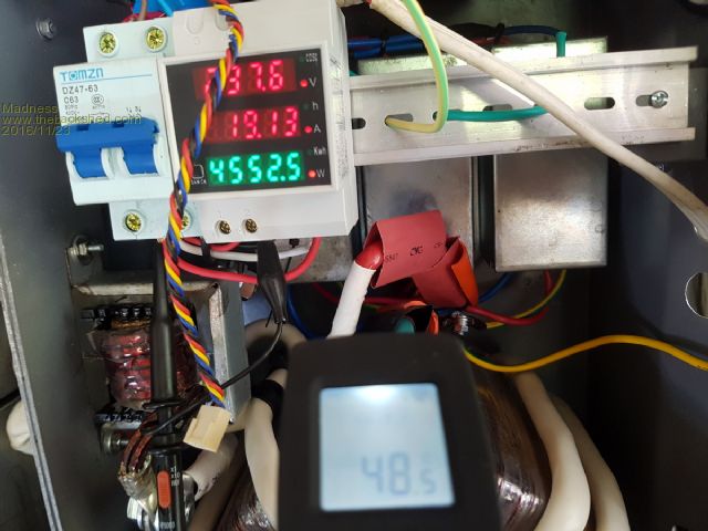

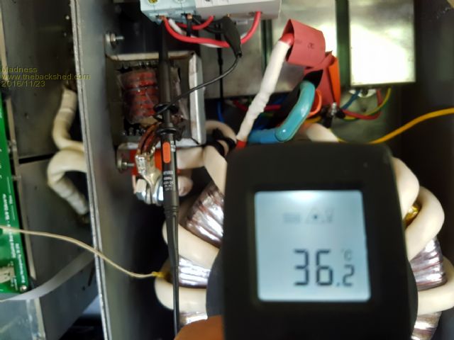

Posted: 03:37pm 22 Nov 2016
After running for half an hour and the fans now on here are the temperatures.

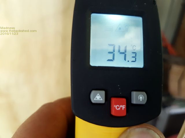

Here is the ambient temperature.
This is with only 2 fans in the bottom running, next stage is to get a fan controller running and make a cover for the front.

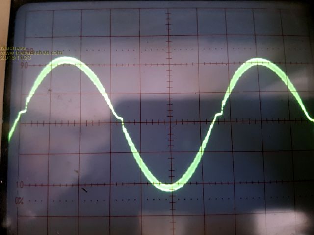

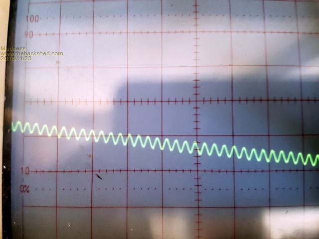

Any opinions on the waveforms would be appreciated, with no load I get very crisp narrow wave with just a tiny bit of a squiggle after crossing zero on the bottom half of the wave. However, a load of 1200W or more give the result here.
This is with 0.1 mS per division, I have tried with 2uf and 5uf caps with no difference.
It is running quite well apart from the waveform concerns, I also have increased the dead time to 1.5uS to reduce the blip at zero crossing.

What was the waveform at standard deadtime before you changed it... better, worse, same ( not the squiggle part... the fluffy part)
You gotta be happy seeing over 4kw for 30 mins or more, and less then 50c with 35 ambient.... I keep forgetting I live in an ice box comparatively, and my heat sinktemp would have only been less than 35c or less on most days.... @ 4kw for that unit.
Lost for the cross over reasons... wondering if it is the gap of the the cores perhaps? did it do it with the single core?.

The wave is the same at standard dead time apart from the blip. I get the same on single core also, the rewound double is very quite now. What is noisy though is the choke, I am wondering if it is causing this. It is super glued together but is it stuck properly in the middle, I have all the bits now to put together another one. So I will try that as soon as I get time (after getting fans working). Yesterday I ordered a 100mm x 65mm x 20mm Ferrite Ring on Aliexpress I see you use them quite a bit, is 3 turns still the best on them?

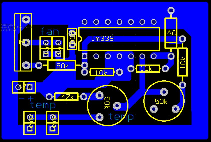

Posted: 09:37pm 25 Nov 2016
Changed the Choke today, it made no difference. Also got 2 temp_fan boards running as well, I put the 4.5KW load back on again today and the fans kicked in after about 5 minutes. They are truly temp_fans though as I will be changing it to the Arduino based controller/data logger when I have that completed.
Took a bit to track down the Temp_fan board so here it is.
2016-11-26_073725_TEMPFAN2_2.pdf
