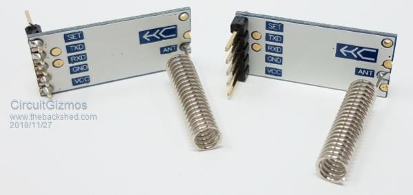

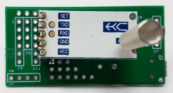

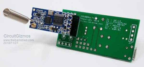

In documenting my CGUSBMULTI module I have some modules with the spiral antenna on the top side of the module, and some with the antenna on the bottom of the module. I don't think that this should make any difference, but I was wondering what Ross/Grogs/others might think of that.
Posts: 10114
Posted: 10:13pm 26 Nov 2018
I'm no RF expert, but I can't see any reason why that should not work. They are sold with those little helicals and that is how you are probably supposed to mount them.
The range might not be as good as it COULD be with the perfect antenna arrangement, but if you obtain the distance you want with any given antenna setup, then it's all good.
From the boards point of view, I don't believe it would make much difference which side the antenna came out - I have some small boards where I have it coming out the end, along the axis of the board (which is mounted vertically)
Most of my applications have the boards inside an enclosure, or metal case, so I use a "real antenna" anyway and use an IPEX->SMA tail.

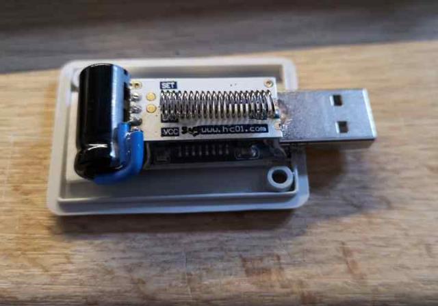

I have dozens of genuine HC-12s with the antenna mounted along the back (space problems). Here is another example in my super-simple USB-433MHz adapter. I know this is far from ideal but they all work just fine so for me it is't a problem.

I see you have a big juicy electro on the power supply pins. Did you fit that, or did the USB dongle come like that?

  Grogster said   I see you have a big juicy electro on the power supply pins. Did you fit that, or did the USB dongle come like that?
I noticed that, and thought "Someone actually read the documentation!"
(It says: "It is recommended that a reservoir capacitor be provided across the power supply of at least 22uF, preferably 1000uF." which seems waaaay overkill to me. A lower value cap of decent ESR should be quite adequate unless you've got a real soggy power supply!)
Posts: 10114
Posted: 11:11pm 27 Nov 2018
I often provide a 100uF 6v3 cap on the HC12's 5v supply, but I have run them with no cap at all, and I have never had any issues....
I always use a 100uF/100n arrangement close to the HC12 power pins if I can possible get it in there - usually I can.
I wonder if there is a typo in the manual - perhaps they meant 22uF - 100uF?

The stack here is very simply a CH340G underneath with the HC-12 mounted on top with hot glue (I know, don't hate me!). As you noted, the PDF warns of big current req's in high power mode so I went for the biggest can I could get in the tiny case. There is also a 100nF in there too but not visible.
Four components to get a PC talking on the 433MHz network and about £5... most expensive part was the case!Edited by CaptainBoing 2018-11-29
