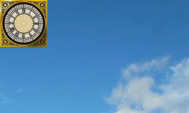

The image is 800 X 480 and yes it could be posted
Thats a shame Phil, WHat I'd like to do with the gui controls is switch between 2 images, that way I can keep the clock on the screen all the time
I'm going to have to figure a different way to do this somehow
Here's the 2 images
and when the button is pressed to go to the 2nd screen it's just this
The clock is the same size and would go in the same place as the clock on the other picture
Edited by lew247 2016-09-03
