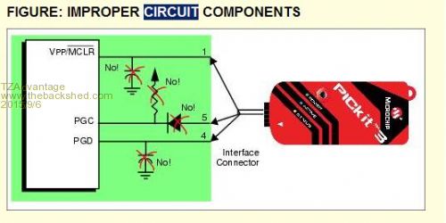

There is one thing i like to add to the part of the discussion about using a supervisory chip or other forms of a delayed startup.
When using a pickkit3 to program a chip 'in circuit' is specifically pointed out by Microchip that no capacitor should be connected to the MCLR pin.
This will cause the pickit3 to not function as a rapidly changing value on that pin will be smoothed out by the capacitor and the critical timing for programming is lost.
When you buy an original pickkit3 it comes with a poster/manual that has this picture on it to show what should not be done.
