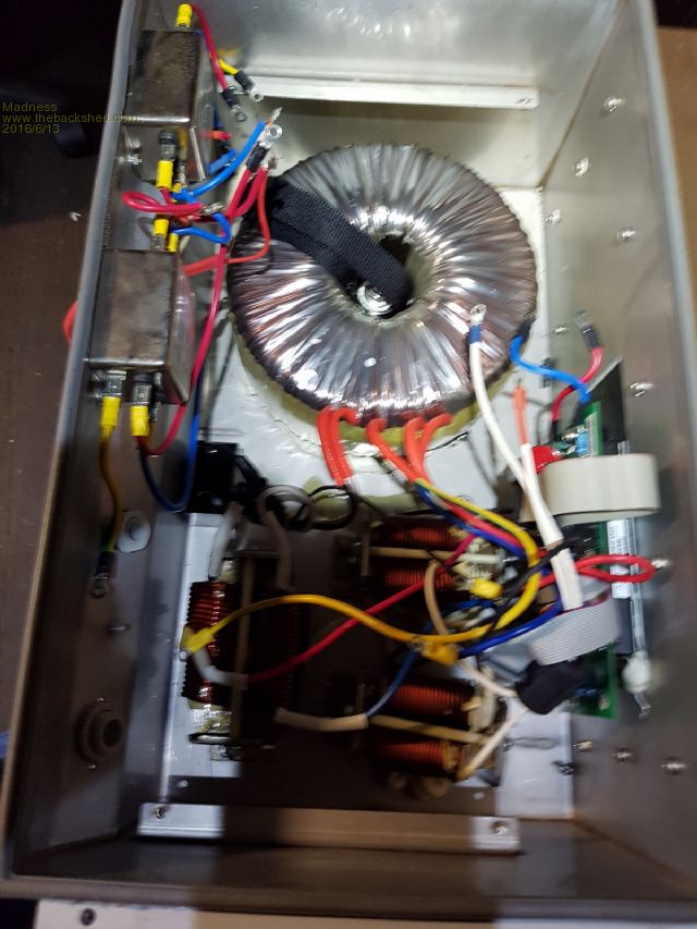

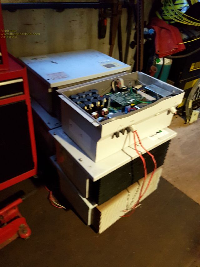

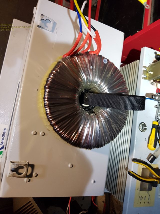

Posted: 10:32pm 12 Jun 2016
After lots of searching and nothing I finally hit the jackpot. Picked up 6 3 KW Aero Sharps today, if anyone is interested there is another 30 where these come from.

Posted: 06:26pm 13 Jun 2016
There is 30 sitting in Brisbane they might freight them they weigh about 45 KG each.Edited by Madness 2016-06-15

Posted: 06:39pm 13 Jun 2016
Just sent you a PM Grogster with contact details, I won't post it online but if anyone wants it just PM me.
They are heavy things, even the heat sink is over 1 KG.Edited by Madness 2016-06-15

If you can get hold of one and get someone to pull the transformer, the weight may become more likely to be normal mail weight.... like 16kg or so.... maybe Mad can weigh his transformer if he has not yet started rewiring it.
Much cheaper than sending the 45kg complete..... although the box is very very nice too....maybe even get the folks selling them to strip and send for a few extra dollars.
