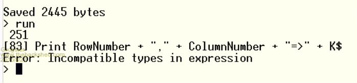

Changed to 511. Result:
As to line numbers, just copy and paste the code into MMEdit for line numbers.

Thanks - which line is printing these numbers???
Sorry - don't have MMEdit on this device
Posted: 02:08am 27 Aug 2015
  WhiteWizzard said   Thanks - which line is printing these numbers???
That should be this line in ScanMatrix$ function:
[code]
if DEBUG = 1 then PRINT ScanCode
[/code]
The empty lines are printed in Main
[code]
print ScanMatrix$()
[/code]

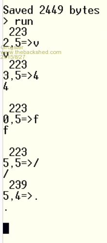

Posted: 02:17am 27 Aug 2015
Result:

Posts: 2998
Posted: 02:18am 27 Aug 2015
str$()
Posts: 2998
Posted: 02:19am 27 Aug 2015
PRINT str$(RowNumber) + "," + str$(ColumnNumber) + "=>" + K$
Posted: 02:20am 27 Aug 2015
Getting close. :)
I had this first:
[code]
PRINT RowNumber","ColumnNumber"=>"K$
[/code]
But found it a bit unclear. Claaning up code introduces error. Well that never happened before. :) :)
Edited by TZAdvantage 2015-08-28
Posts: 2998
Posted: 02:21am 27 Aug 2015
Better still:
PRINT "R:" + str$(RowNumber) + " C:" + str$(ColumnNumber) + " => " + K$
Posts: 10109
Posted: 02:24am 27 Aug 2015
RESULT:
This result is still incorrect - I was typing QWERT.

Now try with Debug=0 (should be quicker!
Posted: 02:28am 27 Aug 2015
Also add a ; otherwise each character will be on a new line.
[code]
print ScanMatrix$();
[/code]
The lookup table has only placeholders for the right characters.
If you see a 'v' that should be a 'q' then find it in the lookup table and change the 'v' into a 'q'. Repeat for all characters.
This will allow many different kinds of keyboards to be used, just need to put in the right values in the lookup table.
If you wired the keyboard as in the latest matrix, then you can use it to fill the lookup table quickly.
Can you also test holding two keys down at the same time. (Only do this when you have diodes in your matrix otherwise you can short two row outputs)

If you were to type eight characters at a time (as per each Lookup string) then TZA's task of populating the matrix becomes easy.
So take the first Lookup characters 'abcdefgh' and press each in turn to show the eight resulting characters.
With all 9 Lookups reported back then TZA can simply put the resulting characters in the correct place in the lookup matrix.
Hope this makes sense . . . .
