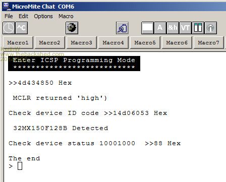

Well JTR0701, now I have found another error. This time within my Xferdata sub. On the third last clock call of this routine TMS should also be 1.
Sub xferdata(st$)
y = Len(st$)
outdata$ =""
clock 0,1
clock 0,0
clock 0,0
outdata$ = Str$(tdo) + outdata$ 'first bit in
For x = y To 2 Step - 1
clock Val(Mid$(st$,x,1)),0 'out
outdata$ = Str$(tdo) + outdata$ 'in
Next x
clock Val(Mid$(st$,1,1)),1 'last bit out ‘******************correct last chr to 1
clock 0,1
clock 0,0
End Sub
And fixing these errors has corrected an anomaly that had concerned me. I had found that I must call Setmode again between reading the ID and reading the Status to return the correct status. I had tried swapping the two operations but the second still did not work without a preceding Setmode command.Correct code to be: -
Print : Print " Do not recognize chip"
EndIf
Print : Print "Check device status ";
I am happier now.

Hi all,
I'm back in internet coverage again and trying to catch up on where we left off.
I had been having trouble getting the 'check device status' and 'chip erase' functions to work. The penny dropped the night I arrived in the outback (no internet). In a previous version of my code, I had declared TMS (I think it was) as both a local and a global variable, with the value being declared in the local, but the value in the 'clock' routine coming from the global version, consequently, the value of TMS was incorrect. When I split up the functions and declared a global TMS, I forgot to delete the local TMS. Such a simple thing...
Having corrected that bug, the status byte came back as it should and also, the chip performed the erase function ok (the programme I had in the target vanished)as well as the status was still correct. I have to wait till I get home in a few days to read the 'erased' chip with the pickit3 (forgot to take it with me).
I think we may even be able to 'download' the Programme Executive that appears in the programming data sheet we have been working from. Translating the 'C' code for PE to MMbasic might cause a bit of brain ache, but I am becoming more confident that we can get there.
At least now, I can 'chip' in again.
