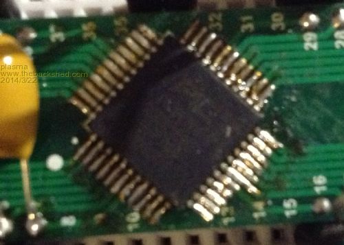

whitewizzard , this is a rocksolid peace of technik , id like to say thank you for this.
the soldering dosnt look like pro , it is professinal !
the package , the boards and the full assembled sample are worth every cent .

Yes, I agree with you, plasma. The soldering really is so good, I was fully convinced that he must have had them assembled by a factory, but he assures me and others here on the forums, that he did it himself.
WhiteWizzard - you need to start a topic on this, so others can see how you did it - time permitting, naturally...
In the boards he sent me, I was still able to read the part numbers on the chips with the aid of a strong LED light at the right angle, and a magnifying monocle. But he's not grinding off the part numbers or anything.

my "soldering"

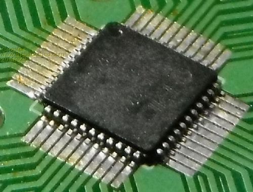

Here is a photo of a QFP I soldered up using very fine solder and flux-gel:
It's OK, but nothing fantastic. It took me about an hour to get right, primarily as I was concentrating very hard on not bridging any pins.

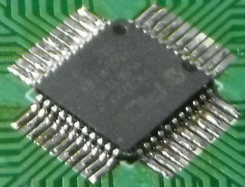

Now here is the same board soldered by me, using the WW method:
This one took about 5 minutes all up so, it really DOES work!

just a word of caution - you might want to leave just a little more solder behind, in case a slightly raised pin is left disconnected. i used to always have a fine sewing needle to hand, and would run the point along the rows of pins; a pin that was not soldered down would produce a more 'dull' ping than the rest.

a trick that arose out of many not-fully-soldered pins being missed! i'd estimate that i've probably soldered over 100 quad packs myself, most using methods similar to those outlined here. plus quite a few FFC connectors and a fair number of CF sockets too, not to mention a thousand or so 0402 resistors and capacitors. oh, the joys of working as an R&D engineer building short prototype runs.

The two photos he posted (on page 11 of this thread) show what he achieved on a 'practice' piece of board.
The top photo was the pin-by-pin method which took him about an hour to complete - all BEFORE he learnt my method.
The bottom photo shows his FIRST attempt using my method (after only some guidance via several PMs). This took him around 5 minutes.
Note that NO cleaner has been used in the bottom photo as he didn't have any at hand. If you look closely you can see some brownish markings which would not be there once cleaned.
Overall a fantastic and impressive result for his first attempt.
