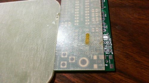

Posted: 12:57am 25 Mar 2014
Good morning Mik..!
Hey, what seemed to help me ALOT is the "fitting jig" I created for the DFN part. Using a square to hold the board on one side and the first part of the jig on the other to keep the board at 90 degree angles. then, the second part to the jig, the very thin piece, is used to bring the reference distance exactly to the wall edge of the DFN part. From there, you just make sure to position the part evenly between the SMD pads and tape it down. I also have a very thin roll of PCB tape to hold the part in place while soldering the pads. If you don't use the jig to hold the part at exactly 90 degrees, the other side would be slightly off-angle and would miss the pad layouts just enough to muff the whole thing up..! I could send you the jig parts and tape along with the order to help you get the DFN's fitted to the PCB...
For me, without using the jig, this task would have been impossible..!! The Pix does not show the square on the other side as I left the tool at work... But, you get the idea...Edited by Zonker 2014-03-26
