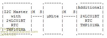

  Frank N. Furter said  would it be possible to activate simultaneous the second I2C-port (Pin6/7) on the MicroMite?
It would be a great expansion to use the 然ite as Slave with simultaneous connected I2C-devices as master on it.
It would be possible to use the 然ite as I2C-expander with simultaneous I2C-EEprom, I2C-Clock and so one on it.
I thought about that but the I2C in the 然ite can be a slave and a master at the same time, so I could not see the need for a second I2C bus.

Hi Geoff,
thats not completely correct! If you have I2C-devices with a fixed adress (not jumperable)on the bus (like some EEproms, temperature sensors or realtime-clocks), then you can use only one on the bus. But when the 然ite has it's own I2C-bus you can use the same devices additional on the 然ite at the same time!
I have very often this problem at work! The additional benefit is that you can drive more devices (bus capacity) with a longer wire!

I would also really welcome a second I2C.
The possibilities to use the uMite would increase a lot.
Not only you have the benefit of a master and slave at the same time, but also different speeds, like on a long wire you would choose the slow devices and on the short wire high speed devices.
Both need different pullups to work the best in combination with power consumption.
Less bus collisions (when using slow and fast devices).
The situation Frank subscribes is a very desirable one and because not many other chips/mcu platforms offer it unfortunately not a common one, or difficult to achieve.

I don't understand since the 24LC01 has three address pins so you can set a unique address for up to 8 EEPROMs on the same bus.

Hi,
thats the reason why this chip was in my last company on the blacklist!
Take a look on the datasheet "http://ww1.microchip.com/downloads/en/DeviceDoc/21711J.pdf" , page 5, chapter 2.1: "The A0, A1 and A2 pins are not used by the 24XX01."
YOU CAN ONLY USE ONE CHIP ON THE SAME BUS, NOT EIGHT!
...many developers stumbled over this point in our company, many designs doesn't worked therefore...
Frank

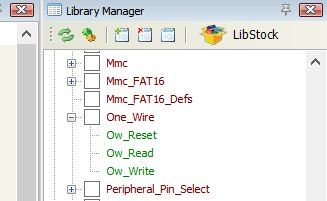

Go for it! A good practice for a new project is to connect the temperature sensors one by one as single and unique sensor on a bus to find out it's ID. Then you can remove it from the bus and label the sensor and connect the next one, and so on. Then, you can know which sensor is in which place.
Let the search function for the aliens of the future, when they will try to activate some old terran tech buried into ruins...
Mikroelektronika provides only three functions in their One_Wire library for all their compilers (mikroC, mikroPascal, mikroBasic), no matter the target (PIC, dsPIC, PIC32, AVR, ARM, etc.). I would expected much more from them.
And a piece of their code sample (sorry, I don't have mikroBasic installed):
