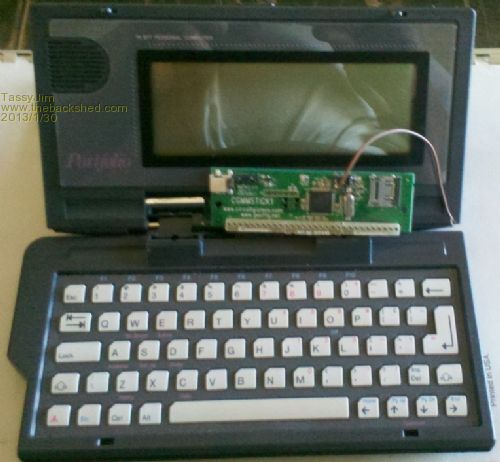

All this talk about old computers sent me to the shed where I unearthed an Atari Portfolio.
The Portfolio has been described as the first handheld PC.
Unfortunately (or fortunately in this case), mine has stopped working so I can give it a face lift.
There is room inside for a UBW32 or maybe one of the boards being discussed here.
The keyboard is a simple 8 X 8 matrix so I am thinking of a picaxe to read the keyboard and emulate a PS2 keyboard or serial.
I could also use the Maximite to do it all.
The display uses proprietary software and rather than trying to work it out (most likely not achievable), I am going to fit a 20 X 4 line LCD.
The photo shows the PC with a CGMMSTICK1 sitting on top.

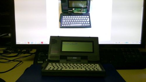

  TassyJim said   All this talk about old computers sent me to the shed where I unearthed an Atari Portfolio.
Aaah! It's good to see that there are other people who collect such precious old equipment. I also have an Atari Portfolio.
I could never get mine to interface with an ATM machine like the one used in Terminator 2. Maybe once you get the MM running in the Portfolio case you could give it a try
My favourite is a Sharp PC3100 which came with a bigger screen and a serial and parallel cable. If I didn't have a Maximite, I'd consider using it as a controller. Unfortunately, it's very hard on batteries. The HP handhelds (of which I have quite a few) were much more economical.
By the way, if you have any old 16MB and 32MB (that's MB, not GB!) compact flash cards, don't throw them away. They're still useful for the DOS based handhelds that have PCMCIA slots. A PCMCIA converter will allow CF cards to be seen as hard drives.
Here's a photo of my powered-up Atari. It makes you appreciate the difference in screen sizes these days :)
My mind is aglow with whirling, transient nodes of thought careening through a cosmic vapor of invention.

  TassyJim said   The Portfolio has been described as the first handheld PC.
the display uses an 8-bit wide interface, and contains a standard HD44780 style controller that works just the same as the cheap 16x2 displays available on ebay and elsewhere. years ago i played around with some portfolios for a bit, which included much repair work and talking directly to the hardware.
the plastic bezel over the screen peels back, revealing two screws. remove these and the LCD housing can be split in two, revealing the internals. replacing the flex between the screen and the body of the machines was often necessary, and it is possible to connect up a piece of ribbon cable with relative ease.
the keyboard is more problematic, as the flex used tends to crack near where it emerges. i did briefly consider making replacement keyboards using metal domes on a PCB, but never got that far.
i have a box of portfolios somewhere in the shed!

As well as Ctrl and Alt, the Atari uses a function key to give F1 etc. There is also an 'Atari' key (AKA Windows key) that can be used.
It might be the simple sticky keys method (remember the key pressed if it's a special key) or scan for multiple keys pressed. It depends on the layout of the matrix and the mood I am in at the time.
Posted: 06:55pm 29 Jan 2013
That's useful information. I will investigate further.

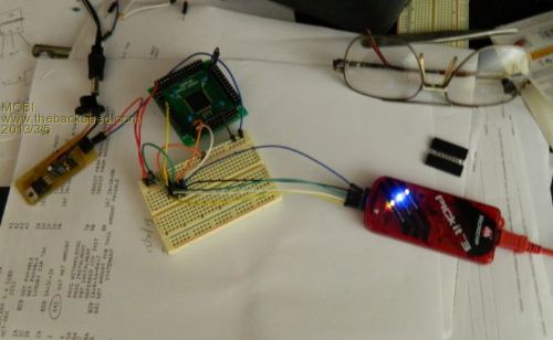

Posted: 10:34pm 04 Mar 2013
Hi all,
It has been a while since I tackled this. I damaged a couple of tracks on my home grown breakout board (TQFP100) and unfortunately, they were power supply. Meanwhile, I had ordered a couple of double sided TQFP100 boards from ebay, so instead of trying to repair my home grown board or building a new one, I decided to solder a PIC32(100) to one of the new boards.
They were just breakout only and didn't have any other wiring except provision for 4 capacitors. So, with the aid of "little blue wires" and stereo vision glasses (vital at 64)I wired up the power supply pins with 104 caps x 7 and the VCAP 10uF tanalum.
Plugged the appropriate headers to bread board, hooked up the PICkit3 and plugged in the 3.3 reg PS (from Nokia dispaly days) and switched things on. Nothing got warm - good start. Selected the 795 PIC32 - so far all happy still.
Flashed up MPLAB IPE and imported the MM hex file. Everything showed that all systems go, so connected ok and tried a blank check - not blank, so did erase - happy with that and now blank check ok. Tried to execute programme but the device ID doesn't match!! proceed? Y/N - selected Y - chip programmed and verified.
Bet you thought I had problems coming! Well, maybe I do. The next thing to do is wire up SD card and whatever else I might need - maybe the USB so I can try the boot loader. I'll keep you posted on results. Did anyone else get further than this stage?
David M.

Hi Mobi,
  MOBI said   Selected the 795 PIC32 - so far all happy still.
There are two types (well that I know of there may be more) of `795
The 100 pin is
PIC32MX795F512L
the 64pin is
PIC32MX795F512H
Did you select the correct `795?

  Mick said  Did you select the correct `795?
Yes, pretty sure I did, but maybe not, the eyesight is not as good as it should be. In any case, it didn't matter too much I don't think as the MPLAB let me ignore the device ID.
I'll do another one after I rework my home grown breakout board to include power, decoupling and xtal.
Meanwhile, I see if I can get the current one working as an MM. I suppose just because it programmed the firmware ok doesn't mean that the unit will work. We'll see.
ps. an after thought, I could try and re programme it as it is still all hooked up.??

Just did a reload of the MPLAB IPE and it was still set up for the 100 pin chip, so I did an erase and programme + verify and all went well this time. Maybe the IPE also resets the device ID to the correct one.
The chips I got came from Portugal and were not blank (I had to erase first - unless all new PIC32s need it?, I would not think so but???) Maybe they had been previously programmed?? Who knows when you buy cheap on ebay.
David M.
