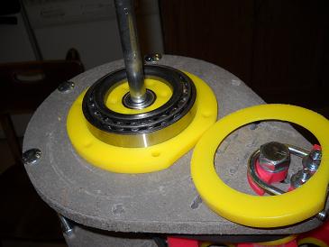

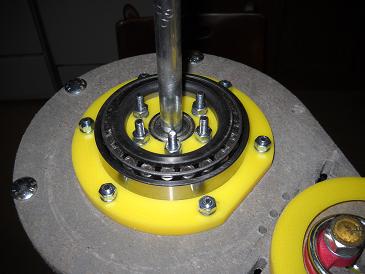

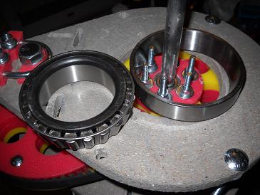

photos of bearing mount

yahoo2
Joined: 05/04/2011
Posts: 1166
Posted: 03:13pm 14 Nov 2011

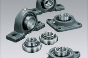

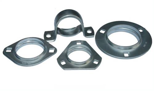

I was hoping you just had that tapered roller laying around and didn't buy it. I can see that it is a convenient quick fix to prove a concept on a prototype because the inside diameter fits the hub on the generator shaft.
there are some major drawbacks in using tapered roller bearings in wind turbines that can result in high failure rates. Poor preloading technique is very common.
When the time comes for a working version, spherical bearings with lock collars and pressed steel or cast housings are the most practical, cheap and tough option.
I would encourage you to have a play with some so you can see the potential, they are a joy to work with.

Posted: 03:36pm 14 Nov 2011
Hi, the bearing was the only one I could find that was large enough. There is no real preload, the race fit’s the bottom mount, the roller bearing just sit on top with a grease cap and the blade rotor holds it all together. I have the bearing mounted and manual inspection shows improvement. Road test in the near future. I will continue to search for a better solution. Thanks for the info, enjoy the day.

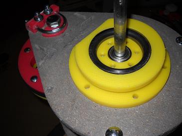

Posted: 04:42pm 14 Nov 2011

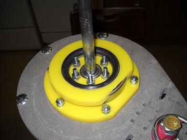

Hi, the blade rotors are mounted using bearing and transfer energy to the belt drive using the bolt ends extending upward located near the center. Using a lager ID bearing as shown is the only solution that I could think of that will still work with what is there.
photo of completed assembly

Posted: 03:42pm 15 Nov 2011
Hi, results of today’s road:
MPH_____DC Amps_______using 12 volt deep cell as test load
10_______0.15
15_______0.5
20_______1.0
25_______3.0
30_______4.0
35_______5.0
The added top bearing made all the difference. The belt did not skip. I tighten the belt and ran the test again and the added bearing load greatly reduced the output. I have to find the ideal belt tension. Today’s test also showed the that belt drive ratio is to high for the blade size and design being used and was creating a stall condition. Comments welcome

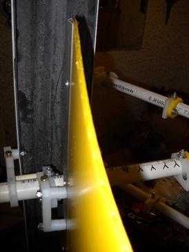

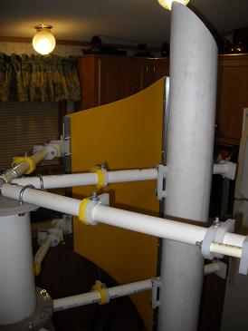

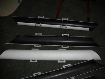

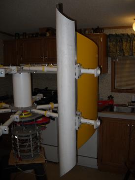

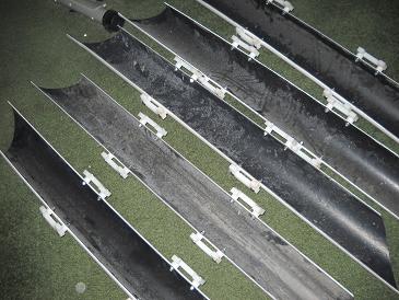

Posted: 01:28pm 18 Nov 2011
The core structure allows the scoop to be positioned as Lenz, C rotor, or internal J style.
new blade photos
Rastus
Joined: 29/10/2010
Posts: 301
Posted: 01:41pm 18 Nov 2011
Hi Go Vertical,
Have you matched the new blades to the present ratio,or reduced the step up ratio as well.Cheers Rastus
