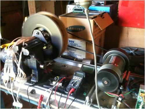

For those waiting for some figures, I've been a bit too busy. At a glance, its good for 150 watts at 500RPM.
I've built a test setup using a treadmill motor and speed controller, and its got enough power to drive the alternator. My problem is accurately measuring RPM without spending too much money. I have a couple of CRO's, but these are not much good at quickly measuring frequency. I had a Hz function on my multimeter, but its no longer working. I have a frequency meter but it wont settle down, there too much RF from the stator ( diode switching ). I have a Oatley K117 optical Tacho, but it needs calibration/repair and Oatley no longer sell the kit, so I cant find a copy of the PDF anywhere.
I do have a Maximite, but I dont have the time just now to write a quick program and build a interface.
Its end of month, so I got a bit of work to do and invoices to post out, give me a few days and I'll see what I can come up with to measure frequency/rpm
Posted: 04:17am 03 Sep 2011
Stuff it, had to go give me-self an idea didn't I.

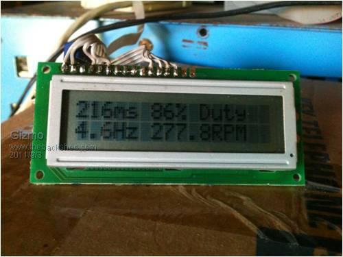

I wrote a little program for the Maximite computer to act as a tacho. The Oatley K117 kit does partly work, the optics and trigger circuits, a LED flases as a bit of tape stuck to the alternator passes the optic sensor. Good. So I connected the LED wires to a optocoupler attached to a Maximite. Then I wrote a program to time the LED on and off states, and display the results on a LCD display.
It displays total cycle ( 1 revolution ) duration in miliseconds, the duty cycle in percent, the frequency in Hz and the RPM. The information is updated each revolution of the alternator. Works GREAT
This is the test setup, sorry about the poor image quality.
Its good to get a win occasionally
Now I can go and take some readings. I'll post a thread about the tacho software and circuit in the microcontroller section in a day or two.

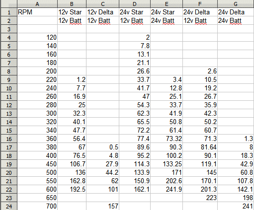

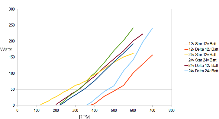

Some figures
I think it would work best as a 24v alternator, that is 24v Star 24v Battery, with a high speed set of blades. It makes 170 watts at 500 RPM, and you could see closer to 250 or more in strong winds.
Edited by Gizmo 2011-09-06
Looks like it would be a good match for a 1.5 meter three blade rotor. Of if you wanted to get a little more swept area and still get the required speed you could use a 1.7 or 1.8 meter two blade rotor to drive it.

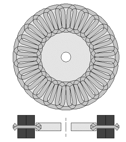

Posted: 10:43pm 05 Sep 2011
Thanks Bob, but unfortunately it will be like 6 months to a year before I have a place to fly it.
Besides, I've had a rethink, and I want to make another stator. The standard side by side coil arrangement is OK for Neo magnets and flat stator moulds, but I have weak ceramics and the tools to make a stepped mould. And someone made the comment about "empty space", and he's right, there is a lot of empty space where a magnet is passing over the stator, inside the coils, and there is nothing in the magnet flux path.
Overlapping coils is the solution. It ensures the magnets are always passing over copper and generating power. But it means the stator has to be thicker in parts so the coil bundles can pass over eachother. I can do that, with a bit of CAD work to get everything positioned correctly and the CNC to cut it out.
It also means I have 8 coils per phase instead of 4, 24 coils total. Since I have twice the number of coils, they only need half the turns to reach the sme voltage, 70 turns instead of 140. 70 turns will fit into a smaller space, so I can make the stator thinner, down to 6mm thick. That means I can brings the magnet plates closer, 8mm apart instead of 14mm. That gives a more intense magnet field, increases the volts per turn, and I only need 55 turns per coil.
So I've got more copper under magnets, and my coil resistance will be lower, which should mean more power.
Back to the workshop.

HI GLEN
Looks a bit complex for an old bugger like me, I would be putting two more magnets per group to get better spread or using the 50 x 50 x 20 as Hugh got for his, reason being that when you get all those coils in there it will reduce the strength of the stator considerably, unless you use the outside as the main reinforcement and that would mean more air gap and reduced output again.
Anyway all sounds like good fun.
I already built one of those with 50 x 50 x 25 mm ferrites - a 12 pole 36 coil. It didn't make any more power than the flat 16/12 or 12/9 arrangement.
Just because these ferrite magnets are weak doesn't mean you can't make power with them. You have to think outside the box a bit and forget all the "conventional" designs. Keeping the air gap very tight is important and it's easiest to get the air gap tight with a flat coil arrangement.
Because you have to use more turns of wire with the ferrites, putting more coils in series helps get the voltage, hence the reason I used dual single phase stators stacked and skewed 90 electrical degrees to build a two-phase machine.
To get the internal resistance down you have to forget using the wye configuration and use either delta or IRP, and wind with big wire. Hugh and I disagree on this, but I"m the only person who has ever built a solid 1.8 kW ferrite axial generator for a homebrew turbine. Hugh likes the wye configuration. But after I tried four different configurations of it, I arrived at the conclusion that if you're going to build a polyphase ferrite generator all contained in one stator, and get output comparable to a neo, it's going to be one bloody big and heavy unit.
The output of an air gap axial is determined by only two things - rpm/volt and internal resistance. If you want more power you have to reduce one or both of those.
If you put the pencil to it and do some figuring, you only got so much flux density in the air gap and adding more coils in series to build an overlapped coil stator helps get the voltage with less turns. But the extra distance in coil interconnects eats up any perceived advantage over the flat arrangement. You actually end up using more wire per phase when you go to the overlapped coil design than you do with the flat. Hugh and I had an extensive discussion over this when I did it, and Hugh had long suspected that was the case. But I proved it when I built I the thing.
I also tried a 10 pole 20 coil two phase unit in one stator. I ran into an immediate problem with that configuration - I couldn't get big enough wire in it and keep the stator thickness down to 12-13 mm.
In the end I ended up with the dual stator unit. It makes the target 60 amps @ 30 volts in a 78.8 lb (35.7 kg) package. To achieve that output (same internal resistance and rpm/volt) in one stator would've yielded a generator almost 3x the weight and about 2.5x the size. And once you start increasing the size, the runout tolerances on the rotors have to be increased, meaning you'll have to run a wider air gap to prevent stator/rotor contact in real world operation.
You can machine rotors +/- .04mm, set a tight air gap and bench test it and it will work fine. Put it on a turbine and it'll hit the stator and damage it. BTDT. So I allow at least 2.5 mm clearance between the magnet faces and the stator on 280mm rotors to prevent contact in real world operation because things flex under tremendous loads at high output on the turbine. The bigger the rotors, the more tolerance you have to allow. The more tolerance you allow for axial runout, the more wire you have to add to compensate for reduced flux density with the ferrites. It's a vicious circle.
At any rate, really good project, Glenn! I look forward to more of your testing results.

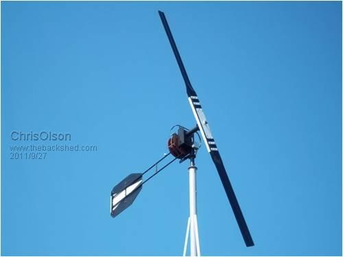

Yes, I know we tend to disagree on this somewhat. But that's OK because different viewpoints many times yield results that are better for one situation and maybe not as good for another.
When I built that ferrite generator (I've actually built two more in the mean time) one of the criteria was to get it to fit on my present geared turbine frames. The larger diameter of the single stator unit would have required a re-design of the frame and gearbox.
We are now back into our windy season here, and today for instance, we had the usual 10-13 m/s wind all day and it has died down to 5-6 m/s during the night time hours. I didn't feel the 12G turbine was utilizing that ferrite generator to its full potential so I designed a new turbine for it.
The 13G is a 4.0 meter machine with a two-blade rotor. It uses the same gearbox as the 12G, and the same ferrite magnet, 10 pole two-phase generator, although I used 48 turns of 12 AWG wire in both stators on the subsequent two ferrite units I have built for the 13G design. The two blade rotor is harder to steer so the tail boom is 40 cm longer, although I used the same feather on the tail as the 12G so I did not increase the area of the tail feather itself. See attached photo of the 13G machine below.
The two blade rotor of the 13G runs at very high TSR (8.0 @ 5 m/sec as compared to the 12G's three blade (and experimental four blade rotor I was running on them), and it furls at TSR 7 @ 12 m/s running at 400 rpm, which is about 50 rpm faster than the 12G runs. It has a .4375 gear ratio, so the generator is running slightly over 900 rpm at furling speed.
The result is dramatically more power across the board from basically cut-in to full power. The pictured machine ran between 50-70 amps (24 volt system) for over 14 hours today and it's now down to about 15-20 amps during the night time hours. With three of them running it's holding our battery bank at 26.0-26.5 volts. I am not running my Jacobs turbine tonight because we do not need the power from it. And when we go to bed and turn everything off I'll probably shut down two more of the turbines and just use one 13G to keep the bank up over night.
To push those kinds of amps continuous with a single stator is a challenge. You have to use parallel windings (two or more in-hand) to do it. With the dual stator I wind with just one strand of wire which yields more compact and tighter coils that do not vibrate. With parallel windings you introduce the possibility of harmonics in the winding due to coils not being perfectly matched and resulting "circulating currents" even in wye windings. That problem is non-existent with the dual stator design. The dual stator design has lower mass in the rotating assembly, which allows the turbine rotor to accelerate faster and take advantage of wind gusts. A heavy rotating assembly that takes too much time to come up to speed when the wind speed increases loses out on power production - it all adds up on the kWh meter.
So I approach the problem from perhaps a different standpoint. I do not care as much about how many magnets I use as I do about flat-out high performance. If you approach the problem strictly from a materials use standpoint, then the single stator design perhaps wins out. But to build a high capacity, high amp generator I still think that's debatable.
Chris
