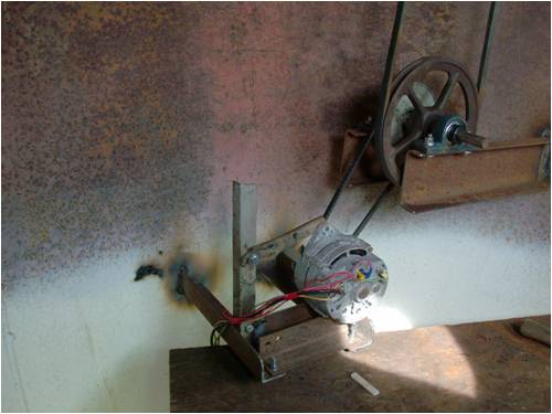

Posted: 11:59pm 03 Jun 2011
Hey Everyone, this is a picture of the drive system includeing the alternator. I believe this is a 65 amp model.
You can't believe how tempting it is to unbolt the parking clamps...and give her the first try. I've got the wind, but no breaks, so its a no go for today.
I'm really getting the itch to give it a try.
Now, as Gizmo stated in an earlyer post, "I'm getting as nervous as a frog in a blender". (Getting so close to running).
Tune in again tomorrow, thanks for visiting.
....Mac46
I'm just a farmer

I researched the "GM alternator" last evening...I have the alternator set up to turn backward, I'm going to have to fix that. Also, the paticular model is rated at 63 amp max. output, not 65 amp. that I posted earlyer.
I have the break to install, the cluch linkage, batteries, wireing, ect. ect. so I still have a fair amount of work ahead of me yet.
The gearing ratio,"for those of you who are wondering", is 7.2 to 1 , my best guess at the moment, I don't know how well the wings will perform. This is likely to be geared alittle "tall", and I anticipate adjustments will be needed. I've read that it takes 1 hp. to generate 20 amps-12 volt, (approximately). I can sit here and speculate all day, but it won't get me any closer to produceing power, and will just waste our time.
