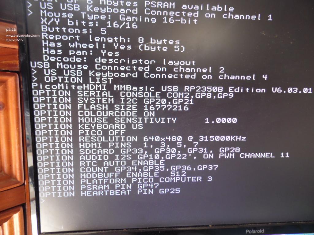

G'day Palcal,
Have you tried setting OPTION MOUSE SENSITIVITY 1 in your option list, this often solves mouse related problems.
Bit odd seeing the keyboard twice, this may be an issue. Can you please post your option list and make / model of the keyboard / mouse you are using? someone may have seen this before.
Regards, Lyle.
palcal
Joined: 12/10/2011
Posts: 2054
Posted: 05:03am 15 Aug 2026
Thanks Lyle, OPTION MOUSE SENSITIVITY ONE seems to have fixed the mouse problem but still says Keyboard connected to Chanel 1 and Chanel 4
I tried 2 keyboards a Microsoft and a HP. If I disconnect and reconnect the keyboard it says KEYBOARD CONNECTED TO CHANEL 1 so it all works ok but I don't know why it also says Keyboard connected to chanel 4 on reboot.

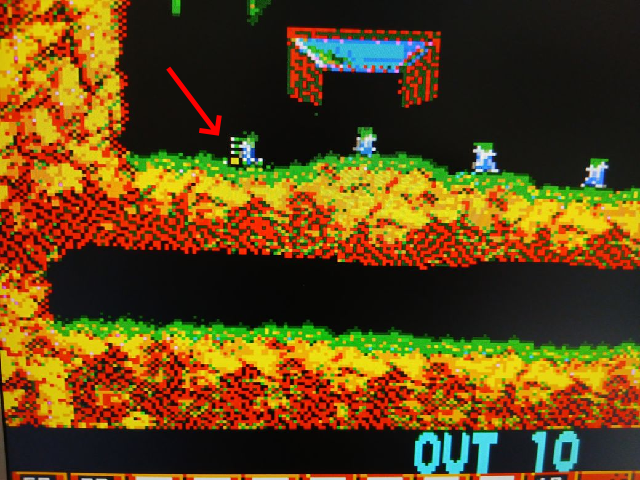

I may have missed something here, but is it common knowledge that the Pico Computer 3 swaps layers N and L?
To explain: The crosshair are drawn on Layer L, so it should be in front of the background.(which is exactly what it does on the Picomite HDMI with the same firmware)
As you can see from the example, it disappears behind the landscape on Layer N
in addition:
Mode 3 & 4 are not available in this resolution
Edited 2026-09-10 20:08 by Martin H.

  Quote  I may have missed something here, but is it common knowledge that the Pico Computer 3 swaps layers N and L?
TBH, I cannot imagine how the hardware should swap the layers .... I thought they are implemented in the firmware. Do you have an explanation for me?
Gerald
73 de OE1HGA, Gerald
Posts: 9328
Posted: 10:55am 10 Sep 2026
Nope, that has to be a firmware or software thing. The hardware consists of only resistors and a socket no matter whether it's VGA or HDMI. Mess up any of those connections and something won't work or will mess up the colours.
