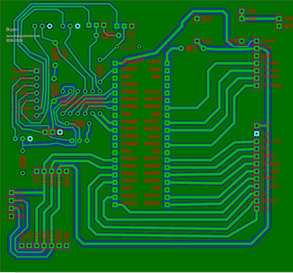

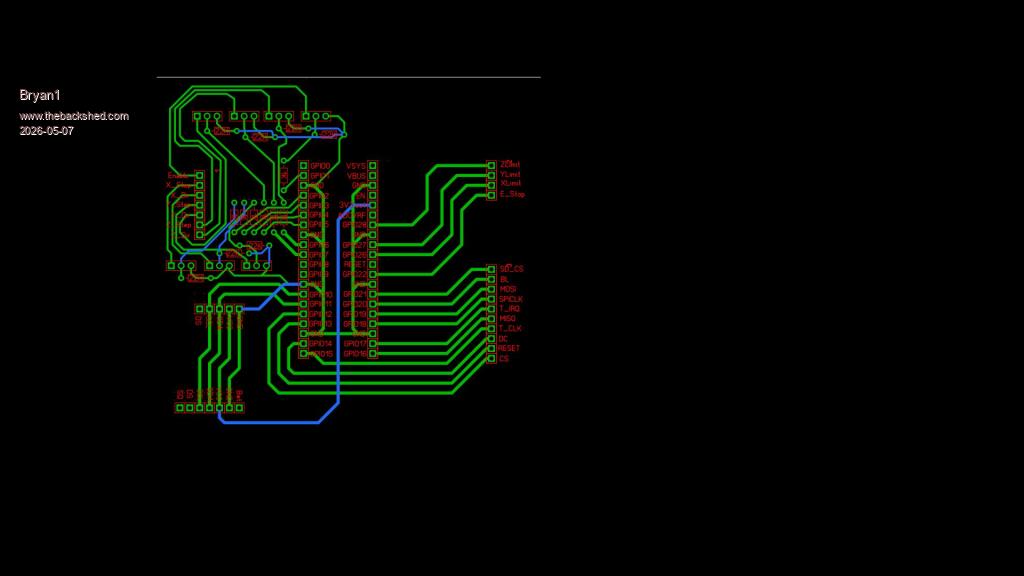

Just having a play in Sprint Layout and I had to make a macros for the pico 2 footprint then got do the first draft, still got the power to sort out and it will fit on a 100x100 board too
Now this is done with Lyles suggestion of the pin layout, just tested my old microbridge and it still works   so yet another connector to go so the board will have the console.
Getting there and most of all having fun...
Now I deleted that first picture as silly me forgot to put in Lyle's suggestion of the transistor circuit so it's now there.

              Well as it has been a couple of years since I used Sprint Layout it was fun yesterday and now I feel I do have that bug   and the grey cells are starting to come back so this first draft is just the start.
Off memory with a double sided board I do need to put via's in and reading the pico manual yesterday a sckotty diode to Vbus can be used for the power input. Now with the I2C lines as I'm famous for getting it wrong SDA on the RTC does go to the SDA on the pico right ?
With my design for this project the LCD won't be connected to the PCB and it will be put in a small case and mounted in a suitable place for easy viewing.
Also with the first draft I almost got it all single sided so my goal today is to try and keep it single sided then I could even just mill the board on my CNC.
Anyway the first caffine hasn't hit the sides   so more thinking and pondering to do.
Lyle thanks for the offer of one of those silly chip boards but my motto has always been if I want something just make it myself and in these later years if it can go wrong it will go wrong   Just look at my inverter project for an example anyway yesterday I did see that inverter hit 50Kw/hour   When all the lights are turned off the it sits on 5-6 watts and with those 3 off 330 watts panels leaning on the side of my shed the shed battery SG is rarely below 1240
Later today after I have another play in Sprint Layout I will zip up the file and post it on here so all the Sprint Layout guru's can have a good laugh at my efforts
Regards Bryan

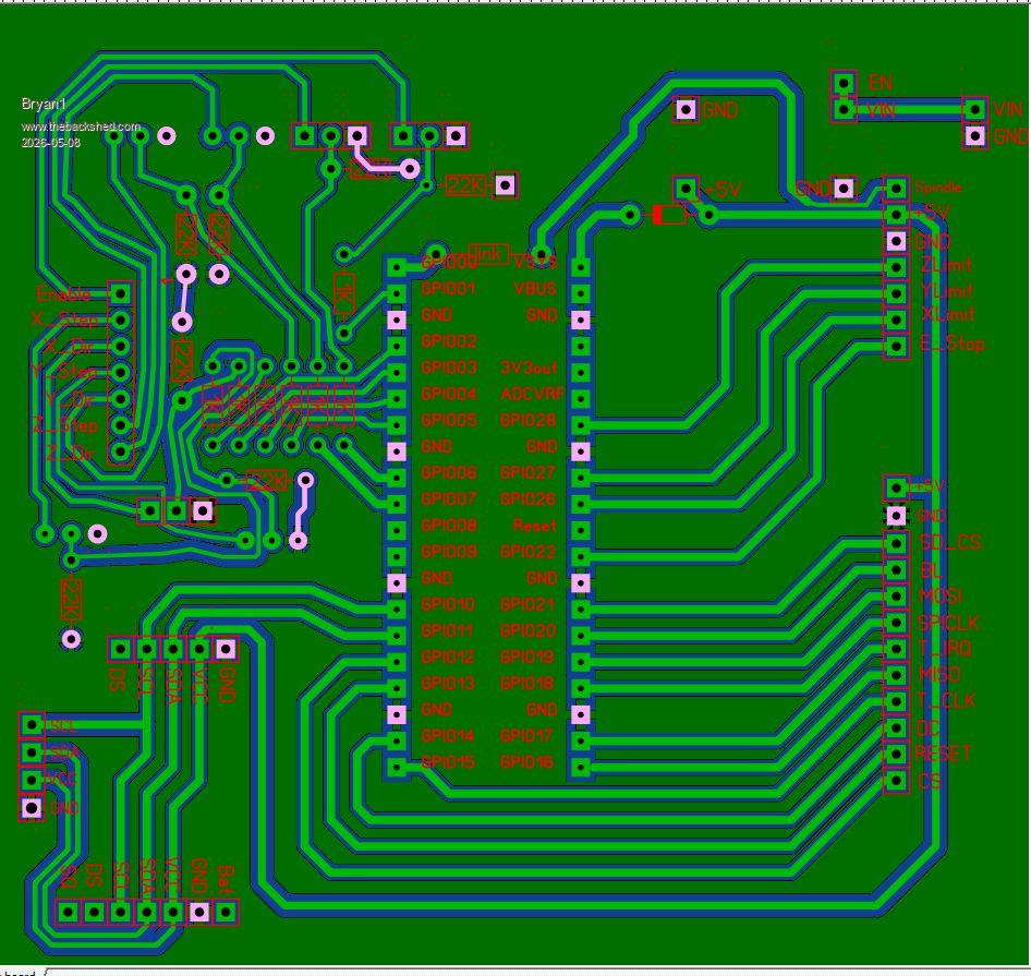

Ok finally got the DRC down to the 45 degree link, I did try deleting the 10mm resistor and even redid each pad by doing a paste of the pad that did clear DRC. Now no matter what I've tried hasn't worked so Mixtel can you please fix this for me then the PCB will pass the DRC. Also I redid the macros so it passed DRC where before I didn't do a DRC
pico 2 board.zip
Here is a pic with the ground plane in
Regards Bryan
Edit: I found removing the SIP pads for the link cured the DRC now strangely just about every other connection is the same.
Edited 2026-05-08 14:04 by Bryan1
Posts: 6253
Posted: 06:22am 08 May 2026
Hi Bryan,
1/ The ground plane looks not connected. Maybe you should connect it to GND to get best performance.
2/ Maybe this is the graphics... but it looks as if there is solder mask on the pads. Please check this out before ordering. Otherwise you cannot solder anything to the board.

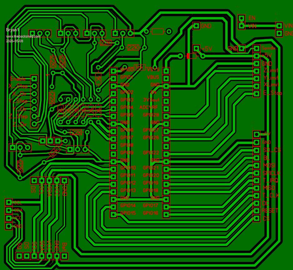

Ok just worked how to do the thermal pads so this means a total new design for the pcb and solve the problem of GND ?

Hi Bryan,
- the 4 pin I2C pins on the bottom LHS are not interspersed correctly (not 100 mil distance between them). The minor distance issue may not have a real world effect.
- the top 2 pads of the 12 pin display connector on the RHS are not interspersed correctly. The minor distance issue may not have a real world effect.
Now that you have re-caught the bug for Sprint Layout, there is an excellent free plug-in called sprintFont available from https://github.com/cdhigh/sprintFontRelease
which provides Teardrops to pads, Rounds tracks, and a few other great features.
cheers
Edited 2026-05-08 17:45 by BarryH
BarryH
Posts: 9328
Posted: 08:04am 08 May 2026
It's usual to use thermal pads and the ground plane as your common GND connection everywhere. It's also important that you use the test pen to make sure that you do a point-to-point check on everything. If you've been messing about you can sometimes get traces that don't quite reach a pad or isolated thermal pads that aren't actually connected to GND because other traces are in the way.
If you click on the red Solder mask button all masked areas light up. If you click one of these it goes out and mask is applied. This is very handy with vias as you want them masked even though they are actually through pads. Unfortunately SL6 has no built-in concept of vias.
I changed the colour scheme, but that's up to you. Something I learned on the CAD at work is that red is a dark colour and not easily seen on a black background. You can have several user-defined schemes if you like. :)  Options/General Settings/Colours
If you are using 1A Schottky diodes then be aware that their leads are quite thick (like a 1N4007). I usually use 1mm for them.
BE AWARE! JLCPCB don't do single sided boards and every hole is through-plated by default. So, if you use them, treat it as a double sided board.

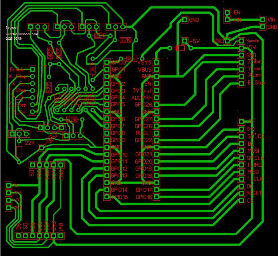

Ok finally got there and found I had to put a ground plane on C1 layer in oder to get 3 transistor emitters to attach to ground. I did find doing a via on the LCD SIP did the trick
pico 2 board.zip
Now I do have some double sided PCB boards here but as it's only a 100x100 board getting them made at JLCPCB may be the go.
Regards Bryan
Edit : didn't see the posts as I was typing OK so make the gaps on the traces wider apart so they are more than 100 mil apart, now for the scotty diode as I have some off my inverter project I was just going to use one of them
Edited 2026-05-08 18:22 by Bryan1

OK went and did a DRC and found a few errors so fixed them all so got the all clear there. So if the design committee is happy then it's ready to go to JLCPCB to get the boards made.

Something else to watch is hole diameters. Generally male pin headers need 0.9mm or 1mm, female sockets can be as small as o.77mm or 0.8mm. It looks like you maay have done something like this already.
When I have thermal pads in the middle of a row I usually turn off the connections facing the adjacent pins. It's not strictly necessary unless you are running a trace between them, but I do it anyway. :)
You've got the VSYS and VBUS pins swapped, haven't you? There is an on-board diode from VBUS to VSYS on a Pico so you can power it directly into VSYS without a back-feed to the USB socket (VBUS). You may want a diode from the external circuit to VSYS so that it doesn't get powered when you are updating firmware over USB. It's purely optional usually.
