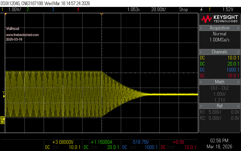

Posts: 6253
Posted: 08:03am 18 Mar 2026
  matherp said  Try this
PicoMite.zip
Volume down is very smooth !! rc2 volume down worked by changing at the first zero crossing, but this is also possible.
