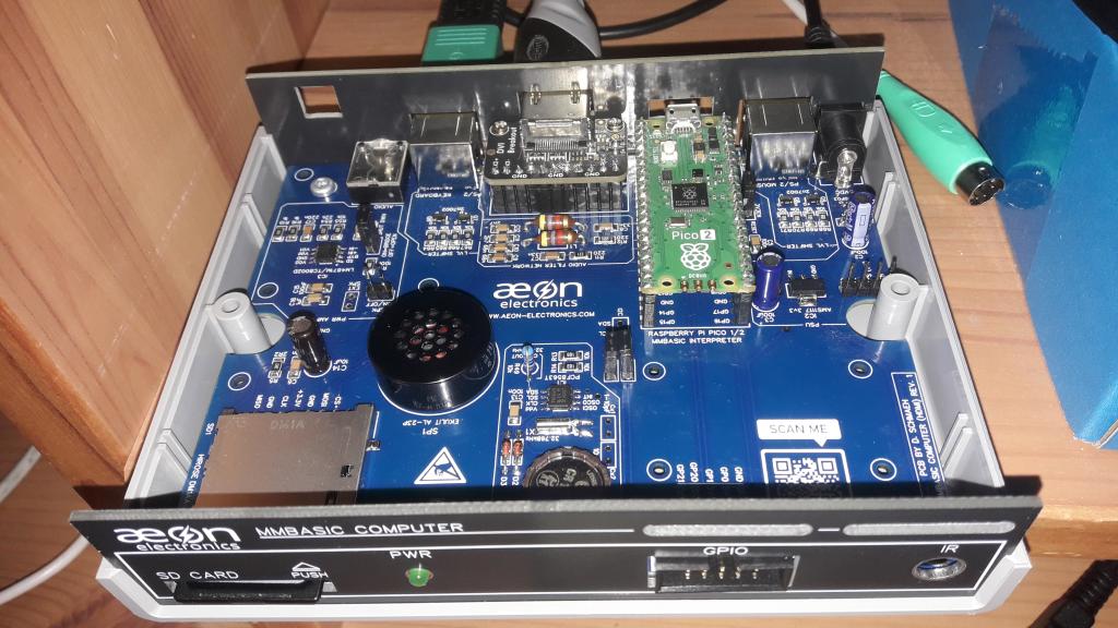

Amnesie
Joined: 30/06/2020
Posts: 763
Posted: 09:49am 25 Oct 2025
  dddns said  Please try to move audio to gp10,gp11
If it fails to gp18,gp19
This isn't possible, I can't re-design all my PCBs:
..and in beta 18 everything works, so there must be some change in later versions.
Greetings
Daniel
