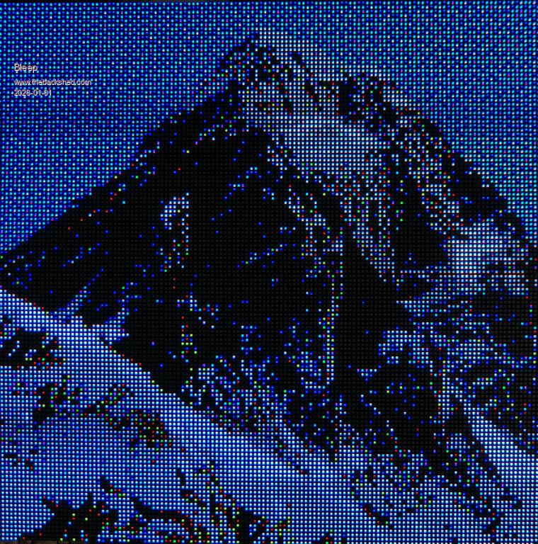

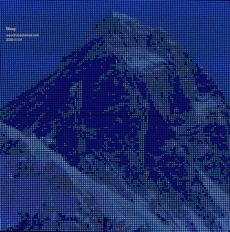

As prommised, here is a 128x128 display, same image with different dithering unfortunately this was about as good as I could get it. :-(
I'll keep experimenting.
Regards Kevin.
