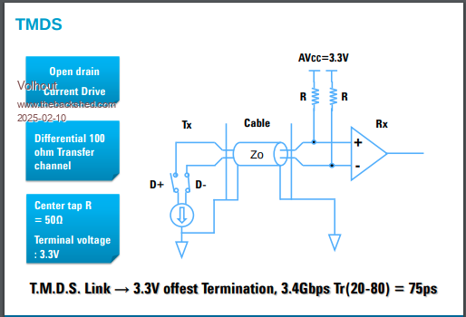

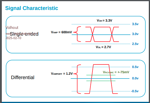

  matherp said  My understanding of HDMI/DVI signalling is that the signal pairs should be terminated with 50 ohms BETWEEN THEM AND NOT TO GND - important distinction.
DVI and HDMI physical layer are identical. See these picture from Agilent (who make the testers for HDMI compliance). The differential termination is 100 ohm (each line has its own 50 ohm to a common 3V3 in the TV/Monitor). 50+50=100.
We drive 1 pin low, the other high. For low pin the current is set by the series resistor, and the 50 ohm, and the pico output resistance that differs per drive strength setting. The high pin drives virtually no current (between pico 3.3V and 3V3 termination).
P.S. about the slew rate: for 1280 (100MHz+) you will need fast slew rate. It is very well possible that at 640 slow slew rate is acceptable. Note that the HDMI spec talks about rise times of far below 1ns (1ns is a 350MHz bandwidth). But this includes far higher resolutions as well (4k).
Edited 2025-02-10 01:47 by Volhout
