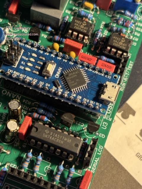

The components you mentioned are all correct, just wondering if I've got this right?
 74AC86 into 33R resistors on the nano board then driving the 120R's on the power board.

Yes that's correct total of ~300R and voltage of ~ 3.5V (voltage after LED forward voltage drop) so current is ~ 12mA.
When you assembled the controller, did you check the CBE orientation of the TO92 plastic cases. Some substitutes have a pinout of EBC instead of CBE and need to be inserted 180 degrees from silk screen (this is also true for some substitutes of the TO92 FETs). I am guessing you are aware of this?

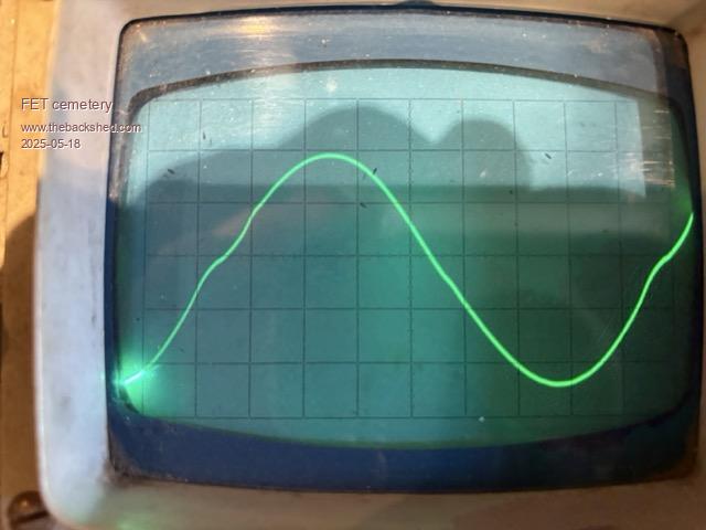

It really does help if you have the right test equipment.

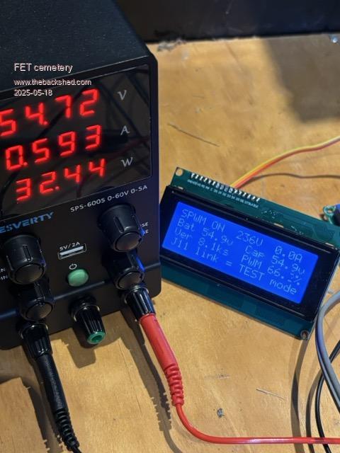

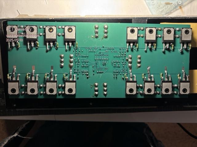

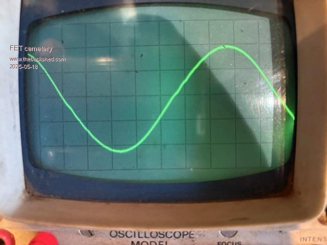

The power supply arrived last Thursday as did the smaller gate resistors. I fitted the fets to the second power board with the smaller resistors.
Following Wiseguy's test procedure everything checked out ok on the bench with both boards, hooked up to the toroid and all was good (both power boards and both nano boards were tested and all worked).
I guess it must have been an unstable supply coming from the batteries and light globe or fuse when loaded with the toroid after all. I'm happy to be the village idiot if it saves someone else from making the same mistake!
Eventually wound it up to 54V in, 235V out, this is with the nano board and fet board powered by the variable supply:
The transformer makes a nasty hum if the voltage is wound up too fast but settles down pretty quickly.
Waveform is ok.
Couldn't help myself, I hooked it up to the house battery with a 32A breaker on the DC side and ran a 1kW heater for 20 minutes or so, bit of a hum from the transformer and the waveform wasn't as pretty but this was using the power board with the big resistors and some fairly untidy wiring that could easily have been picking up switching noise.
The bias supplies and regulators were slightly above ambient, 5 degrees or so, nothing else was even remotely warm. No air movement, power board lying flat with the heatsink underneath it.
Efficiency was a whisker under 95%, take away the 30W standby power and the conversion efficiency is nudging 98% at 1kW. Impressive!
Time to build a cabinet for it and wire it up properly.
Thank you to everyone who has helped me get this far!

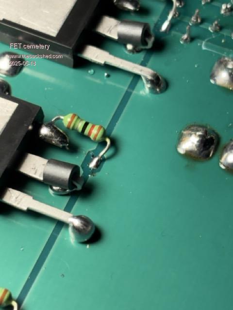

I used a different technique soldering the fets on the second board:
The drains and sources were soldered from the component side using the unregulated 80W iron. The fets were pushed up against the heatsink to keep them cool, and the iron was held on the leads for 8 to 10 seconds, getting both sides of the board hot enough for the solder to melt all the way through:
I'm pretty happy with the result, will do the same to the first board when I swap the gate resistors.

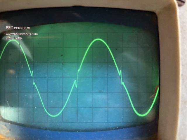

Posted: 03:37am 09 Dec 2025
Well it's taken ages, other stuff gets in the way, but the inverter is finally up and running. Not complete mind you, there's some tidying up to do, ok there's a lot of tidying up to do (the toroid is still not in the case, fans are switched manually) but it's running.
I am seriously impressed, this is a properly powerful machine. At 3.6kW it barely gets warm with no fans. Charging the car at 5.7kW, again with no fans, the heatsink gets warm and the pcb slightly warmer, not more than about 20C above ambient.
Turning the fans on, the heatsink runs cold with minimal airflow and the pcb is a bit warm.
The toroid seems to run cooler than with the egs002/powerjack board at the same output, 3.6kW doesn't need a fan and anything more needs minimal airflow to keep things cool.
A couple of questions-

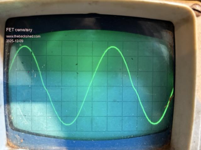

At idle, pwm is 68% (54V in). I have to run at 5.7kW and let the battery drop to 47V (something that would never happen normally) to get pwm up to 85 or 86%. Would losing a turn off the 12 turn primary be a good idea?
There's quite a buzz/hum from the transformer when charging the car, regardless of the charge current. This was the case with the powerjack board as well. On the scope the output looks interesting:
This was at 5.7kW, it doesn't look much different at 1.5kW.
For comparison, this is the inverter running 1.5kW into a old box-in-the-wall induction motor aircon:
I don't think there's anything wrong with the inverter, I suspect it's an interaction between the car's internal charger and the big toroid.
I'm picturing some sort of big switchmode supply that abruptly stops drawing current just before the zero crossing, with the spike in the waveform being the toroid reacting to that. Could be completely wrong, interested in what others think.
Does this matter, and can anything be done about it?
It's early days, but the inverter doesn't seem to run any hotter charging the car than it does with a purely resistive load (of course my IR thermometer packed it in a couple of months ago). Have yet to use it to run the 3.6kW kiln, will look at the output waveform when I do.
Once again, thanks to Wiseguy, KeepIS, Poida and all who have contributed to this project!

That distortion is likely the Car charger, the only thing it causes is a buzz in the Toroid.
I monitor some horrible loads via the two Peak DC input current meters and the DSO, there has been no increases in input current with loads far worse.
IMHO 68% is on the low side, checking with an input turn removed might be a good idea, as the FETS work harder with a low duty cycle and high power, mine is around 73% at idle, and I think I should remove a turn as well, but it's working perfectly so maybe in the future.
I've often running at over 14kW and the SPWM is around 88% from memory.

Doesn't removing a primary turn lowers the dutycycle further? The ratio increases when you remove a primary turn.
FET cemetery
Joined: 17/04/2024
Posts: 77
Posted: 11:07am 09 Dec 2025
"Doesn't removing a primary turn lowers the dutycycle further? The ratio increases when you remove a primary turn."
You're right of course, had to think about it a bit then confirmed it experimentally!
Idle duty cycle went from 72% to 78% with an extra turn added to the primary (night time here, battery at about 50.5V). Will tighten the primary winding up a bit tomorrow and see how it goes charging the car.
