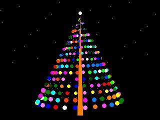

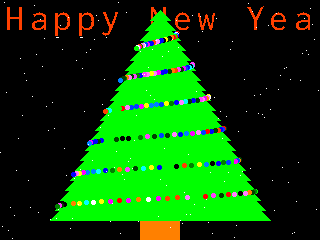

Merry Christmas & Happy New Year!
MODE 2
FRAMEBUFFER create
FRAMEBUFFER write f
T$="Merry Christmas & Happy New Year!"
x=700:h=160
CLS
If x<-350 Then x=700
Text x,5*Sin(x)+10,T$,C,5
C=Rnd*&HFFFFFF:x=x-1
Text x,5*Sin(x)+10,T$,C,5,,C
C=RGB(BROWN)
Box 140,220,40,20,1,C,C
C=RGB(GREEN)
For i=10 To 110 Step 5
 Triangle h,i,h-i,i+i,h+i,i+i,C,C
Next i
For i=4 To 43 Step .1
 p=i+Timer\100
 If Cos(p)<0 Then
   C=Rnd*&HFFFFFF
   Circle h+2.5*i*Sin(p),i*5,2,,,C,C
 EndIf
Next i
For i=0 To h
 Pixel i+i,Rnd*240
Next i
FRAMEBUFFER copy F,N,B
Loop

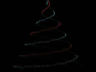

Christmas Tree
https://github.com/anvaka/atree
MODE 2
FRAMEBUFFER CREATE
FRAMEBUFFER WRITE F
max = 19
xScale = 6
zScale = 2.5
yScale = 11.5
dz = 640
phase=0
Dim redSpiral(2)=(RGB(Red),RGB(Myrtle),1)
Dim cyanSpiral(2)=(RGB(Cyan),RGB(Myrtle),0)
CLS
For i= -startFrom To max Step 0.08
 If (i<0) Or (i>max) Then Continue For
 createSpiral(redSpiral())
 createSpiral(cyanSpiral())
Next
Inc phase,0.1: If phase>6.28 then phase=0
FRAMEBUFFER COPY F,N,B
Loop
Sub createSpiral(config())
sign = Choice(config(2),-1,1)
If config(2) Then
 foreground = config(0)
 background = config(1)
Else
 foreground = config(1)
 background = config(0)
EndIf
zoff = i*Sin(i+phase)
z = dz/(dz-sign*zoff*zScale)
x = sign*i*Cos(i+phase)*z*xScale+160
y = i*z*yScale+2
If zoff+sign*Pi/4 < 0 Then
 Colour (foreground)
Else
 Colour (background)
EndIf
Pixel x,y
End Sub

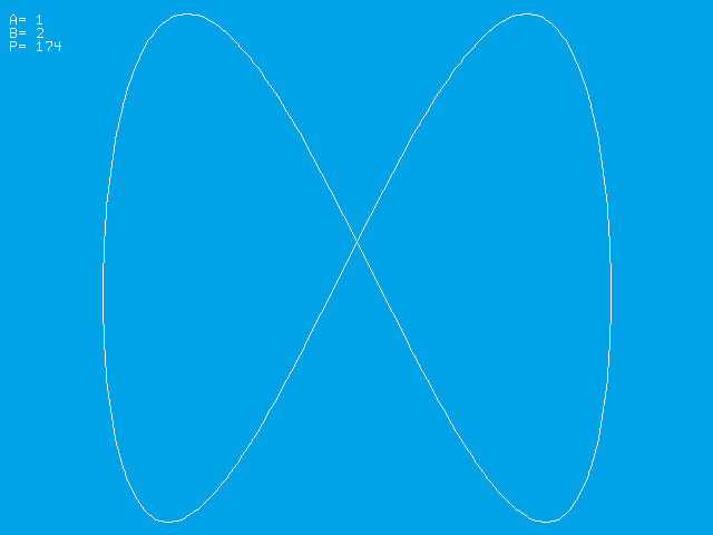

Lissaju 2   PicoMiteVGA/HDMI MMBasic V6.00.02
MODE 1
Option ANGLE DEGREES
FRAMEBUFFER CREATE
FRAMEBUFFER LAYER
RX=MM.HRes:RY=MM.VRes:CX=RX\2:CY=RY\2
Scale=0.95: AX=CY*Scale: AY=CY*Scale
a=1: b=0: p=0: f=0: c=0
CLS RGB(BLUE)
RBox 0,0,RX,RY
For y=80 To RY Step 80
For x= 8 To RX Step  8
Pixel x,y
Next x:Next y
For x=80 To RX Step 80
For y= 8 To RY Step  8
Pixel x,y
Next y:Next x
For y=0 To RY Step 8
Line CX+1,y,CX-1,y
If Not (y Mod 40) Then Line CX+2,y,CX-2,y
If Not (y Mod 80) Then Line CX+3,y,CX-3,y
Next y
For x=0 To RX Step 8
Line x,CY+1,x,CY-1
If Not (x Mod 40) Then Line x,CY+2,x,CY-2
If Not (x Mod 80) Then Line x,CY+3,x,CY-3
Next x
Triangle CX,0,CX-3,8,CX+3,8,,1
Triangle RX,CY,RX-8,CY-3,RX-8,CY+3,,1
Print @(CX-14,3) "Y"
Print @(RX-12,CY-16) "X"
FRAMEBUFFER WRITE F
 If p>360 Then p=0: EndIf
 If b>6   Then a=a+1: b=0: c=0: EndIf
 If a>5   Then a=1:   b=0: c=0: EndIf
 If c=50  Then
   f=1
   If a=Fix(b) Then f=0: c=0: EndIf
 EndIf
 If c=130 Then f=0: c=0: EndIf
 CLS 0 : Colour RGB(WHITE),RGB(BLUE)
 Print : Print " A="a: Print " B="b: Print " P="p
     sx= AX * Sin(p) + CX
     sy= AY * Sin(p) + CY
 For i= 0 To 360
     x = AX * Sin(a*i + p) + CX
     y = AY * Sin(b*i + p) + CY
     Line sx,sy,x,y
     sx=x: sy=y
 Next i
 FRAMEBUFFER COPY F,L,B
 Inc p: Inc c
 If  f=0 Then b=b+.02
Loop Until Asc(Inkey$)
stanleyella
Joined: 25/06/2022
Posts: 2807
Posted: 05:26pm 17 Jan 2025
I get a graticule and scrolling values in terminal but no Lissaju
stan
Posts: 12172
Posted: 05:41pm 17 Jan 2025
  Quote  I get a graticule and scrolling values in terminal but no Lissaju
You need to be running 6.00.02b0 and if running on a VGA version the CPU speed muust be >=252000
stanleyella
Joined: 25/06/2022
Posts: 2807
Posted: 05:58pm 17 Jan 2025
@matherp sir. is vga also hdmi. the layers like FRAMEBUFFER COPY F,L,B seem different and FRAMEBUFFER CREATE
FRAMEBUFFER LAYER.
I got vga and hdmi to test. it's in the manual?
amazing the improvements to mmb especially pico 2. best wishes, stan
I'll load te beta
stanleyella
Joined: 25/06/2022
Posts: 2807
Posted: 06:38pm 17 Jan 2025
loaded the beta and got Lissajous. interesting code and nice vga demo.
nice one @javavi
thanks @matherp sir

works nice in mode 2 but not mode 3, not enough heap mem
really is a nice program... we should all know trig

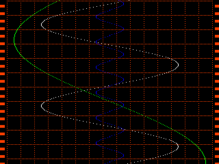

Punched tape chart recorder
c0=RGB(rust):c1=RGB(green):c2=RGB(white):c3=RGB(blue)
CX=MM.HRes\2
MODE 2: CLS
FRAMEBUFFER LAYER
Text 160,200,"- PicoMite -","CM",1,3,RGB(myrtle)
FRAMEBUFFER WRITE L
Blit 0,0,0,1,MM.HRes,MM.VRes-1
Line 0,0,MM.HRes,0,,0
If t=0  Then For i=10 To MM.HRes-10 Step 2:Pixel i,1,c0:Next
Inc t: If t>20 Then t=0
If t0=0 Then For i=10 To MM.HRes-10 Step 20:Pixel i,1,c0:Next
Inc t0: If t0>2 Then t0=0
If t1=0 Then Line 0,2,6,2,4,c0:Line MM.HRes-6,2,MM.HRes,2,4,c0
Inc t1: If t1>10 Then t1=0
Pixel 140*Sin(d1)+CX,0,c1
d1=d1+1: If d1>360 Then d1=0
Pixel 100*Cos(d2+p2)+CX,0,c2
Pixel  20*Sin(d3)+CX,0,c3
d2=d2+3: If d2>360 Then d2=0: Inc p2,5
d3=d3+10: If d3>360 Then d3=0
Pause 10
Loop While Inkey$=""
stanleyella
Joined: 25/06/2022
Posts: 2807
Posted: 10:39pm 08 Feb 2025
only half waveform

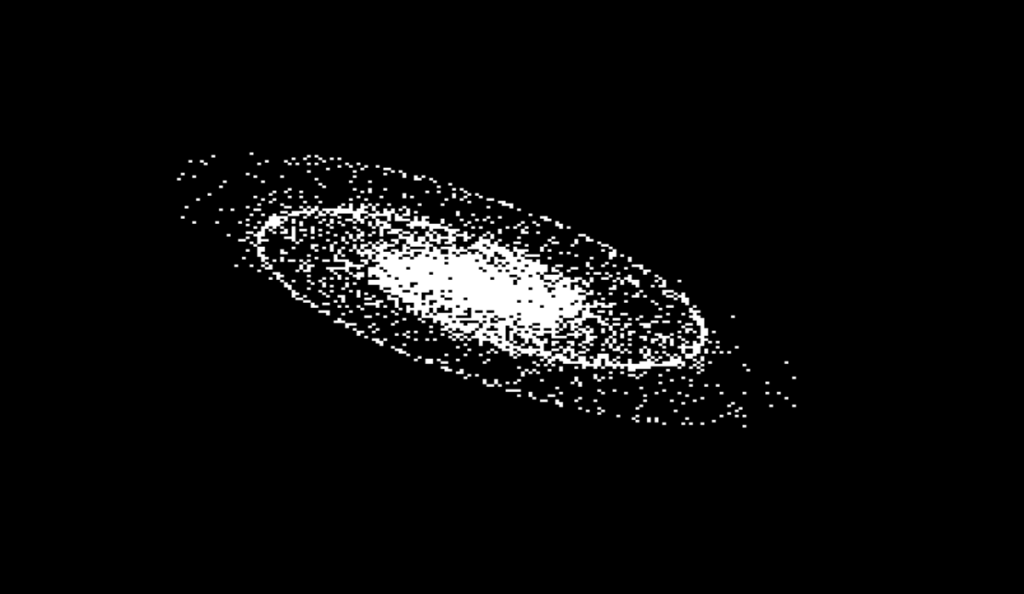

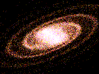

I found a beauty small C64 program on Facebook  and translated it to MMBASIC.
Mode 2
for i=1 to 8000
S=-log(.1+RND)
t=s*200:U=S*20*SIN(t):V=S*25*COS(t):P=S*3
C=COS(P):S=SIN(P)
X=U*C+V*S:Y=-U*S+V*C:R=X*X+Y*Y*Y
Z=40*EXP(-R/1000)*(RND-.5)
X=X*1.4+y*.6:Y=x*.2+y*.8
if ABS(x)<127 AND abs(Y)<=87 THEN PIXEL 160+x,120+y
NEXT
'no comment

Maybe you should first choose the mode, and then after that decide what CX should be set to, since MM.Hres is different when in mode 1.
javavi
Joined: 01/10/2023
Location: Ukraine
Posts: 636
Posted: 05:19pm 10 Feb 2025
  Volhout said  Maybe you should first choose the mode, and then after that decide what CX should be set to, since MM.Hres is different when in mode 1.
Yes, that's right.
MODE 2: CLS
CX=MM.HRes\2
FRAMEBUFFER LAYER
FRAMEBUFFER WRITE L
Pause 10

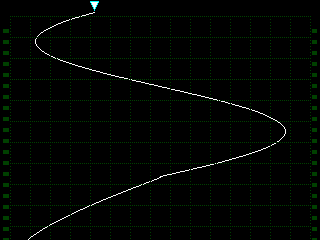

Punched tape recorder with instrument scale
Option DEFAULT INTEGER
MODE 2: CLS
c0=RGB(myrtle):c1=RGB(green):c2=RGB(white):c3=RGB(cyan)
c4=RGB(yellow):c5=RGB(midgreen)
CX=MM.HRes\2:Am=150:St=1:Clr=RGB(white)
FRAMEBUFFER LAYER
Box 0,0,MM.HRes,20,,c4:Box 0,22,MM.HRes,MM.VRes,,c5
For i=10 To MM.HRes-10 Step 5: Line i,8,i,12,,c4:Next
For i=10 To MM.HRes-10 Step 10:Line i,6,i,14,,c4:Next
FRAMEBUFFER WRITE L
Blit 0,10,0,11,MM.HRes,MM.VRes-11
Line 0,0,MM.HRes,0,12,0
If t=0  Then For i=10 To MM.HRes-10 Step 2:Pixel i,16,c0:Next
If t0=0 Then For i=10 To MM.HRes-10 Step 20:Pixel i,16,c0:Next
If t1=0 Then Line 3,21,8,21,4,c0:Line MM.HRes-8,21,MM.HRes-4,21,4,c0
X0=Am*Sin(d1)+CX
Triangle X0,10,X0-4,1,X0+4,1,c3,c2
Line X0,12,X1,13,,Clr
X1=X0
d1=d1+St
If d1>360 Then d1=0:Am=150*Rnd:St=10*Rnd+1:Clr=&HFFFFFF*Rnd
Pause 10
Edited 2025-02-18 04:59 by javavi

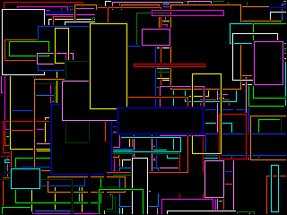

Square Art   black and white, but also in color
 M=Int(2*Rnd)
 If M Then MODE 1 Else MODE 2
 XR=MM.HRES
 YR=MM.VRES
 For I=0 To 1000
   X=Int(XR*Rnd)
   Y=Int(YR*Rnd)
   W=Int(100*Rnd+4)
   H=Int(100*Rnd+4)
   C=Int(&HFFFF00*Rnd+255)
   F=Int(2*Rnd)
   If F Then Box X,Y,W,H,,C Else Box X,Y,W,H,,C,F
   Box X+1,Y+1,W-2,H-2,,0
   Box X-1,Y-1,W+2,H+2,,0
 Next
 Pause 2000
Loop
Posts: 6252
Posted: 11:06am 17 Mar 2025
Hi Vadim,
I thought this would be a boring one, but it turns out as one of the more interesting demo's. Especially the switching between mode 1 and mode 2 makes it interesting.
Tested on v6.00.02rc5 on RP2040 VGA.

Posted: 06:35pm 23 Mar 2025
  Martin H. said  I found a beauty small C64 program on Facebook  and translated it to MMBASIC.
Galactica B/W & Colour
Dim CM(6)=(0,8,10,12,14,13,15)
Colour Map CM(),CM()
If Cint(Rnd) Then MODE 1 Else MODE 2
XC=MM.HRES\2:YC=MM.VRES\2
r1=200:r2=250
t1=200:t2=3
For N=1 To 5
 For I=0 To 10000
   L=-Log(Rnd)
   T=L*t1
   U=L*r1*Sin(T)
   V=L*r2*Cos(T)
   P=L*t2
   c=Cos(P)
   s=Sin(P)
   X=U*c+V*s
   Y=-U*s+V*c
   R=X*X+Y*Y
   Z=400*Exp(-R/100000)
   Z=Z*(Rnd -.5)
   Y=Y+Z+Rnd*50
   X=X-Z+Rnd*50
   xp=XC+X*.21+Y*.09
   yp=YC-X*.03-Y*.12
   If Pixel(xp,yp) Then
     Pixel xp,yp,CM(N+1)
   Else
     Pixel xp,yp,CM(N)
   EndIf
 Next
Next
Loop

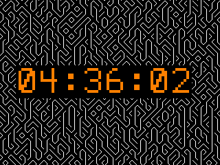

Posted: 11:58am 02 Apr 2025
Vertical Scrolling Clock
Const Mode.N=2
Const Font.N=1
Const T.Scale=4
Const T.Size=Len(Time$)
MODE  Mode.N
Const X.Res=MM.HRES,Y.Res=MM.VRES
Font  Font.N
Const X.FSize=MM.Info(FONTWIDTH)
Const Y.FSize=MM.Info(FONTHEIGHT)
Const X.Offset=X.FSize*T.Scale*T.Size\2
Const Y.Offset=Y.FSize*T.Scale\2
Dim integer X.Dir=1,Y.Dir=1
Dim integer X.Pos=MM.HRES\2,Y.Pos=MM.VRES\2
Dim Clr(15)=(0,1,2,3,4,5,6,7,8,9,10,11,12,13,14,15)
Colour Map Clr(),Clr()
FRAMEBUFFER LAYER 0
FRAMEBUFFER WRITE L
Font 9
Print @(0,0);
For n=1 To (X.Res\8)*(Y.Res\8)
 Print Chr$(32+Int(Rnd*3));
Next
Blit READ  1, 0,0,MM.HRES,1
Blit 0,1,0,0,MM.HRES,MM.VRES-1
Blit Write 1, 0,MM.VRES-1
Blit Close 1
Pause 20
FRAMEBUFFER WRITE N
If C=0 Then C=Int(Rnd*15)+1
Text X.Pos,Y.Pos,Time$,"CM",Font.N,T.Scale,Clr(C)
Inc X.Pos,X.Dir:Inc Y.Pos,Y.Dir
If X.Pos-X.Offset<0 Then X.Dir=1
If X.Pos+X.Offset>MM.HRES Then X.Dir=-1
If Y.Pos-Y.Offset<0 Then Y.Dir=1:C=0
If Y.Pos+Y.Offset>MM.VRES Then Y.Dir=-1:C=0
FRAMEBUFFER WRITE L
DefineFont 9
04200808
80402010 08040201
01020408 10204080
08080808 08080808
End DefineFont
