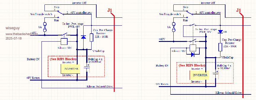

  wiseguy said  I am not advocating to use the second circuit it just shows an ideal solution.
The second circuit could use either a spare contact set that some of the contactors use or alternatively a second small 48V relay driven in parallel with the contactor, untested but I believe it provides the required isolation from the bulk capacitors and the Nano controller.
Will the forward voltage drop on the diode in the circuit for pre-charging the capacitors mean they won't quite get to VBat and need an adjustment in the setup to account for it?
Good question, in Poidas code we put a known voltage simultaneously on the Vcap and Vbat inputs and calibrate them both simultaneously to the known Vbat voltage. That way resistor tolerances are taken into account and calibrated for. There would be an offset error that the diode causes to the Vcap that becomes more prominent the closer we get to zero volts.  I'm going to ask KeepIS what the prognosis is for the added diode, and when calibrating should it be with the diode included for better accuracy at the region of interest, or does version two need more work.... or more lipstick...
Circuits in question:
Edited 2025-07-18 11:46 by wiseguy

  Quote  in Poidas code we put a known voltage simultaneously on the Vcap and Vbat inputs and calibrate them both simultaneously to the known Vbat voltage. That way resistor tolerances are taken into account and calibrated for. There would be an offset error that the diode causes to the Vcap that becomes more prominent the closer we get to zero volts.  I'm going to ask KeepIS what the prognosis is for the added diode, and when calibrating should it be with the diode included for better accuracy at the region of interest, or does version two need more work.... or more lipstick...
The diode should not cause any issue and if used should be installed when calibrating, VBat to VCap delta is only relevant when the Inverter is above low voltage cutout and SPWM / Solenoid are enabled. My code also has a more stringent delta test immediately after Solenoid enable (and a different code), IMHO in either case, the  calibration of VCap with a Diode in series should only have an influence at very low voltages when the Solenoid is switched off, as wiseguy indicated, that difference should be meaningless to the code at low V.
EDIT: Just to be clear, there are separate calibration settings for Vbat and VCap in my Code, and allowable Delta is adjustable up to 3V if needed.

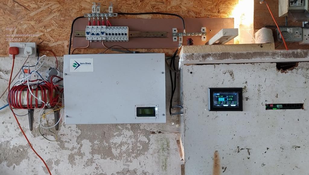

Probably not your stuff up but mine Wiseguy    I downloaded copies of the schematics early on so I wouldn't have to go looking for them when I needed them. But I didn't check to see if it was the latest version when I came to use it
Finally got it connected to the battery today:
Not yet tidied up on the ac side but ok to start testing. Tried a couple of small loads then connected the mahoosive chest freezer as a longer term test, and to see how it was with a big start surge - fine,  although it did manage to trip once in about 5hrs on overcurrent.

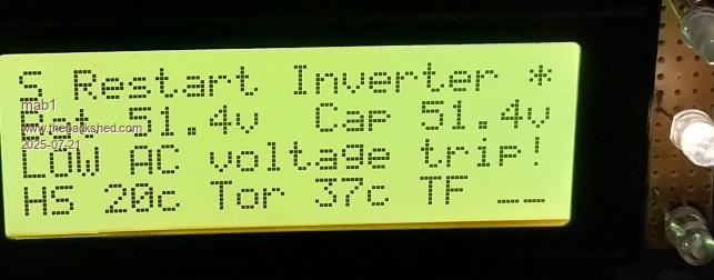

I don't have any solar connected to the 48v battery yet, so once i was sure it was happy with the freezer I switched a couple of gti solar arrays onto it as they're on plugs and easy to transfer over. I can't recall if anyone else was planning to backfeed with gtis, and it wasn't very sunny so it was only 500w, but the inverter didn't bat an eye when backfeeding
Gradually left it for longer periods but kept popping back to check as I don't want the freezer to defrost,  but then after about 5hrs from Startup, I came back to this:
Note the torroid temp was high. I couldn't really figure out what had happened so I reset the inverter- it started fine and started the freezer fine, but the transformer seemed a bit noisy, and after a couple of minutes it was getting louder and rougher sounding, and seemed to be pulling a couple more d.c. amps than it ought, so I unplugged the freezer. The transformer got quieter, but was still loud, and was getting louder even with no load, and putting my hand on it, the primary was getting hot   so I turned the inverter off.
Thinking about it, I'm guessing I'm losing drive to one corner of the h-bridge (again   - i had that on the test bench, but i fixed that solder joint for sure)? But I'm not sure yet and need to do some testing   . I'm guessing I must have a dodgy solder joint somewhere.

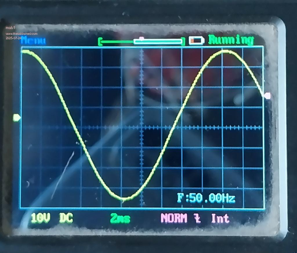

But got home earlier today and not too tired so I fired it up on a 2A bench psu and 2000uF capacitance, and looking at the waveforms on the little pocket'scope:- running fine with no issues, even when prodding/poking/wiggling things in their sockets.
Sinewave (via the weller iron 24v transformer) looks ok to me.

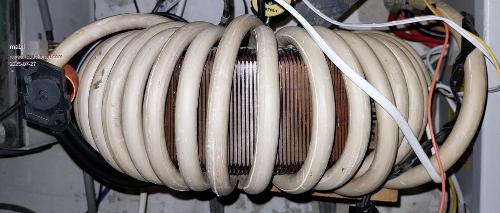

The temporary transformer is the aerosharp with all it's existing windings, primary and secondary intact, so 16mm is the biggest I can fit. I was thinking 16mm would suffice for 3kva,  but since your comments I've noticed the primary getting warmer than i was expecting - and realised there was a flaw in my thinking: I was thinking 3kva @battery voltage (50 - 60v) would equate to about 60A, which 16mm should handle; but of course it's not battery voltage, it's the 26 or 27v for 230v out that the primary it wound for,  and 3kva @27 volts is a lot more amps.
So for testing to higher loads I've cobbled up another temporary transformer:
This is the variac core with 37 turns of 50mm2 . Using the 230v winding as it is so runs about 16W at 230v Due to the smaller core cross section it needs more turns/volt, but there's room for 70mm2 in that huge centre hole (50 is what I've got). Although my inductors are still wound with 16mm2 for now
I ought to get on with winding the double stack really, but I feel it may be worth playing a bit with transformers first.

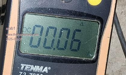

Had the idea of measuring the primary current using the clamp meter set to d.c. and sure enough, it was consistently showing 1 amp or more in one direction even with no load connected.
With 2kw load it would nudge up towards 3A.
When backfeeding it was too noisy to be sure, but given that other people's builds have quiet transformers, it was time to go back to the test bench.

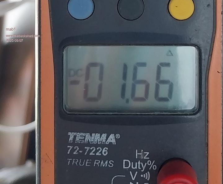

It's been running running quietly ever since - except:- every now and then the transformer does make a little noise, and using the clampmeter, it does coincide with a small dc current (0.3 - 0.5A). It seems to build smoothly over a few seconds,  then fades gradually over several minutes,  then it will be quiet with no measurable d.c. for the best part of an hour before doing it again - I can't figure what could cause it and it dies it irrespective of if there's any load connected or not.
I tried wiggling the optos,  just in case it was a dodgy socket, but even moving them about in their sockets has no effect. Tried one of the other programmed nanos, but it's not that either.
I don't know if that's small enough imbalance to not worry about or not.
