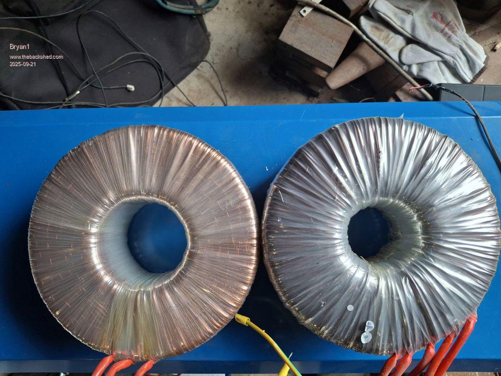

Hi Mike as this is my first array into modifying toroids that guide from the member Cobbler has been a great to me in PM so I am glad to be able put his great info onto the forum for everyone to read.
Now for me with 24 volts 36sqmm cable would be the best for the primary and trying to get thru the hole on a unmodified toroid just wont happen.
Now here is a picture comparing the 2
Now this toroid I was working on did have a 4th winding installed that wasn't used and 1/2 way taking it out the toroid hit the deck and scratched a heap of the wire so what was left got cut off and into my copper scrap bin.
Now in the guide I reckon I will add 16 turns to start, get a voltage reading then take a turn off and measure again to get volts per turn so the primary turns can be worked out accurately.
