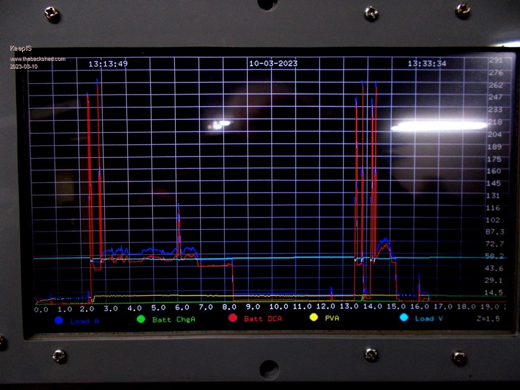

RH Scale Current and Volts, Current in Amps.
We had just powered up some Big Wood working equipment and once it was running I switched the ATS back to "Mains Priority" just before the 14 minute mark.
Everything shut down and then restarted, I thought the worst [Inverter], my wife restarted the Wood working equipment thinking it was now on mains, and before I had realized that it was the MAINS that had tripped and the Inverter had switched back in, hence two more double 13.3kW peaks on the Inverter Log graph.
BTW the earlier peaks at 2 minutes were from me doing some testing with the same two pieces of equipment.
Why both mains "current trip" units tripped when the ATS switched over to mains I don't know, one Switch is in the Shed Fuse box and the other in the Main supply fuse Box for the shed Feed.
FYI the Inverter DC input Isolater / Pre-charge solenoid I posted about is just magic, I can't really measure any voltage drop across it.
Been overcast dim and raining all day here
Edited 2023-03-10 16:16 by KeepIS

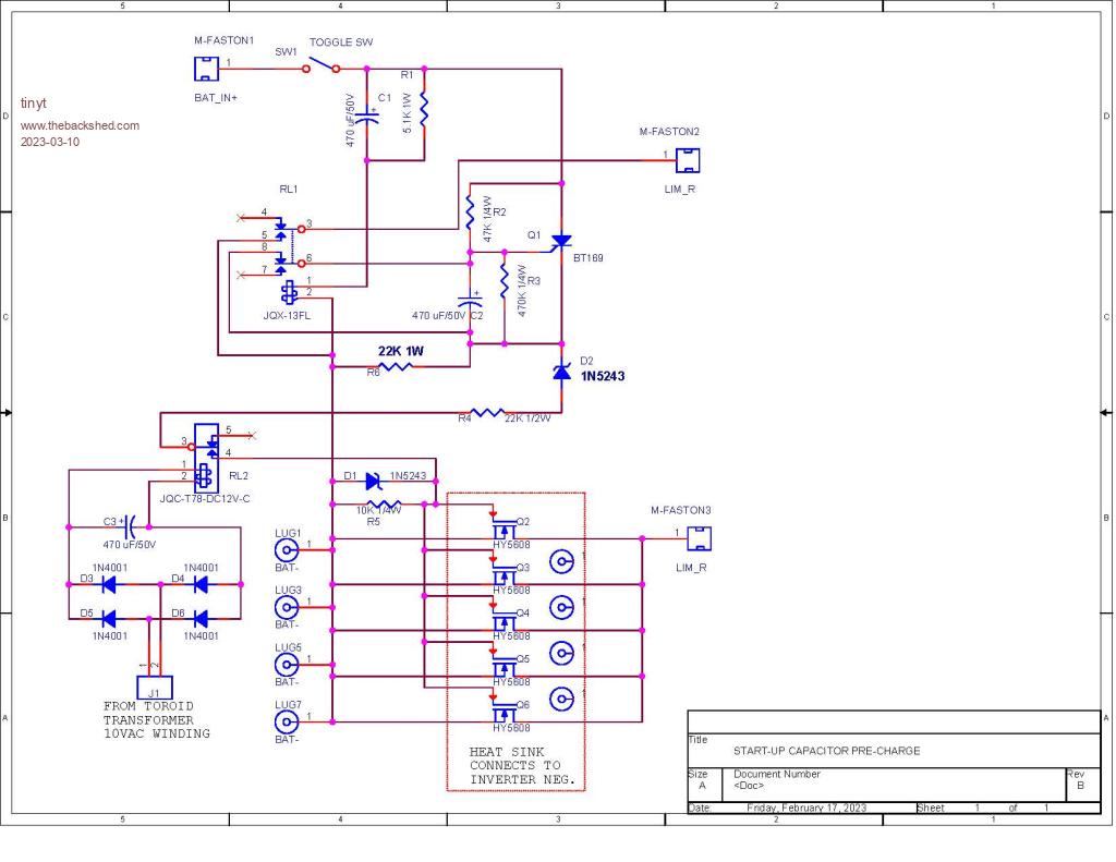

This is still on paper and copper but not yet assembled for testing.
The pre-charge resistor will be between the two LIM_R connectors.
In theory SW1 can be left on and if BAT power re-cycles, it will also re-cycle.
Edited 2023-03-11 00:13 by tinyt

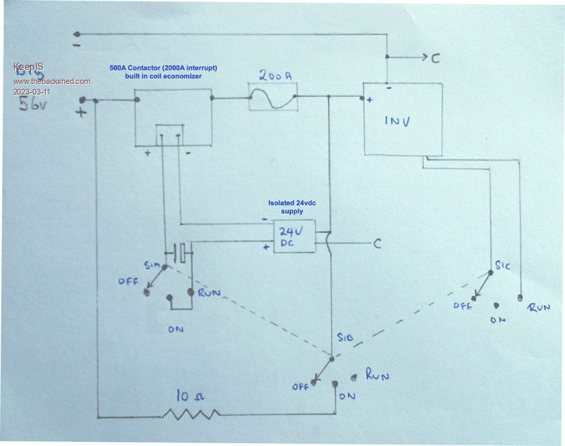

Posted: 02:22am 11 Mar 2023
Looks good, in the past I would have gone in that direction, and I almost did.
However in light of current circumstances (global and personal) I am doing everything with this off grid build to keep it simple, I may not be around to repair it if it fails.
Apology for the quick sketch of the circuit.
1: This Contactor is just beautiful quality with a very small footprint.
2: The terminals are very robust and of high quality.
3: All I needed to completely automate the Power up / Power down cycle was a single 3 position switch and an old 240vac -> 24vdc plug pack.
The following simple circuit is foolproof. You cannot catch it out.
I had the 3 pole 3 position switch in the parts bin along with the plug pack.
The Batteries are only connected to the the inverter when inverter caps are charged to 44 volts, takes around 1 second.
The plug pack holds power to the Contactor down to 17vdc input (very low hold current)
Best of all, I have a bin full of plug Packs, I have a spare Contactor and switch. If this ever fails (unlikely) it's a few seconds to repair for me and someone not so clued up should have no trouble diagnosing and repairing that part of the inverter.
So one switch to Connect / Disconnect the Battery's, leave it in standby or run, and it can auto start if required from any state including off. At the moment it only auto starts if it's in Standby. As the inverter is running 24/7 the auto start is hardly ever used.
Edited 2023-03-11 12:26 by KeepIS

  Quote   In theory SW1 can be left on and if BAT power re-cycles, it will also re-cycle.
This does exactly that: If it's running and you disconnect the batteries, the Contactor drops our "after" the Inverter caps have discharged down to 17v, which means that the inverter itself has already turned off due to Low battery voltage detection.
If you then reconnect the batteries, the inverter powers up almost instantly with no spark or high inrush current, just a loud clunk as the contactor pulls in when caps reach 44v.
In my case I have 350A isolation switches on each Battery bank, so no more switch jamming due to a partly fused contacts when I forget to disconnect the inverter or precharge the caps.
In my system, even if the inverter was on, the Load will not be reconnected until the Inverter AC output had reached 190 VAC AND the Battery voltage is above the minimum set value.
Edited 2023-03-11 13:39 by KeepIS

Hmmmm, What happens if that 200A fuse trips for any reason? No auto start I assume?
I have gone the other way, my inverter has the 5V power to the Nano controlled by voltage sensing the capacitors.
Not possible to turn it on (manual switch) unless the caps are charged.
Disconnecting & re connecting it from the batteries is an entirely other matter. I would not want anybody who does not understand how this inverter works to do that. I really see no need for doing that unless some repairs are required.
With my set up the initial inrush is limited by bypassing the manual DC power switch (instead of your fancy contactor ) with a 15R hi watt resistor. Once the voltage sensing tells me the caps are charged, I short that resistor with the switch. It's now ready to turn the electronics ON.
Should the inverter trip out for any reason, I have a spare inverter ready and connected to the batteries, caps fully charged, just need to swap over the AC output plug and turn that inverter ON once the tripping reason was investigated & fixed.
I'm not sure if it's such a good idea to automate any of this. If there is a fault and the inverter shuts down, I would prefer the fault is found and rectified before attempting to re start the inverter.
My inverter has been running un attended for over 4 weeks in a row while I was away, with no problems. It was powering two fridges and any electronic equipment on standby. Had it shut down I would accept the spoilage of whatever was left in the fridge, much preferable than having a fire resulting from a possible electrical fault and nobody in attendance to take care of that.
KeepIS
Joined: 13/10/2014
Posts: 2287
Posted: 10:26am 11 Mar 2023
Well I still use a 10 ohm resistor that bypass the OPEN contactor to charge the caps, the only difference is the contactor automatically shorts the resistor at 44v charge.
If the 200A fuse goes then we have a bigger problem somewhere, it would take around 300A for more than a few seconds to blow that fuse, and of course I would not want to have this thing start if that fuse went.
Yes understand the Nano setup, but likewise, it's not possible to turn this inverter on unless the caps are charged.
We are thinking along the same lines, I have a spare inverter driver that takes all of 2 minutes to swap over, no need to have the caps charged though
I'm going a bit overboard in that I'm about to start on wiseguys design and will have a third inverter driver, as you know this was supposed to be my test inverter driver board to get the toriod, chokes and the cabinet sorted, and to get a feel for what not to do to an inverter. However it appears to be almost indestructible so far with over 13kW start loads many times a day most day of the week.
If there is a fault, the inverter will not start. This system has an ATS and I can select Mains or Solar priority, therefore it must be able auto start if it's set to Mains priority, perhaps the term Auto start is misinterpreted, I mean it can be off or in standby and controlled to start if / when the Mains fails, when Mains power returns it will go back to its previous state. Once I am off grid completely, of course it won't do that.
Obviously if set to Solar priority, the ATS will only switch to Mains if the Inverter stops for some reason.
I have 3 sets of batteries, each bank has its own big disconnect switch and is fused, each bank has its own charge controller and solar panels, normally all banks run in parallel. There may be times when you want to save one bank from discharging, or have a problem in one bank.
This system is designed for that, I have written a complete manual with full instructions in case that need ever arises and I'm not here. Many thing we take for granted are going to change in the near future and I'm trying to make sure this system can be kept running in some fashion no matter what for as long a possible.
