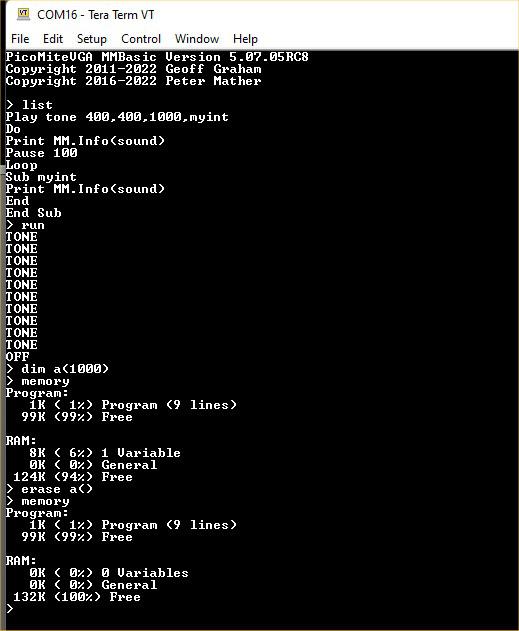

PicoMite V5.07.05RC8
Corrects reporting of MM.HRES and MM.VRES by OPTION LIST when a user driver is loaded
Fixes bug in PLAY TONE n. m. d, interrupt which caused the interrupt not to fire
Fixes bug in ERASE command when erasing arrays
Fixes bug in audio commands executed at the command line - introduced in previous RC
Implements mm.info$(sound) to report status of the audio channel
Implements ON PS2 interrupt. This triggers an interrupt whenever the PicoMite sees a message from the PS2 interface.
Use MM.info(PS2) to report the raw message received. This allows the programmer to trap both keypress and release.
See https://wiki.osdev.org/PS/2_Keyboard for the scan codes (Set 2).
Resets default fonts when a new program is loaded or the NEW command is executed.

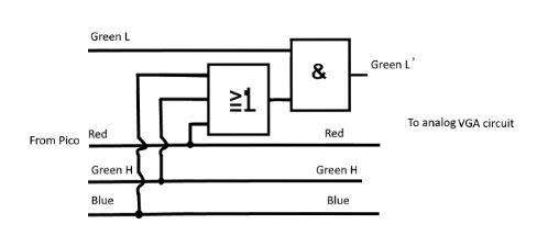

I could also do something like using an OR Gate for Red,GreenHigh,Blue and connect the Output together with GreenLow to an AND Gate, so that the Output (New GreenLow) is always 0 if non of the other ColorBits are 1.
Compared to your approach, you only lose one color (Dark Green) and not 8
nice but with both ideas, you'll lose the Compatibility.
It would only look good on your Pico. Thus, the program would be not, or limited usable for all others.

Please note that the dot clock (pixel clock) is 25MHz(40ns). You need fast logic to do this (with gate delay of 10ns, 2 gates = 20ns, you loose half the pixel). Or you "delay" the other 3 color signals by the same amount (3 x 2 gates), and potentially Hsync (1 x 2 gates). Vsync may not be that critical.
