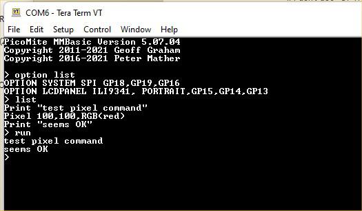

Forget the rest of the program. Isolate what's happening with your display first. Write a very simple program to put some text on the screen:
TEXT 10,10,"TEST"
If you don't understand that then READ THE MANUAL. Don't assume anything.
Play with the values. Add the extra options. See how they work.
Once that works you can start to consider parts of your program, but if it doesn't work you *have* to fix it before you do anything else. There's no point in continuing if you can't access the screen.
The only options you need to set up to start with are for system SPI and the display (entered *once* at the command line). If you need to change the display you have to use OPTION LCDPANEL DISABLE before you can enter new values.
Once you can write to the screen you can set up Touch, if you are going to want it. Once again, get it working properly before adding any more code whatsoever.
Always work like this. Test small bits of your program so that you know they work before integrating them into the whole. Trying to run the whole thing from ground zero is pointless - and you'll get a very sore head from banging it against the wall in frustration! It's useful to write the bits as SUBs and FUNCTIONs. You can test the complete blocks then.

TEXT 10,10,"TEST" works in teraterm ie prints TEST on lcd
Pixel 10,10,rgb(white) works
cls works
box 10,10,30,30,2,rgb(blue),rgb(red) works
if I try
cls
using mmedit I get
> RUN
[1] CLS
Error : Display not configured
so mmedit is not working? set to picomite. stick to teraterm?
Posted: 08:49pm 06 Aug 2022
If you are connected to the serial port in Teraterm, you may not be able to access it from MMEdit. Try closing Teraterm before trying MMEdit.
From what TassyJim had said earlier, you had been accessing his online MMBasic device. Could you still be connected to that?
Edited 2022-08-07 06:52 by lizby
Posted: 09:01pm 06 Aug 2022
Yes.
He trying to use my test "micromite without any display"
Different device, different configuration.
"Just because you have a black cat it doesn't mean all cats are black!"

stanleyella
Joined: 25/06/2022
Posts: 2807
Posted: 12:03am 07 Aug 2022
I noticed chat- vegipete in mmedit but not a clue. I spent a while typing code into teraterm and F1 to save but where it went ? can't get it back, teraterm is imho terrible to use. I can't use it for writing a program. Could I use notepad++ or geany as an editor cos mmedit is not working?
I have a feeling it doesn't work with rpi 2040 as a system. Attempts at pasting code to teraterm result in duplicates and missing code, it's terrible to use.
It's annoying that I can't see why my code doesn't work and nobody can point out why.
Is it that rpi pico and mmbasic is buggy? It's not a "mite" yet.
If I could use an editor in win and save/run the files to the rpi pico via teraterm if that's the way. no way I could live with teraterm for coding.

Posted: 12:51am 07 Aug 2022
  stanleyella said  teraterm is imho terrible to use. I can't use it for writing a program. Could I use notepad++ or geany as an editor cos mmedit is not working?
It's not that MMEdit is not working, it's that it's not connected to your PicoMite but to TassyJim's online MMBasic device which doesn't have an LCD.
TeraTerm is a terminal, not an editor. You could use it to type into the MMBasic editor, but has has been said previously, it's best used with an editor such as Notepad++ or Geany. Then you copy your code, press F10 (Autosave) in Teraterm and paste in your code and terminate it with Ctrl+z. Then you can RUN or EDIT. Or if you have and SD card working, SAVE it.
  Quote  I have a feeling it doesn't work with rpi 2040 as a system.
You're as wrong as can be. You haven't learned how to use it yet. (Though I myself prefer Notepad++ and TeraTerm).
  Quote  Attempts at pasting code to teraterm result in duplicates and missing code, it's terrible to use.
You're not doing it in the way that has been suggested.
  Quote  It's annoying that I can't see why my code doesn't work and nobody can point out why.
Everyone posting here has been telling you why what you are doing isn't working for you. You don't appear to either read the manual or what people have posted.
  Quote  Is it that rpi pico and mmbasic is buggy? It's not a "mite" yet.
It's not that MMBasic on the Pico is buggy. One of the most important things for a programmer to learn is that if something goes wrong and you can't figure out why, it's probably an error on your part. For beginners, it's probably ten thousand to one that it's the programmer's fault. Maybe if you're quite experienced it's down to one thousand to one (speaking of a programming language which is pretty well developed).
  Quote  If I could use an editor in win and save/run the files to the rpi pico via teraterm if that's the way. no way I could live with teraterm for coding.
You can do that as explained above and as previously explained. I don't even know what you mean when you speak of "teraterm for coding".
Posted: 04:10am 07 Aug 2022
One last try.
The best feature of the maximie family is the built-in editor. It is rare to be ably to program on the device.
But if you prefer to edit on the PC:
Make sure Teraterm is not running.
In MMEdit menu
Select 'Connect - New'
In the pop up window, select 'serial port'
'find port'
a list of currently available com ports will appear.
select your picomite (which was com13 at one stage)
select a baud rate in the right hand pull-down box.
115200 is a good choice but it doesn't matter for the picomite.
Click on OK
Click on save
Your window title bar should now show the com port and baud rate.
On the advanced menu, make sure a tick is beside "auto run on load"
Now if you press the right hand button (run and go) and you have done every thing right,
You program will be uploaded to the picomite and run after loading.
Now the bad news.
MMEdit will open a terminal for you to use
It's a crap terminal but you don't seem interested on using MMEdit V5 which has a much better terminal. Still not as good as Teraterm.
You can't get away from terminals.
