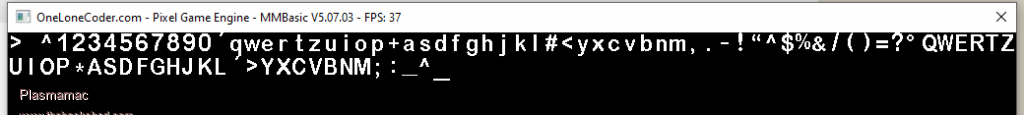

Posts: 226
Posted: 06:26pm 31 Jan 2022
Hello,
in pa9 and DE keyboard, I cant type a question mark "?", and no "<" and ">". There is no "\" i.e. for integer division and path assignments  in option default path C:\...
"+" is "'" and "#" is "^" and "-" is "#" and no "[" and "]"
>option list
OPTION Default mode 9 1024x768
OPTION Default Font 1,1
OPTION Default path C:\andreas\Meine Dokumente\
OPTION Colourcode OFF
OPTION Keyboard DE
Current display 64,128
-andreas

Joined: 07/12/2020
Posts: 226
Posted: 06:51pm 31 Jan 2022
@twofingers  I thought I did it already? There was a picture containig a "wanted" and a "currently" code generated with pa3.
wanted has meant the code it should be in german and "currently" was what Peters pa3 generated.
https://www.thebackshed.com/forum/ViewTopic.php?FID=16&TID=14518#181313#181284
-andreas

  andreas said  @twofingers  I thought I did it already? There was a picture containig a "wanted" and a "currently" code generated with pa3.
...-andreas
Yes, you did it! (I did not realize that. Sorry! )
I don't understand why your table is different from mine.
