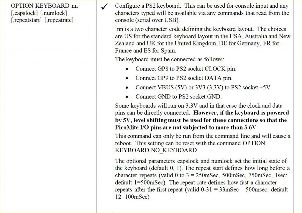

Would it be possible to add some options to the PS/2 Keyboard support?
OPTION KEYBOARD REPEAT firstchar, nextchar (like in CMM2)
and an option to disable the NUM lock at startup would be great, with TKL keyboards (Ten Key Less) enabling NUM Lock makes the Keyboard simulate the number pad on the normal keys
Alternatively, is there a way to bitbang commands to the keyboard?

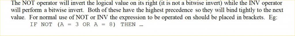

I just discovered that MMBasic has a different precedence for the NOT operator than GW-BASIC and VBA. In MMBasic the precedence of NOT is higher than the relational operators (e.g. <, >, =), but in most other BASICs it is lower. This makes it more difficult to translate BASIC programs to MMBasic. I understand that NOT is not bitwise and that INV is the corresponding bitwise operator, and that the relational operators gives 0 and 1, and not 0 and -1. At least I think it should be documented in the manual that the precedence of NOT is different from GW-BASIC and VBA. I noted that Applesoft BASIC in Javascript has the same precedence for NOT as MMBasic, but that seems to be a bug in the JS-version, since Applesoft BASIC Ref says different in section 2.
PicoMiteVGA MMBasic Version 5.07.03RC10
Copyright 2011-2021 Geoff Graham
Copyright 2016-2021 Peter Mather
> ?not 3<7
1
> ?not (3<7)
0
> ?not 3
0
> ?inv 3
-4
> ?(not 3)<7
1
> ?3<7
1
http://gwbasicprograms.blogspot.com/2012/01/operator-precedence-in-basic.html
https://docs.microsoft.com/en-us/office/vba/language/reference/user-interface-help/operator-precedence
Edited 2022-01-12 03:32 by mobluse
Maker Pi Pico Rev1.2, DuinoMite-Mini, Raspberry Pi 0-4, iCE40HX8K, Arduino Uno, VM111, STK500, ZX81
Posted: 06:06pm 11 Jan 2022
  Quote  Would it be possible to add some options to the PS/2 Keyboard support?
Next release - sorry about the pics some character in the text that the BB won't accept. The repeat rates are set in the PS2 keyboard H/W it is likely that some (cheap) keyboards may not implement them fully
  Quote  I just discovered that MMBasic has a different precedence for the NOT operator than GW-BASIC and VBA.
Clearly documented and the same in every version of MMBasic since day 1 2011. Same as C
Edited 2022-01-12 04:19 by matherp

OK, I didn't see that. I also noticed that one source about Applesoft BASIC was propably wrong since this manual says different in ch. 2 on p. 36. Applesoft seems to have the same precedence for NOT as MMBasic, but its AND and OR are not bitwise, and AND has higher precedence than OR, but in MMBasic AND and OR have the same precedence, which is unique.
http://cini.classiccmp.org/pdf/Apple/AppleSoft%20II%20Basic%20Programming%20Manual.PDF
> ?INV 3^2
16
> ?(INV 3)^2
16
> ?INV (3^2)
-10
According to the PicoMite User Manual p. 20 NOT and INV should have lower precedence than ^, but has higher.
Edited 2022-01-13 08:57 by mobluse

Change to OPTION KEYBOARD
OPTION KEYBOARD nn [,capslock] [,numlock] [repeatstart] [repeatrate]
The optional parameters capslock and numlock set the initial state of the keyboard (default 0, 1).
The repeatstart defines how  how long before a character repeats the first time (valid 0-3 = 250mSec, 500mSec, 750mSec, 1S: default 1=500mSec).
The repeat rate defines how fast a character repeats after the first repeat (valid 0-31 = 33mSec to 500mSec: default 12=100mSec).
