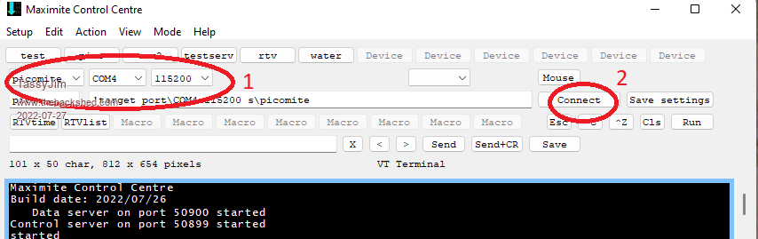

Step 1. select the device type (picomite and picomiteVGA are treated the same).
select com port and baud rate. If your picomite is using the on-board USB, the baud rate doesn't matter.
Step 2. Connect to your device.
Select File Manager from the Mode menu.
The first time it is run there is a very long wait. The PC side wants to read all the directory structure. It will remember the last path so shouldn't be an issue next start unless you had it pointing to a nonexistent folder.

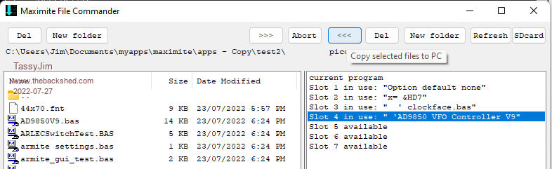

To transfer files, select one or more files then click on " >>>" to transfer to the 'mite and "<<<" to transfer from the mite.
The abort button lets you interrupt a file transfer.

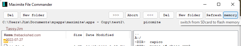

With the picomites, you can also select "Memory" to list the programs saved in flash. Click on SDcard to get back to SD storage.
When working with the flash, it is one file at a time. If you have multiple files selected, only the first will be transferred.
To copy a file to the picomite, it has to be loaded into program memory first before being saved to a flash slot.
This means that any existing program in current program memory is overwritten.
To transfer to a flash slot or current program, select the file on the PC and click on ">>>". You will be prompted to select the destination on the picomite.
You can overwrite an existing saved slot without any warning so think first!
Transferring from the picomite is direct from the flash to the PC. The current program is safe. Select the desired slot or current program and "<<<".
You will be prompted for a filename.
Transfers to and from the SDcard will use XMODEM while transfers to and from flash use AUTOSAVE and LIST

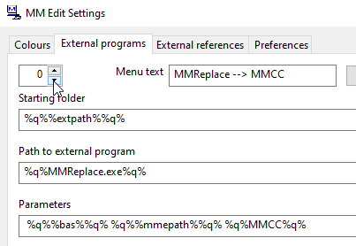

I think there is an issue when you view the external programs via File-->Preferences.
My entries shown below when entered directly into the mmedit5.inf file work as expected. If I view them via File-->Preferences they appear to be truncated and also seem to end up with two copies of the first action and the second one is gone if I arrow through the options.
One other thing would be nice, a recon i.e.(reconnect) option in MMCC (There is a discon option). The reason is, with multiple tabs you can play with multiple toys at once, but if you forget to disconnected MMCC will just use the connection it has already and not use the requested one.
On second thoughts, probably no need for the extra option if MMCC will drop the connection and connect again if you ask for a connection that is different.
Gerry

Posted: 07:49am 27 Jul 2022
Try this one (64 bit only)
I made the text box bigger.
MMEdit.zip
I will update the other versions later.

Posted: 10:29am 27 Jul 2022
Hi Jim,
The full line is now visible, however you can still get Ext0 entry to overwrite the Ext1 entry and you get a duplicate and one missing.
Ext0 = MMReplace --> MMCC|%q%%extpath%%q%|%q%MMReplace.exe%q% | %q%%bas%%q% %q%%mmepath%%q% %q%MMCC%q%
Ext1 = MMReplace --> MMCC|%q%%extpath%%q%|%q%MMReplace.exe%q% | %q%%bas%%q% %q%%mmepath%%q% %q%MMCC%q%
This happens if you press the down scroll when you are already at the 0 entry.
Just need to disable the down scroll when at 0 should fix it.
I can fixit and save it via the GUI so all seems OK if you dont try to scroll the wrong way when at 0.
Gerry
F4 H7FotSF4xGT
Posted: 11:45am 27 Jul 2022
OK Thanks.
I will look into it.
Posted: 12:42am 28 Jul 2022
Try again.
MMEdit.zip
The section of code dealing with preferences needs a revisit. It's a bit of a mess.
