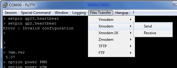

  thwill said   I have the usual problem with incomplete text being pasted from the Pi into the terminal, is this due to this "line-delay" feature that Putty apparently doesn't have ?
download "extra PuTTY" which has various transfer protocols built in. Then use F11 on the 'mite (XMODEM SAVE) and send the file of your choice - my dev tool chain

  CaptainBoing said  download "extra PuTTY" which has various transfer protocols built in.
Thanks Captain, but it looks like ExtraPuTTY is a Windows only deal. Guess I will have to get to grips with the Linux command line xmodem tool ('sx', I think) or use minicom (God help me) or GFXterm.

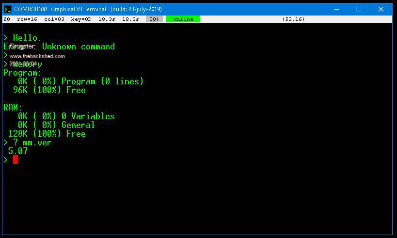

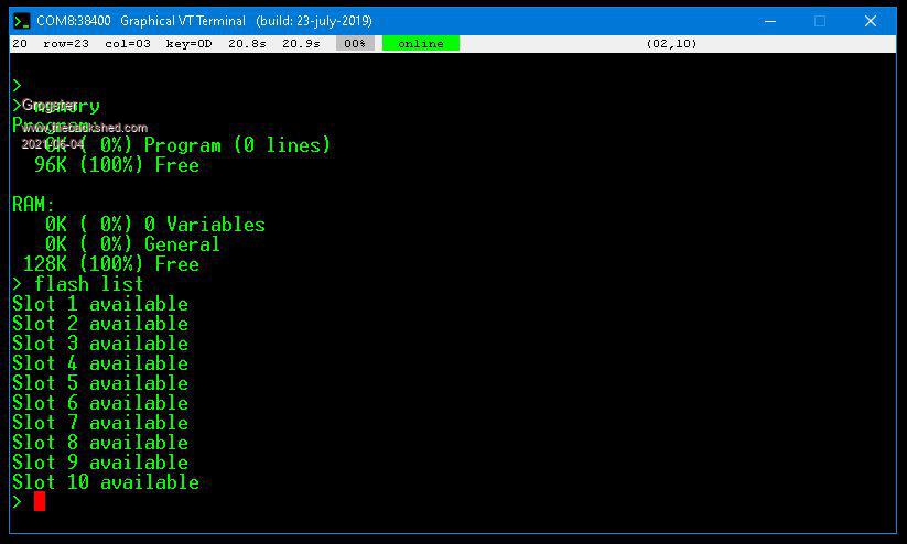

@ Rob and all:  GFXterm connects to the PICOmite just fine, if you press ALT-1 after connecting to the serial port.
@ lizby: I have my PICOmite running through a hub.  I unplugged the hub, and plugged it back in again, and the PICOmite rebooted fine.  Perhaps different hubs are different?  I also tried plugging directly into the PC bypassing the hub, and my PICOmite reboots fine.  Strange, the issues you and Volhout are/were having with the first module.  Could the first module have suffered a static discharge/damage by any chance?

@ Grogster.
          I can connect with TeraTerm OK but I tried the Alt-1 trick with GFX term and I dont get an error message anymore, it connects but I can't talk to it.
What is the exact procedure. I opened GFXterm then connected the USB then did Alt-1 then connect is that what you are doing.
Posts: 10114
Posted: 01:30am 04 Jun 2021
Hi, yes pretty much what I am doing.
1) Crank up GFXterm with PICOmite connected to USB.
2) Right-click, select CONNECT.
3) Select COM port(COM9 in my case)
4) Back at terminal window now, press and HOLD the left-ALT button, then press the ONE(!) button.
5) Release both ALT and ONE buttons.
6) Press ENTER - I get the > prompt, and from there, I can issue the usual commands.
Edited 2021-06-04 11:38 by Grogster
palcal
Joined: 12/10/2011
Posts: 2056
Posted: 02:31am 04 Jun 2021
Thanks Grogster works OK now.
