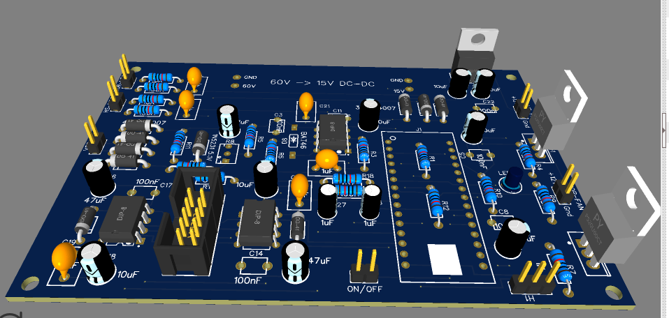

Power board is completed.
It is compatible with the nanoverter and the soon to come picoverter
and Madness's control board.
In other words it uses the 10 pin IDC connector we have used for years.
(It even is compatible with Powerjack LF inverters too)
Make sure you specify 2oz copper.
I like and use all the time EasyEDA.
The gerber files:
Gerber_PCB_madboard 24.5mm v4.zip
and this is what it looks like:
PCB_PCB_madboard 24.5mm v4_2021-05-16-1.pdf
I fixed a few things:
TIP35C
the high side TIP41/42 were swapped.
The 18V zener was wrong.
And the base pins for all 4 totem poles now have 10K pull down to keep then
shut-the-hell-off during boot.
Have fun and build a few and blow them up and sh!t..

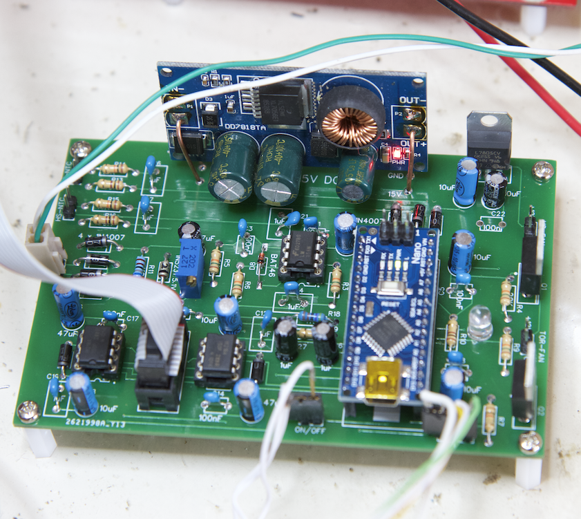

latest code for nanoverter.
two nanos need two firmwares.
nano1 does the heavy lifting, that is, run the inverter.
This code has not changed for a long time.
nano2 code oversees things and shows stuff on the LCD.
I have many variations of nano2 code that is for I2C LCD, serial LCD,
a AC curent sensor (that needs a simple hack on the nanoverter board)
and others.
so, nano1 code is
nano_1_v7_no_bessel.ino.zip
This works very well with the standard nanoverter build with the opamp based Vfb low pass filter. I use this code in my home inverter and its running this code for years now.
nano2 code.

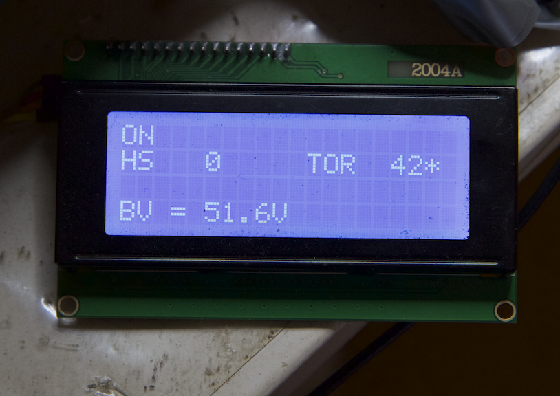

I have found that I2C interface to the LCD is very susceptible to interference.
Once I changed over to serial - 9600 baud - LCD things got very stable.
Sometimes even then I needed a inline ferrite choke on the 3 wires.
The LCD is useful for me only to show if the inverter is running and what voltage in input and output. Maybe also to show if a fan is commanded to run.
Serial LCD code:
2 flavours, one with a nano driving the LCD directly, the other driving an I2C equipped LCD.
Since I had a few of both types, I made two versions.
This code is for the third nano, which is connected to the LCD. IT then is
connected to ground, 5V and A4 via the I2C 4 pin connector. This is the first 3 pins.
The 4th pin is not used with the serial port code.
for direct connection to LCD with 4 bit wide data, RS and Enable pins..
nano_serial_to_parallel_LCD_2.ino.zip
and when using I2C type LCDs
(note: your LCD might have a different I2C address than what is programmed
in the code. So you must change it to suit if needed)
nano_serial_to_i2c_LCD.ino.zip
PM me with any issues with loading and running these firmwares.
It's not very hard once you do it a few times.
Important:
note well which is nano1 and which is nano2 on the nanoverter board.
confusing the two is not fun.
Over the past year or so I have added a few extra things to the nano2 code.
The latest code is something like:
nano2_5_ac_current_sensor_continuous_on_off_control_softserial.ino.zip
This uses the serial LCD.
It has a timeout for low voltage cutout, I use 5 minutes. This means DC voltage
has to be below LV cutout for 5 minutes continuously for the LV cutoff to trigger.
It has the usual fan start, stop and inverter stop for heatsink and toroid over temp.
This is the code I use to run the home inverter.
The LV timeout is important, when a fridge switches on, DC voltage will momentarily
drop rather low while the motor starts up. But then then battery voltage will return to something like "OK". I did not want the inverter to stop just because a fridge started. I want it stop when the battery really is lower than the limit when running
under a smaller load that is what it delivers for hours on end.

powerboard PCB files
Finally I need to upload this for anyone who is interested.
The BOM is to be worked out by looking at the board. All parts are labelled
in the top silkscreen. Except a couple, the 1N4148 gate diodes are not marked.
These are D18,D17,d16 etc.
I forget if any others are missing.
Use HY4008 FETs. Buy more than enough to build 2 boards. You may well need the spares
when the board blows.
The 5 x 10uF 25V can be something larger if you like, maybe 47uf
I used 25V 100uf caps. It ran well.
My builds using these boards only used 4 x 4 Fets for the home inverter
and 4 x 3 FETs for the test inverter. I see no need to build the full 4 x 6 FETs
unless you expect heavy duty service. 6kW + for hours on end. This is a lot of battery and most people may not have this DC power available.
48V DC for best results. I do not support 24V or 12V builds. You will be on your
own if you go there.
it looks like this
http://www.thebackshed.com/forum/ViewTopic.php?TID=13650&P=2#167180
11kW peak power with 4 x 3 HY4008 FETs
http://www.thebackshed.com/forum/ViewTopic.php?FID=4&TID=9409&LastEntry=Y#166999#166980
pdf
PCB_PCB_madboard 24.5mm v4_2021-05-16.pdf
gerber zip file
jclpcb loads the above gerber zip file and give me a price
of $115 for 5 boards. You need to specify 2oz copper.
1.6mm board thickness is fine.
$115 for 5 boards, using DHL express delivery.
This is less than $25 a board.

time to play with the picoverter.
I just ordered 5 boards.
If all goes well I will probably use this to drive the home inverter from now on.
PCB_PCB_picoverter 6 w lcd_2021-05-16.pdf
The code will support:
LV cutoff, with timeout and optional restart
Heatsink fan on, off and inverter stop on over temp
Toroid fan on, off and inverter stop on over temp
Optional LCD support, at 9600 baud (actually 10,000 baud. Let's see
what I can get away with)
It needs only one nano. A far simpler control board.
It is compatible with the powerboards we all have, using the 10 pin IDC connector
derived from the PowerJack LF inverters. Best results will be when using
the totem-pole type powerboards.
This is just a prototype.
I plan to design another version of this board to support
much better gate drive design and PCB implimentation
and this will not use the IR2184(4) gate drive ICs.
This second part of the project is still in the design phase
and will need plenty of time yet.

The picoverter PCBs have arrived.
I built one and it works perfectly.
No errors on the PCB
Later I will upload a BOM and build and startup instructions.
The 12V AC feedback circuit draws 1.5mA at 10.3 V AC
with my feedback transformer.
the firmware:
pico_1.ino.zip
The PCB files have been posted earlier.
The firmware works properly, with the LV cutoff and restart and the two
over temp stop and fan controls. All good.
Even the LCD works. The serial data is sent at 10,000 baud, due to the
code that sends the data is within the 20kHz main interrupt loop.
I divide by 2 for the bit transmission so that means
10,000 baud and not 9,600 baud. The nano/LCD that is running my serial LCD code
works fine with this too fast data rate. There is some tolerance in baud speed
matching and so far no issues.
LCD looks like this:
A bare bones display, just the data we need and nothing else.
The two temperatures are in deg. C and the star means the fan is running.
Output voltage is not shown, I did not need it so I did not design it in.
The HS NTC is not connected so it shows zero.
The picoverter will be just as useful without an LCD.
The on-board LED shows if the inverter is running.
The LED on the Nano will blink fast when the inverter was stopped
due to over temp of either HS or toroid.
It will blink slow if it's stopped due to under voltage.
If it's OK, it wont blink at all.
I probably will not need the LCD myself but it's here anyway for those who want it.

Nicks:
the nanoverter feedback voltage is about 2.75V.
This is referenced to the nano's ADC voltage reference
and so for the picoverter I just built, it's 5.05V
When the inverter is running, the closed loop control will ensure
the feedback voltage is 2.75V or increase the output AC voltage
to try and get it there.
It's up to us to give it the 2.75V at our desired output AC voltage
by whatever means are needed.
The nanoverter & picoverter Vfb input circuit draws about 1.5mA
so some of the smallest PCB type transformers might not be able
to provide this current.
(you can see where I got the 2.75V from if you look in the nano1 or picoverter
code. somewhere I do a comparison of the feedback voltage sensed
on ADC pin A0 with 0.55   0.55 x 5V = 2.75V)

  poida said  picoverter BOM:
This will include both NTC thermistors, one attached
to the heat sink, one attached to the toroid,
and give over temp protection.
A DC-DC converter to give 15V.
I used this one from aliexpress
https://tinyurl.com/2uwe2bdf
and mount it vertically.
Whatever you choose needs to give 1Amp.
Arduino nano
IR2184 x2
LM358
LM7805
IC sockets for above 3 ICs and the nano
2 pin header 0.1" x6
1uf / 105 monolithic cap x6
0.1uf / 104 monolithic cap x6 (C22 is not needed)
10uf 25V electro  x10
1uf 25V electro x2
4.7uf 25V electro x1
1N4007 diode x7
1N5231 5.1V zener x1
BAT46 diode x1
FR107 fast diode x2
LED x1
Resistors:
15K x3
4K7 x2
10K x3
100R x3
6K8 x1
1K x3
51K x1
10K NTC thermistor x2
9V AC small power transformer, taken from a wall wart,
for AC voltage feedback.
The 9V transformer is appropriate with a 1K for R2
The two fans:
MOSFET, logic level gate voltage, IRFZ44 or similar  x2
2 pin header 0.1" x2
15K resistor x2
12V fans from the stack of junk, 0.4 Amp max
if using the LCD function:
3 pin header 0.1"
Build notes:
15V supply is used for the gate drive output.
The picoverter can drive both totem-pole type power boards
as well as Madness's 4kW direct drive power board.
Best results (i.e. a bullet proof inverter) are
with totem-pole gate drive type power boards.
R4 and R9 not important, use something >10K
IC orientation is to be carefully observed. I have inverted U1
compared with U2. Get it wrong and will cost you $6 for a new IR2184
Prior to connecting the picoverter to the power board,
move the trimpot all the way so that the wiper is
now zero Ohms with the cathode of D7 and the lower pin of R5.
This is the node where D7 and R11 are joined.
maybe use a trimpot with the vertical screw, I used what I had
in the box of spares.
In doing this, the AC voltage feedback will be at the maximum
and so the inverter will produce the smallest output voltage it can.
This is a safe way to start up the inverter when we have no idea
where to put the trimpot.
Later on, you can set the AC output voltage as required.
(should you not set the trimpot as above, there is a
high likelihood that the inverter will run to voltages
way over 240V, something like 280V, and draw a lot of current
due to the now well saturated toroid transformer. not good)
Edit the picoverter firmware to suit your needs.
Unedited code will work fine.
load the nano with the picoverter firmware.
The battery voltage sense resistor divider will be not
quite right and need calibration. The calibration value is
in the firmware and you change it thus:
load the special DC voltage calibration firmware into the nano.
Connect the picoverter, with this firmware loaded, to the power board.
connect to the serial monitor from the Arduino program.
It will print the measured DC voltage and the calibration value.
It will probably be a bit wrong.
At the top of the console, type the correct voltage.
It will then make a new calibration value and print
the voltage and the new cal value.
Eventually you will get it close enough. Note this calibration value.
Edit the picoverter firmware and replace the old DC cal. value with
this new one,
then load the firmware into the nano.
Now we are good to go with using the inverter.
We have set Vfb to a safe position and have correct DC voltage measurements.
bv cal firmware:
do not forget to set the serial monitor to 9600 baud
see below of post..
latest picoverter firmware, with smoother battery voltage display
pico_2_heavy_filter_bv.ino.zip
Current schematic, pcb pdf and gerber:
picoverter 30-5-2021.zip
bv cal firmware:
pico_bv_cal.ino.zip
1oz copper is fine for the picoverter board.
2oz is best for the power board.
copied from the 150V 45A MPPT - roll your own thread
