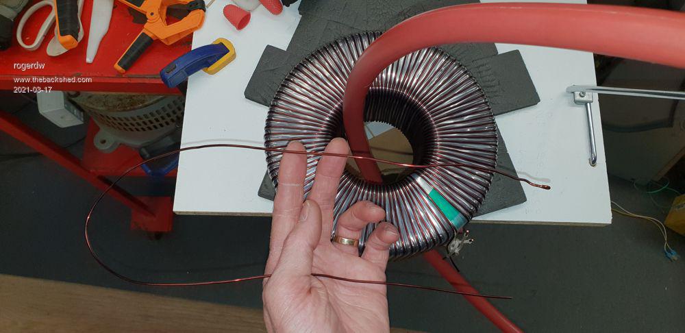

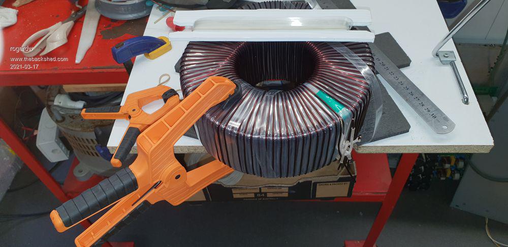

Posted: 03:15am 17 Mar 2021
Four layers of 92 turns on and three more to go.
Still a very slow process, but getting quicker as I get more practice.
Once again cutting it fine. 600mm left after winding two layers from my 52.5 meter length.
The mylar certainly adds to the overall volume as to get half overlap around the outside gives at least three layers thick around the inside  ...  so of course there's not as much room between turns for the next layer to settle partly down between the previous layer windings.
Hopefully there will be enough room for the secondary.    Still on track I think.
I was able to speed up my mylar winding when I realised I have a large spring clamp to hold the mylar so I can use two hands to wind out the next section.
It's a workout to use one handed, but saves a heap of time and frustration.
Cheers,  Roger
Posted: 05:20am 17 Mar 2021
There is absolutely no substitute for personal experience in this particular game.
The mylar is very thin, but its surprising how it can swell the total combined volume of the windings.

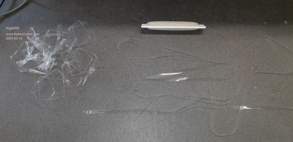

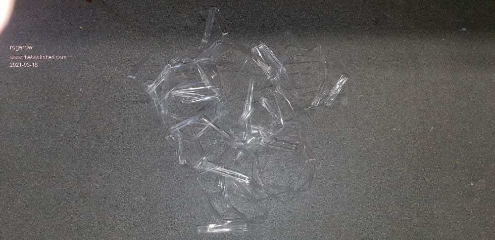

rogerdw
Joined: 22/10/2019
Posts: 957
Posted: 12:31am 18 Mar 2021
Anyone who's unwound an AeroSharp transformer knows what a mess the mylar ends up in and how hard it is to reuse in its crinckled state.
It works much better if you iron it but takes a long time to do  ...
Haha  ...  Not true!!!
If you clamp one end, hold it out with one hand and walk along waving a hot air gun over it  ...  it magically smooths out and looks almost like new.
Then it is really easy to roll up and handle for reuse.
It requires care that you don't overheat it or the edges curl  ...  but it is a quick and easy job to do and well worth it.
One headache is that it picks up lots of dust and rubbish via static  ...  so I find I also just pull it through a damp rag to wipe off all the rubbish before I wind it up  ...  and it then also feels nice and clean.
Otherwise you can see all sorts of dust and lint wrapped up with the new transformer and that just looks wrong.
Cheers,  Roger
