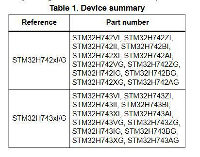

Am I correct in thinking that all the devices in the Bottom Right Panel are interchangable?
ie the same code should work on any of them in that specific family?
Edit: obviously excluding the number of pins
The reason I ask is because the CMM2 processor is the STM32H743IIT6 (400Mhz) and the STM32H743ZIT6U (480Mhz) are all listed under STM32H743x1/G

The CMM2 runs on the STM32H743IIT6 or STM32H753IIT6 nothing else. Both can be 400MHz or 480MHz depending on the rev level of the chip. The rev levels have the same part number so you cannot choose which you get although recent purchase are more likely to be 480MHz

  matherp said  The CMM2 runs on the STM32H743IIT6 or STM32H753IIT6 nothing else. Both can be 400MHz or 480MHz depending on the rev level of the chip. The rev levels have the same part number so you cannot choose which you get although recent purchase are more likely to be 480MHz
Thanks Peter, I (mistakenly) thought that parts in that section with the same number of pins from the same family would be interchangable

A quick guide to STM32 parts looks to be along the lines of:
STM32...abcd (i.e. consider the last 4 letters/digits)
a=[ROVZIABNX] means [64/90/100/144/176/180/208/216/240] pins/balls
b=[8BCEGI] [64/128/256/512K/1M/2M] flash
c=[TKHY] LQFP/UFBGA/TFBGA/WLCSP package
d=[678] temperature range e.g. -40 to [85/105]C
So the STM32H743IIT6 is a CPU with 176 pins, 2M flash, LQFP package, -40 to 85C temp range.  For lots more see its datasheet(s).
Generally, every different CPU is different to the software, i.e. features change pins / are not available / etc.
Potentially the software can be changed to cope with the variations but every change means extra coding & extra testing and the person doing the change probably needs to own the hardware and be prepared to power it up to do the testing.
