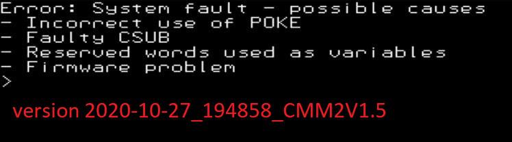

I seem to have found a bug in SELECT CASE or I am completely misreading the Manual.
However I try to use SELECT CASE in my program I get
This is the source code that produces the error:
' SELECT CASE Bug v5.05.06B15 and v5.05.06RC6 and EXP VERSION 2020-10-27_194858_CMM2V1.5
'Recommended Program Practice
OPTION EXPLICIT          ' Variables must be typed

  Quote  Not sure if this belongs in the v5.05.06RC5 thread or here.
This appears to be an MMbasic bug that is in all versions, at least on the CMM2. I've contacted Geoff about it.
In 5.05.05 the system just locks up and ctrl-C doesn't recover it. In 5.05.06 I've implemented a hardware watchdog so you get the watchdog timeout error.
The issue seems to be in the use of an array element in the select case. The workaround is to copy the array element to a simple variable for the select case
t$=M$(mR%)
  SELECT CASE t$
Edited 2020-10-28 01:22 by matherp

  matherp said  The issue seems to be in the use of an array element in the select case. The workaround is to copy the array element to a simple variable for the select case
t$=M$(mR%)
  SELECT CASE t$
