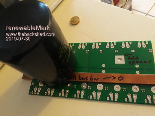

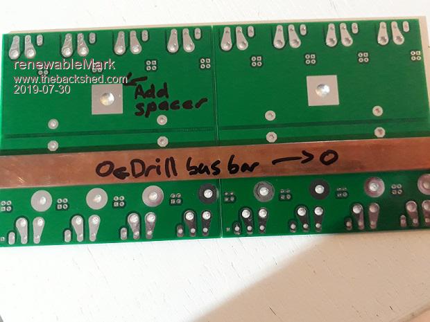

Thanks mate,
I was planning to solder it, so if an area 16mm or so left blank that would save me scratching it off.
Probably don't need to bolt it down, that amount of solder should give a good mount, but maybe a bolt hole at each side will prevent the surface lifting from the board.
Cheers Caveman Mark

All of this is no problem.
Have you thought about bolting the buss under the capacitor so when you bolt the capacitor on it also connects to the buss bar? The positive side cold also be bussed all just spaced out.

Posted: 09:56pm 29 Jul 2019
That's a ripper idea!!
WTF didn't I think of that
I could just use the boards I have now then.
Cheers Caveman Mark

Posted: 10:15pm 29 Jul 2019
What a simple fix.... ripper!
Just need to strip back the solder mask a bit.
Cheers Caveman Mark

Mark, it's not a "fix" it's a cleverly engineered feature
Posted: 12:07am 30 Jul 2019
The busbars will also greatly stiffen the whole circuit board assembly to carry the weight of the capacitors and tie everything together mechanically.
Its then possible to put together a really physically large inverter, using "thin" standard 1.6mm board material, and standard one ounce copper layers.
A further advantage is that it all comes apart very easily if ever anything needs to be replaced. Its difficult enough soldering really heavy parts in place, its a lot more difficult unsoldering things without making an unholy mess.
And it looks nice
