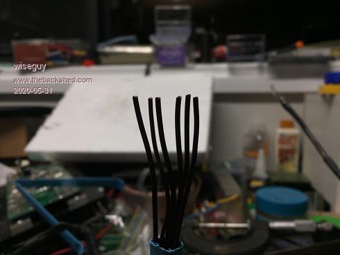

Normally I refer to primary as the magnetising exciting winding (240VAC) however from this point onwards I will refer to the 240V as the secondary and primary as the 48V inverter driving winding, even when feeding 240V into the TX for testing..

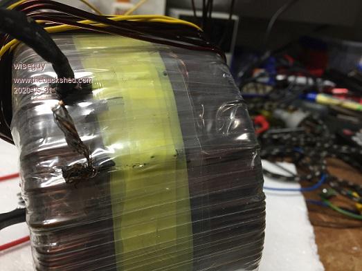

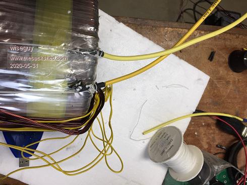

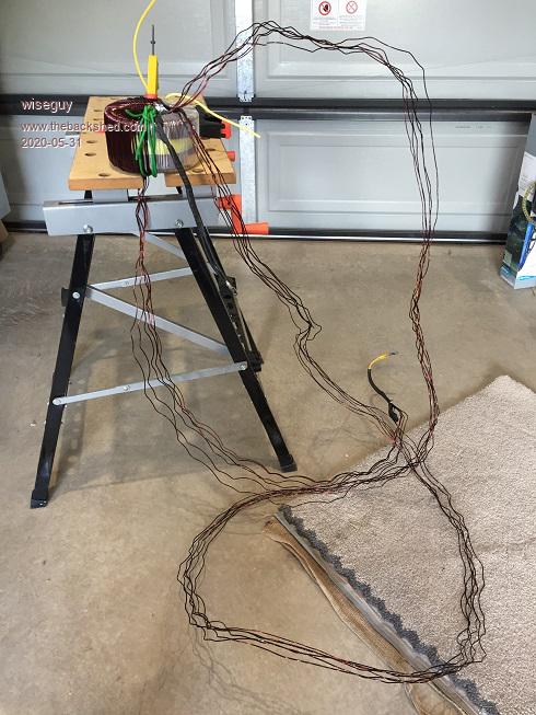

So I bit the bullet and set about fixing the dicky leads on one transformer and to lose some primary turns on both, to allow operation down to 44V.  This entailed unwinding a large part of the primary until I was able to effect a repair on the secondary stubs that had about 10mm of multistrand wire available & that had had some leads poorly connected & soldered - dressed up poorly by someone before I bought them.
Unwinding....UhOH

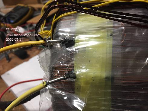

Just a few strands holding the 240V winding
Repaired with soldered bootlace ferrules
Fixed
Second from left is smaller diameter than others
Ready to rewind with guides

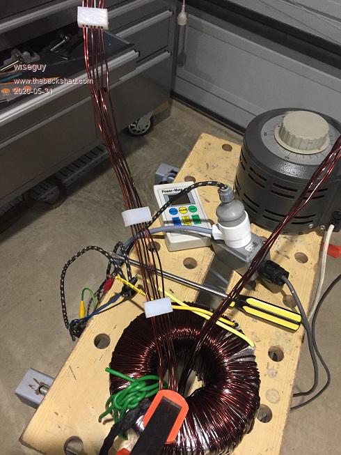

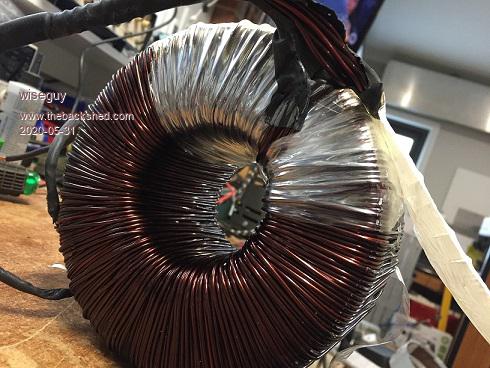

The actual voltage required for 44VDC to AC is 44 x 0.7071 = 31.118VAC.  So I needed to unwind/rewind back enough turns to reach the required ~31V.
The primaries were 6 in hand of 5 x ~1.85mm ands 1 x 1.65mm.  At about this point I attached a temporary 10 turn winding to determine the volts per turn. I was pretty surprised to find 7.74V with 240V on the primary.  That gave me 310 turns on the secondary and 40 turns, yielding 30.9677V required for the inverter drive winding.  Sure there is relatively low magnetising current, but these turns seem a lot more than the Aerosharp toroidals that were being wound by others here.  Most ended up with about 1V per turn, whilst mine is close to 0.774V per turn.
Unwinding the primary a long way was relatively easy going but I could sense that re-winding the 6 strands of 1.85mm wire at once was going to be a right bitch and it was easy to pick where my re-winding effort started - its a bit akin to refolding a large map - it usually never refolds back up looking the same as before you unfolded it.  I never counted the turns it was too difficult with their complicated scatter/overwind method so as I got close to the right number, I carefully applied mains and checked the primary voltage which was 25.7, 5.4V shy or another 7 turns required.
Having completed both units, next I joined the primaries together, ensured I had the secondary's phased correctly and applied 240V to one secondary, measuring from the other secondary was within 0.1V of 240V (much less than 1 turn)  ensuring parallel operation would be fine.

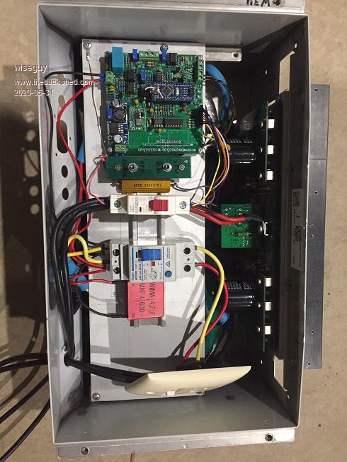

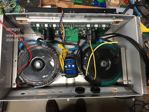

Next I mounted the 2 transformers into an old Aerosharp box, one at each end.
Then hacked the chassis to fit my inverter board/heatsink power stage and fitted a small aluminium panel to mount the nano and some DC & AC circuit breakers.  It did not feel quite right squeezing ~ 5-6kW of inverter into what they had previously allowed for ~ 1.6kW but it squeezed in.  Now lugging the box around, which is unbelievably heavy for its size, is a real task.
It worked first time, running off first one, then 3 x Elteks (~110A overall capability), I could easily start my compressor concurrently with a 2.4KW fan heater, idling along at about 80A input current.  At this stage I am uncomfortable with the 3 switches for pre-charge, turn main CB on then hit the run switch and then get it right in the reverse manner later to shut down.  My next investment will be one of those wonderful LEV2 solenoid/relays that can switch 900VDC and 500+ amps.

On Thursday I had a 20A 3 phase outlet wired into my workshop.  The next part will be to build a breakout box to 3 x 240V sockets (one to each phase) so I can run the 3 x Eltek 2kW rectifier/power supplies for an extended time at 4, 5 & 6 kW to check overall efficiency, heat build up etc.
The logistics of making this set-up power the house of an evening is somewhat problematic.  The genius electrician has shared power & lighting across the house using all 3 phases.  Yes my LED lighting is partitioned & running from all 3 phases.  Lets see now 50 LED lights at 10W ea = 500W so if they were divided equally ~ 160W per phase - what a waste of 3 x 10A circuit breakers, wiring and the brainpower for this solution, that if running from just 1 phase would still have a spare nearly 2kW of capacity.
So the easy (?) way to drive the house ATM is to connect L1 & L2 & L3 together (note to self, switch outlet to off first......), and together with the common neutral connect them to my inverter output, turn off the street connection, turn on the inverter and enable the outlet switch, voila one phase driving 3 in parallel all lights and power point work - there are no 3 phase motors or appliances in the house - the ONLY reason for the 3 phase connection was to allow me to feed up to 15kW back to the grid. Only allowed to feed 5kW per phase max.
Now the next good part, ensure the outlet is switched back off in the morning before the 10kW Fronius 3 phase inverter driven by the roof solar kicks in and complains about the L1,L2,L3 shorted output.
Yep this plan has knobs on it, I look forward to some suggestions from the many clever people here how to redesign my twisted thinking into a better way to do all this, preferably automatically.
In some ways it would be easier to be off grid totally but if I want to enjoy cool evenings in 35 degree summer evenings after dusk in the workshop and house there can be up to 7kW of A/C load before induction cooktops & oven & microwave are also considered. They could all suck the life from 3.6kWH in about 10-15 minutes flat.  I dont want to lose the grid, as it earns me money each quarter and it can run AC all night if it has to, but I do resent being given 18c per kwH for feeding energy back in the daytime to then paying 44c/kWH in the night for what I need to use from the grid.
If I am going to go off grid totally I would need some serious kWH capacity to keep my wife happy and in a similar manner to which she has become accustomed etc....
Last part - the energy geniuses are talking about turning off our solar grid feed inverters as they are producing too much energy during the day causing localised high grid voltages and network instability.  Why not change the timeclocks for the "off peak power" devices to be on peak power drains to help equalise by using the excess daytime energy, also the sun usually doesnt shine at night so it is a waste to then create energy to run all the off peak stuff. Seems to me they need to re think what and how to do this better to suit todays situation.
Edited 2020-05-31 02:02 by wiseguy
Cheers Mike
